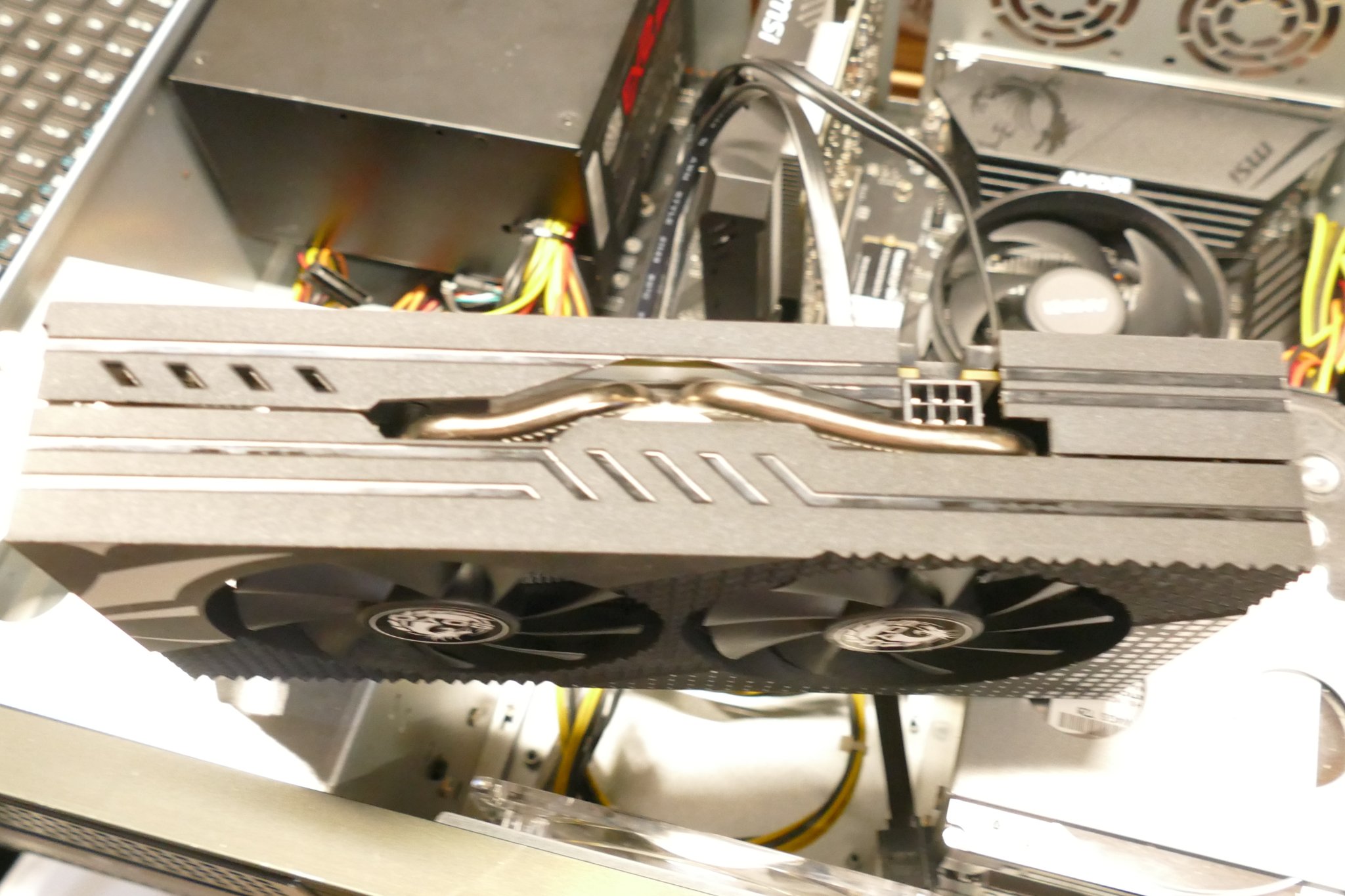

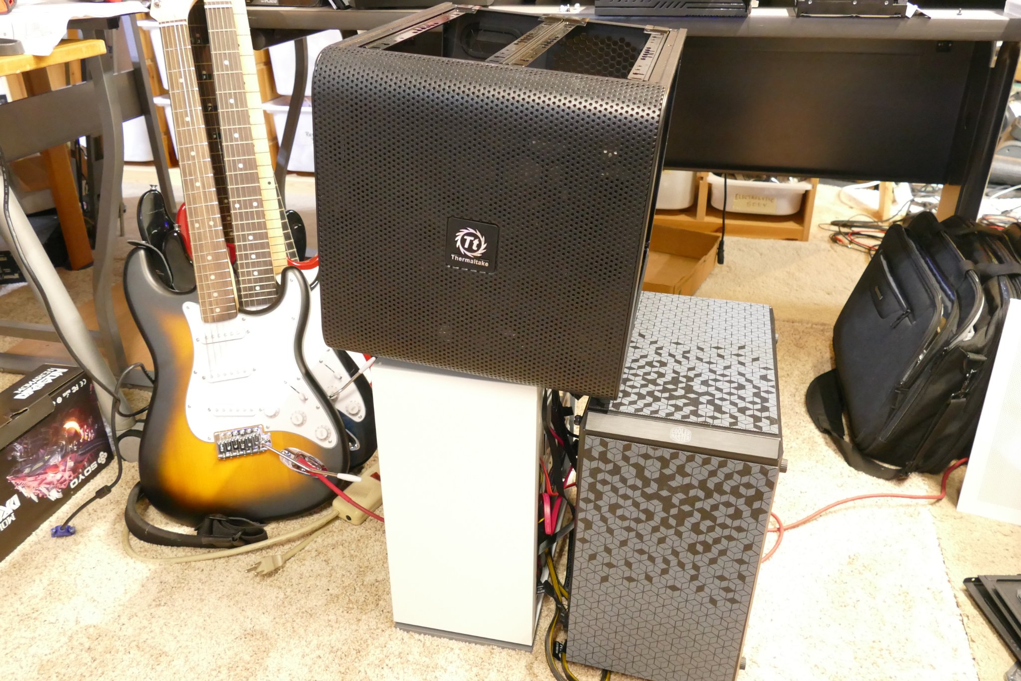

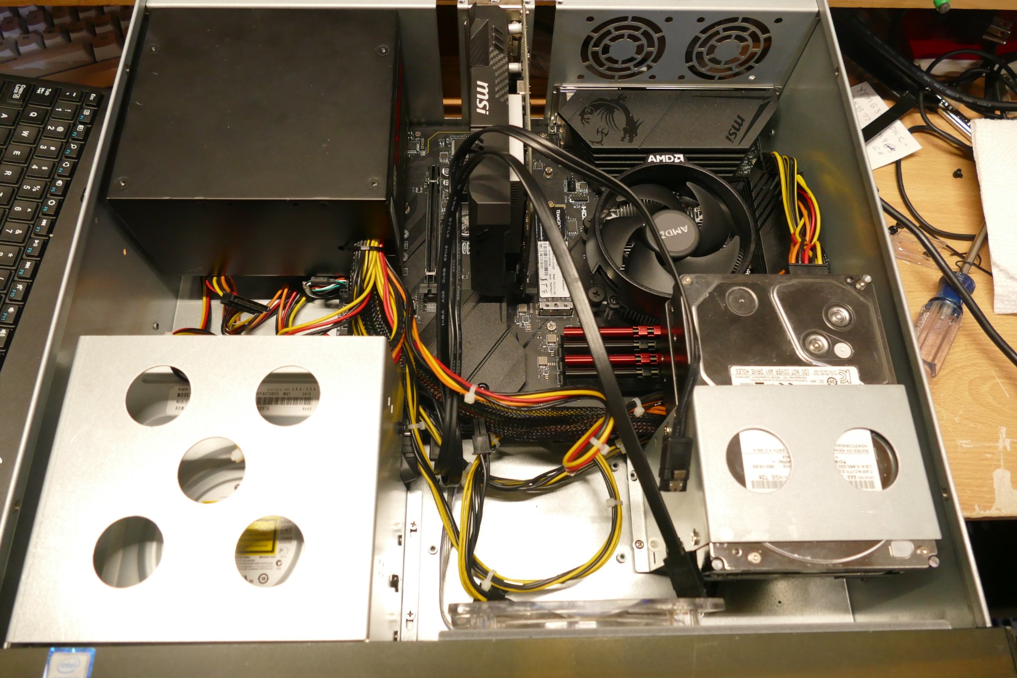

I had an old Ryzen 7 3800X chip that has been sitting on my desk for at least two years. I saw a $99 motherboard that supported that chip on Amazon, so I bought it without thoroughly reading all the specs. It's too big to fit in any of the conventional cases that I have, including that big Thermaltake Cube. The board measures 12 inches by 10 inches. The only thing I could stuff it in was a 10 year old rack mount case. I found a RX580 video card for under $100. It works good, way above the price point, but they put the 12 volt power connector on the top. That's fine until I had finished the machine and tried to put the top on. Now an old GTX 1050 sits in its place.
I usually install Windows 10 from a flash drive and let it eat updates for a few days, which includes the W11 upgrade for machines deemed "good enough" by Microsoft. Last night I decided to take a short cut, so I downloaded a W11 ISO from Microsoft and used it. During the install I noticed that the "Decline MS 365" was the greyed choice and Accept was the preselected choice. EVIL.
Note that I unplug the SATA connector from all hard drives except the drive where I want MS to install Windows. In this case it's a 1TB SSD attached to the motherboard. MS will sometimes choose the first drive it finds. Let the installer run its course until the machine boots, runs, and eats all the updates that MS throws at it before plugging the spinning drives back in. They will be recognized with no issues if they were already formatted. If not, you need to run "Disk Management" which I have not yet found in W11.
