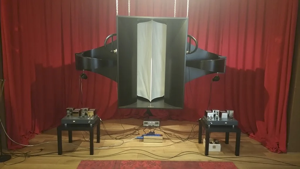

attachment.php
Aaahhhhh!!!!!:p
Well, you see a lot of funny shapes that make no sense in an acoustical way in the audiophile segment
Well there is certainly a noise floor of B.S. in the audiophile segment. But there is some inovation there as well.
With current knowledge and tools, it should not be hard for a high end speaker builder to design a low diffraction cabinet. What is challenging is designing a low diffraction cabinet that is also aeshetically pleasing. Some high end designs aim to be visually unobtrusive so they blend in to a variety of decor environments. Others are intended to be a work of art, visually striking. In either case, when someone is shelling out new-car money for a pair of speakers, it should be a given that the sonic performance is high. Most of the time it is, sadly sometimes it is not.
j.
btw, what is that thing in the photo you posted? I assume it plays music somehow... ?
