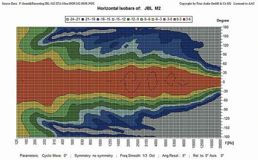

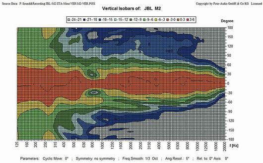

lastly, because the JBL M2 clone with OEM parts was waaaay too difficult to figure out a grand total I would be spending, with Crown amps needed and xover/processor box? It seemed it would be well over $5 grand though. this was my first choice.

Drivers can be swapped, a lot of times...maybe you'd copy Xover, baffle width, and horn/waveguide...maybe. People have said they preferred 4" diaphragm compression driver over the M2 driver...The jbl m2 woofer can be substituted with plenty of other drivers at more modest prices....then you'd get to keep the m2 waveguide in your system....
jbl 2216nd 1200/pair
jbl D2430k 720/pair
jbl m2 waveguide 520/pair
2440 total
400 dollars worth of wood n hardware?
1100 for a pair of Behringer NX6000D (amp and xover rolled into one)
grand total of 3940...is it a sign?.....lol
I'd be done already...not literally but figuratively...I also fancied the jbl m2 at the beginning of my design journey... I used it as a sort of benchmark along the way.
Good ol POS -
JBL Master Reference Monitor - Page 73
