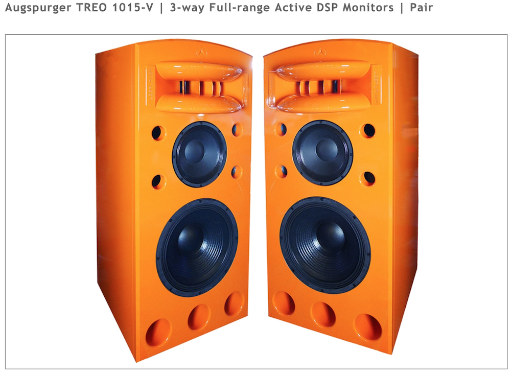

that some of the very best monitoring/mastering speaker systems use direct radiators for mid and high frequencies.
"the best" says who? Compared to what? Its only the best, because whats truly the best has been removed from comparison...at least thats my theory. Funny enough, my Axi on this 350hz horn has almost identical performance (CSD) to an ATC sm75-150s except for directivity and the Axi doubles as a tweeter, can play lower via large horn, etc, more dynamic ability, what have you.
at 24grand, with amp and dsp....this doesn't sound too crazy anymore.
Could probably build something like this for 4000 grand if I had the wood working skills, still better can be had via knowledge on this board.
