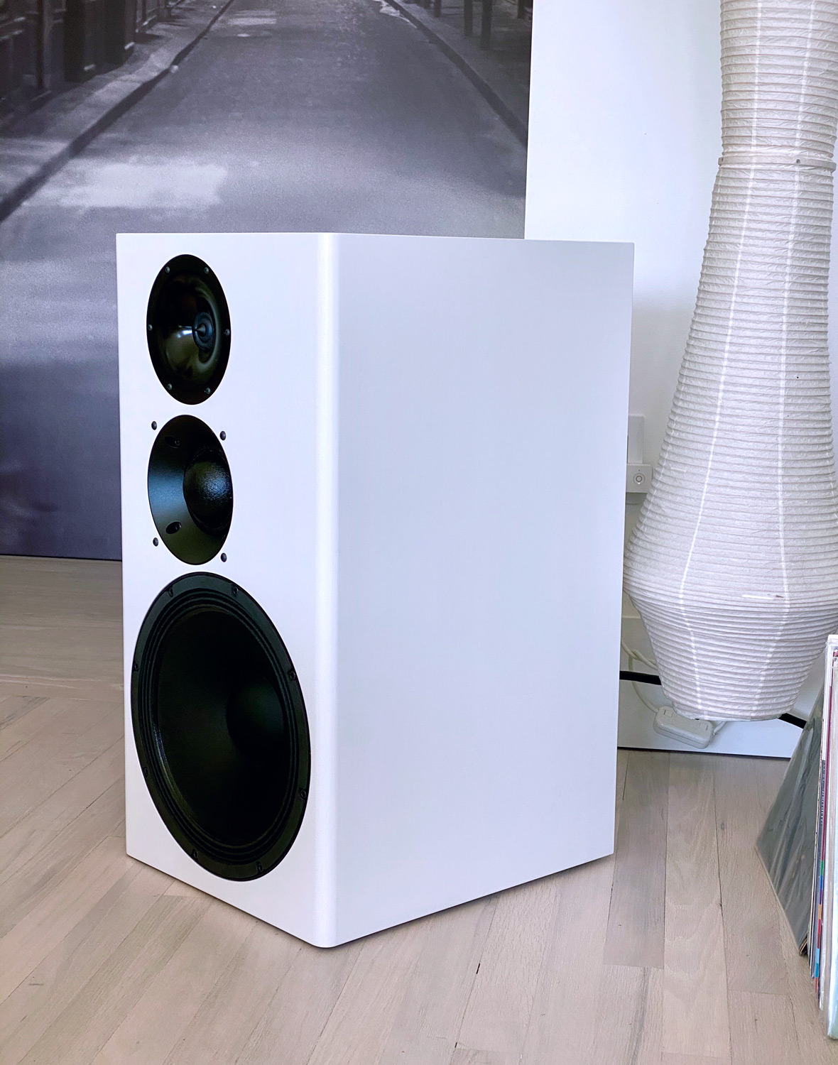

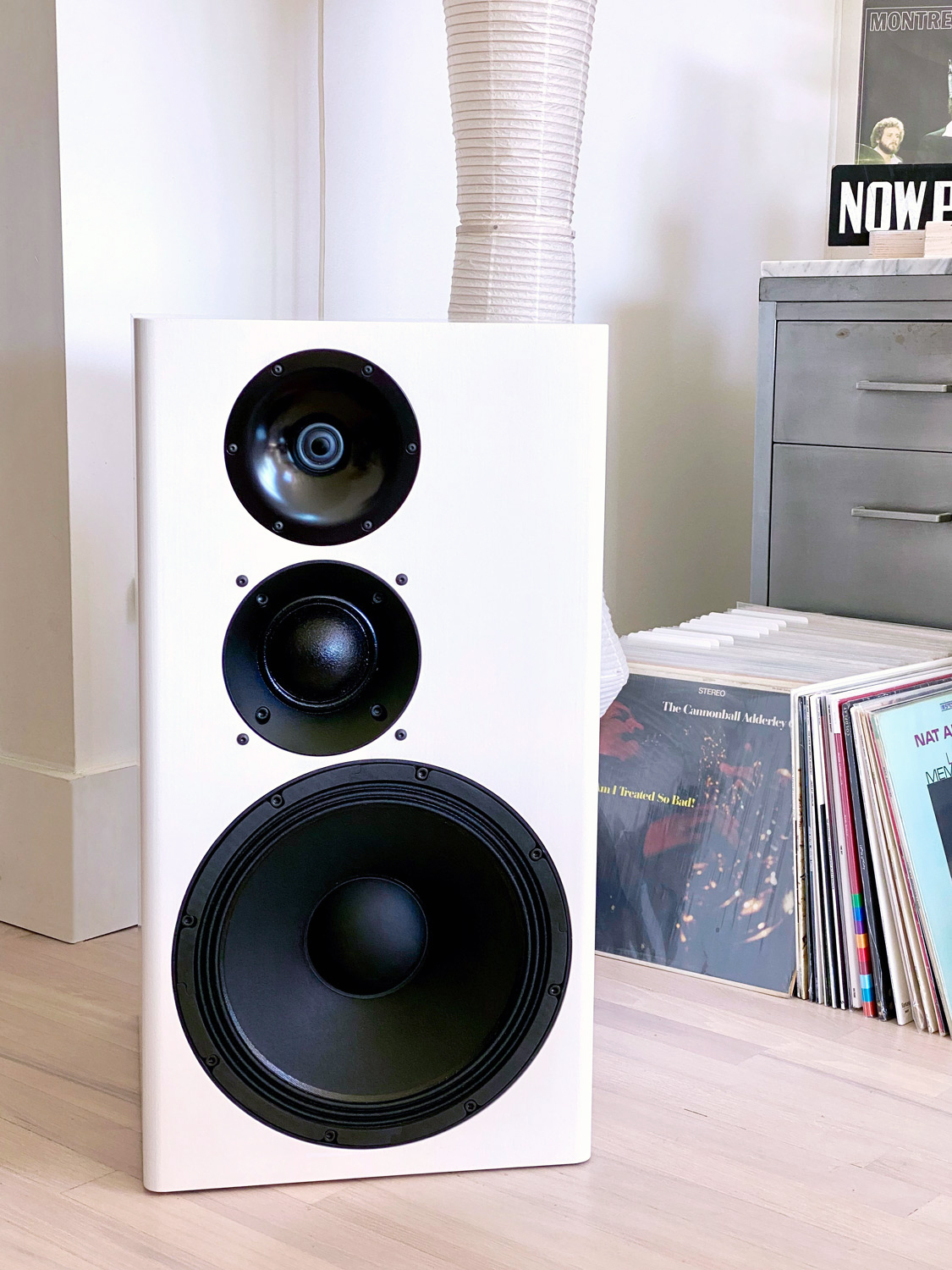

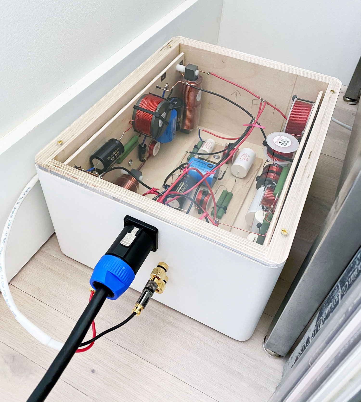

Much of this convo is way beyond my current knowledge—And I certainly don't need to sell anyone on anything... but regarding Matthias's OSMB (C!) project—I can't see a scenario where they wouldn't get loud enough for regular use—this comment regarding all the talk about efficiency/sensitivity. I have plugged many power amps and pre amp combos into them—as low as 8wpc—without question the music will get loud enough that one can't be in the room (12 x 24' with 16' ceiling peak) and still sounds fantastic outside the house (doors open). I can't see a reason for a more "sensitive" speaker—but I'm certain there's a lot I am missing. And—as I mentioned earlier—and I saw Matthias chime in on—They cost me well under $3k to build—but I have woodworking skills. Some images here—since this thread is light on the pictures. I also have limited positioning options given the room. My only regret about building my last speaker first 😀 is that I really want to build them again.

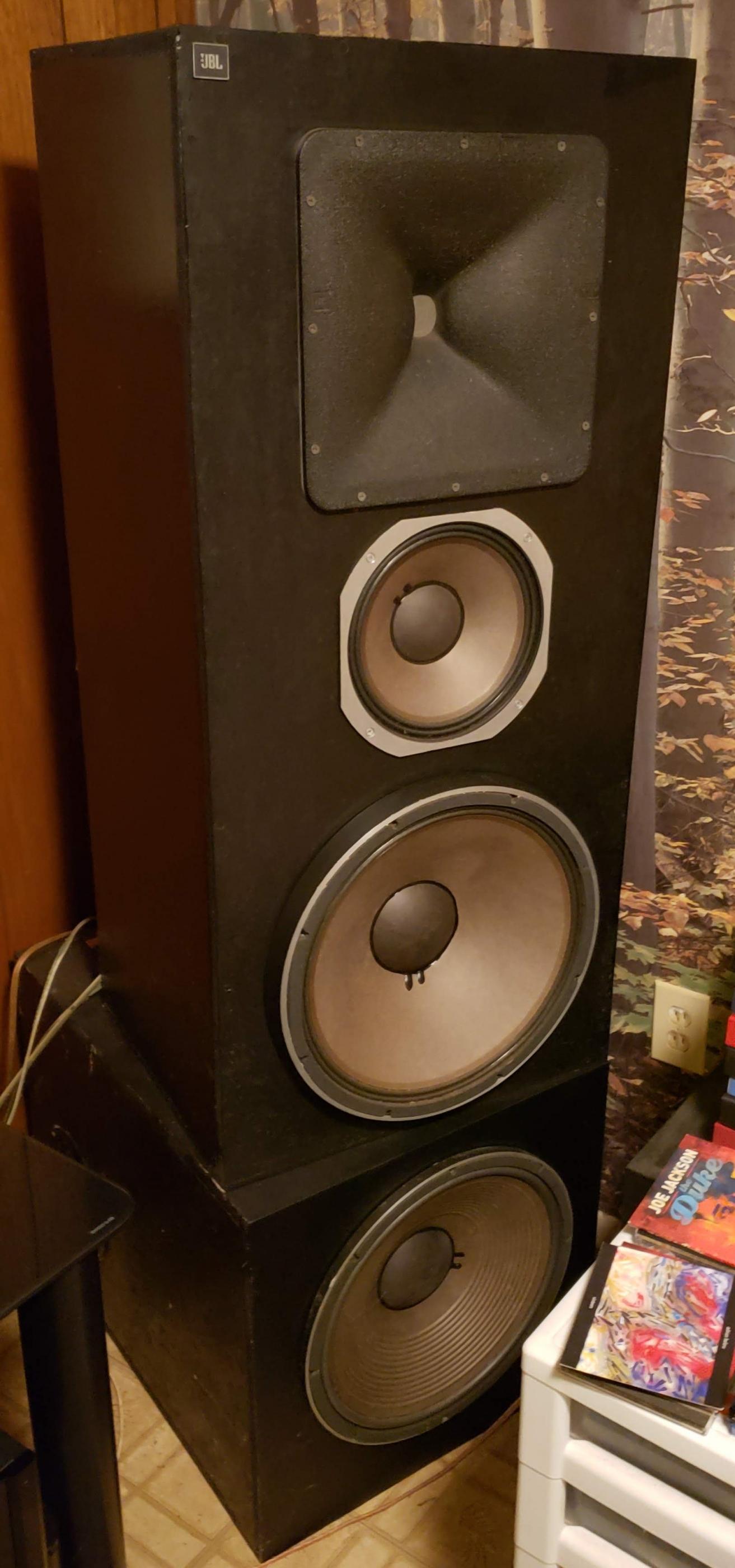

Hello Flaxxer
I built those over 20 years ago and except for an occasional driver update they have remained essentially the same concept. Here's a snap shot they are all JBL drivers an E-145 15" 2123 10" mid and 2453 CD on a PTH1010. Subs under.
This is an all analog active set-up with a passive CD horn compensation. You should have no issues using DSP and can correct for the horn CD curve with the DSP.
.5 cubic ft. sub-enclosure on the 10' 2123 crossed at 300 and 1.5K 24db L/R

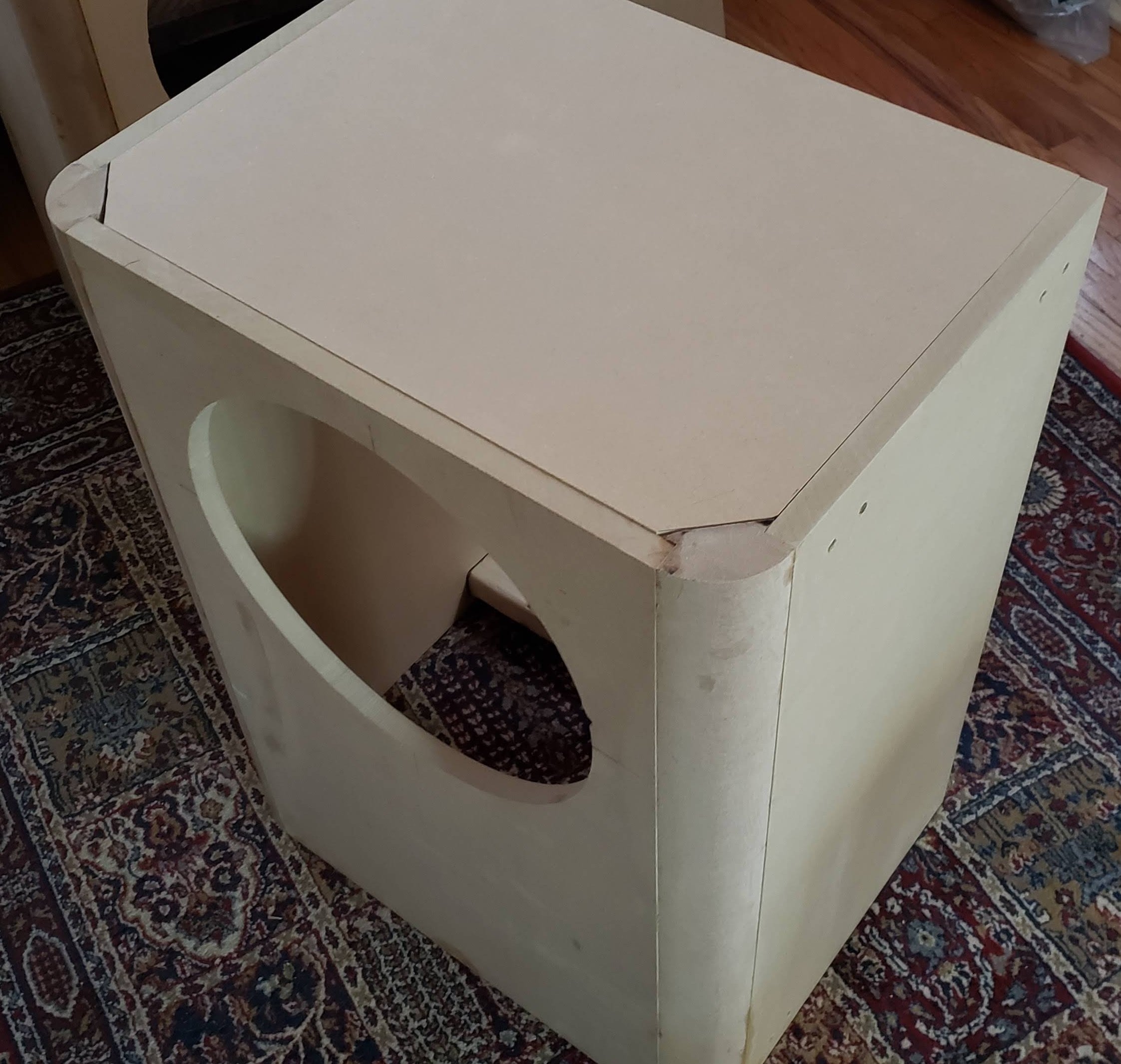

If I built them today I would use the corner rounds to help reduce diffraction. They are easy to use and make really stiff corners. They are made of MDF material so you can paint them or venire over them. They are set up match up to 3/4 panel thickness.

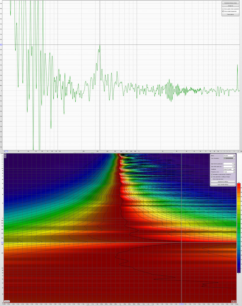

Camplo could you point to time to peak energy/ gd curves in your thread please i missed that.
Group delay chart on top
CSD on the bottom, dotted line charts the time to peak energy
This is from my horn combo at 1 meter. There is a group delay reading for the lower register but its not from a woofer so I'm not sure how you want to take it. My point is that the time to peak energy expression follows group delay...thus it needs to be respected non the less.
