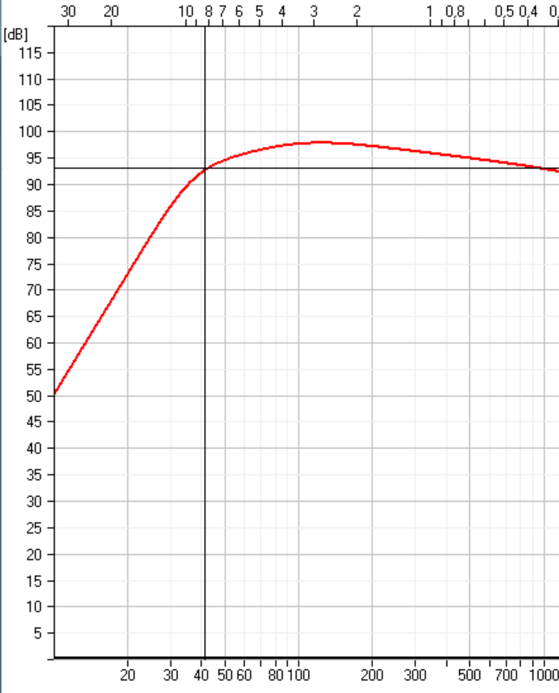

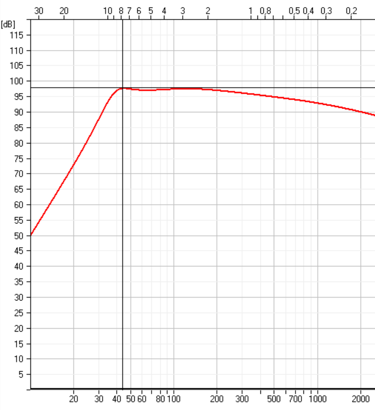

Please educate me. When completed speakers end up being 99 or 100db efficient, the drivers started out 108db basically. How do you get a woofer with that high sensitivity, to also play -3db at 40hz?
Well, it's simple. Take a JBL 2226H and put it in a 200 liter enclosure, port frequency at 40 Hz:
attachment.php
It does 98dB at 2.83V in half space (meaning it's mounted in the floor of a very large room or open space) at 40Hz.
Put it in a box of 100 liter and you lose about 5dB:
