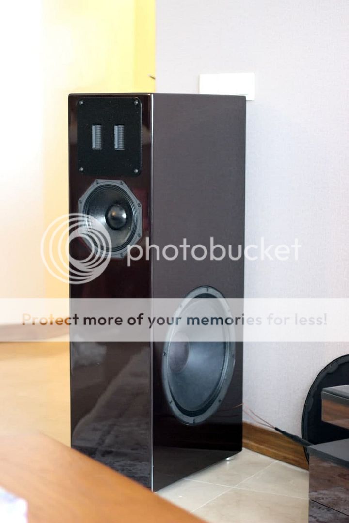

dave123's speakers are these ... He is working with me through PMs on the design.He has used horns, and the G1 ribbon with these same speakers, and has xover plans for them. I'm waiting to hear back from him about what he thought of all three examples.

The two tweeters side by side seem a bit awkward to me. What's the purpose for this?
Yes - if that was very good we would see it more often and on high performing brands. I smell diffraction and interference patterns. My guess is SPL...

As previously mentioned he is going with (or is that "leaning towards"?) a SINGLE Aurum Cantus G1 (..rather than the two AMT's shown).
I personally think the midbass driver choice isn't a great midrange driver, and will likely require a more steep low-pass filter to integrate properly with the G1. My guess is that this was done to push the output lower in freq. (because side-firing woofers with extended delay don't sound as good the higher in freq. that you go - usually best "blended" below 200 Hz). IF this is correct then you tend to "run-into" more floor-bounce "suck-out" as a result (and then it's a "battle" of moving the crossover point between the woofer and midbass until you get the response you are looking for at the listening position).

It’s normally a no-go with tweeters next to each other. The output will be focused in a narrover band, and result in a quite small listening window. Reflections to sidewall will be reduced though. This is normally not an issue, and not often seen. Reducing reflections from floor and ceiling is more common, but requires the tweeters to be over/under each other.

I bet the side by side tweeters would be good for people who have to place their speakers almost against their side walls. Unless it shrinks the soundstage.
Side by side will always shrink soundstage. Have you looked at troelsgravesen.dk he is a trusted builder.
I like it worded as - narrows the polar...consider ribbon tweeters already have a narrow polar towards the top end to begin with. Duplicate tweeters side by side would exacerbate this...just find a more powerful amt, why make bad choices in the name of efficiency when theres no need...

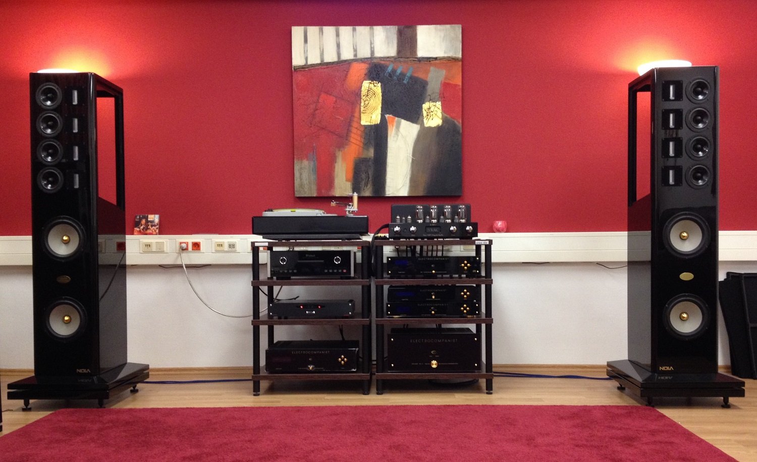

..not unlike a much larger version of the Nola loudspeakers seen below.
*though this portion depends on if you have sufficient space for the loudspeaker placement in-room.

An old friend of mine once co-designed this, back in the early nineties. A 15" Beyma in the bottom completed the array of mids and tweeters. Though off axis some comb filtering was present and the design of the crossover wasn't fancy, the advantage of the line source (reducing/spreading floor and ceiling bounce) and the rather wide baffle was clearly audible in normal listening rooms.
