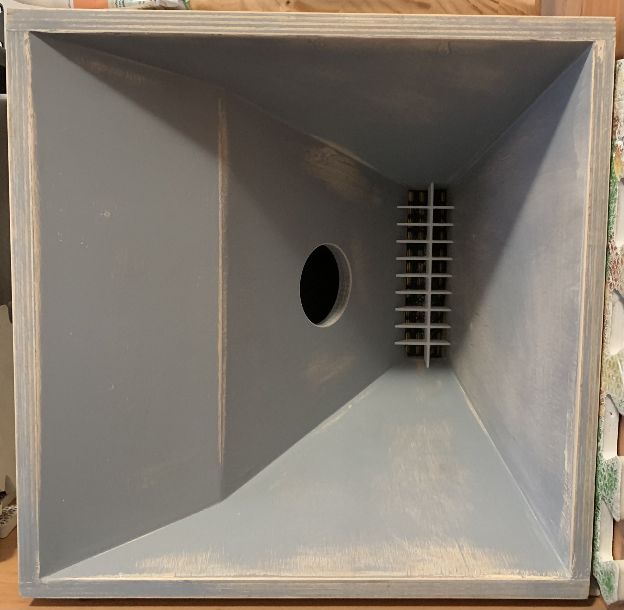

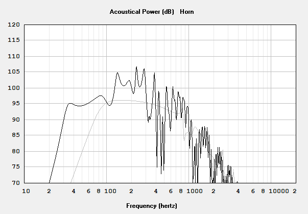

Just playing with the idea of building a tapped horn with the same Fane woofer (black line) and turning the horn into bass reflex instead of closed back (grey line). This looks like a pretty good match - and I always wanted to try out a tapped horn as well. Another project to the list...

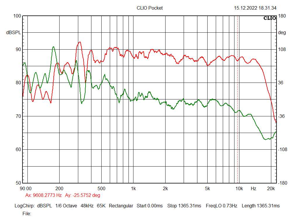

Trying out Clio pocket and some basic crossover. This is the on axis response (red) and phase (minimum selected in Clio, green) after some EQ. In room, 1/6 octave smoothed and no gating, in room at around 70 cm.
I definitely need to start building the second one:)

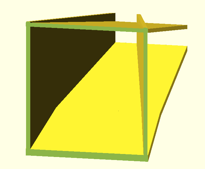

Measure once, print twice:) I realized that it is wrong before printing, but at least I managed to confirm this shape would fit. It is most probably a bad shape anyway. I plan to try the "micro waveguide" (on each hole) style as well.
I should still build the second one. And the first larger symmetrical prototype will be used as center for the LCR testing.

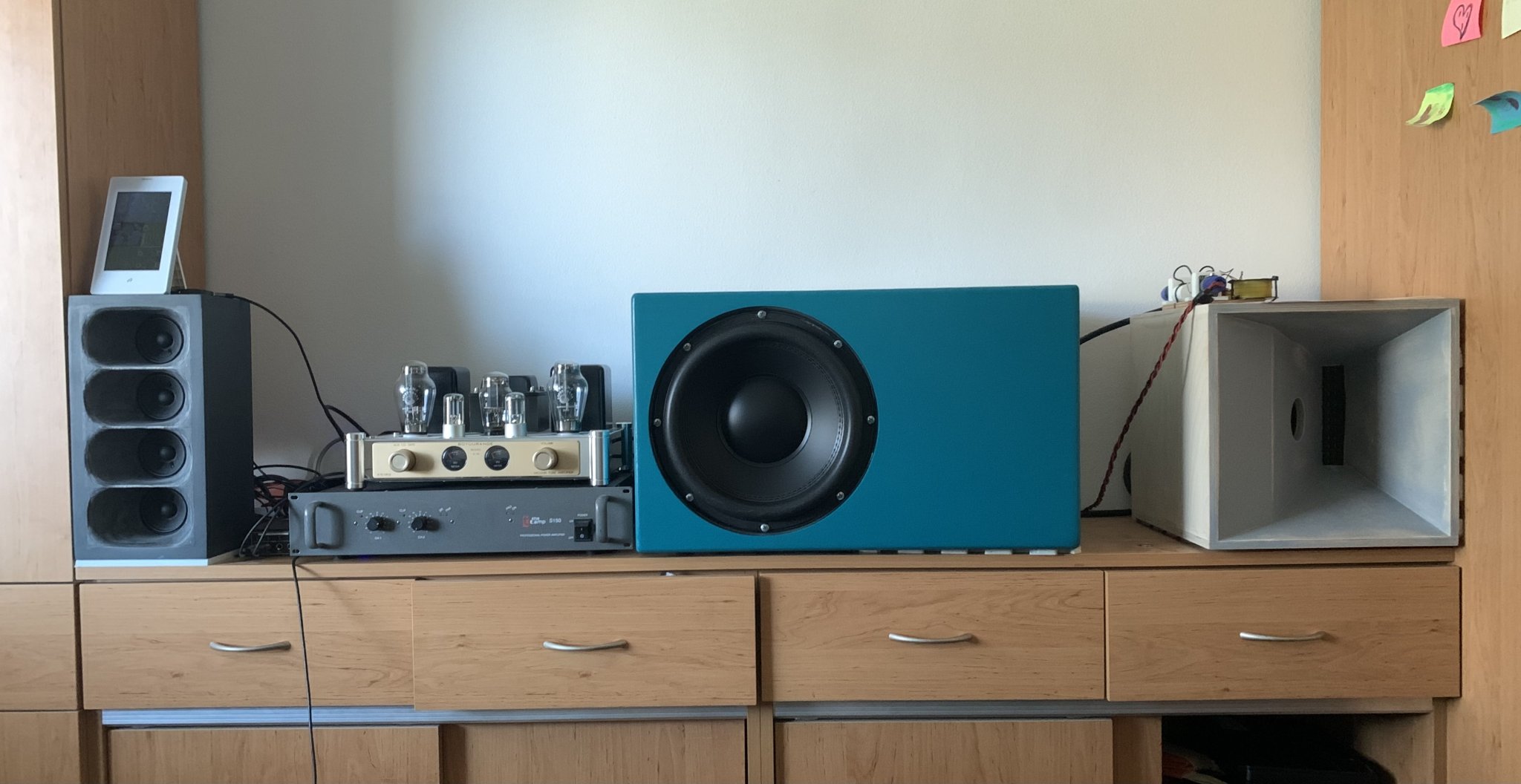

This is the current temporary setup. I have had too much of great local beer to realy tune this. So far so good, the only problematic thing is the slight comb filtering effect from the left side, to be solved with second MEH build.
