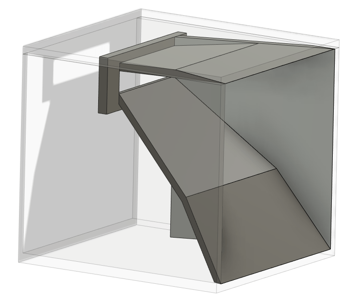

While slowly working on my other MEH projects, I just noticed the Ikea Kallax in front of myself and I just thought it would be cool to fit in a synergy horn there. The internal dimension of the kallax cell are 330 x 330 x 380 mm, so the speaker must fit into this volume including wires in the back. This is nothing new, it has been done before, e.g. this one by aragorus https://www.diyaudio.com/community/...-6-5-coax-in-a-reflex-box.353906/post-6190455 would most probably fit the shelf.

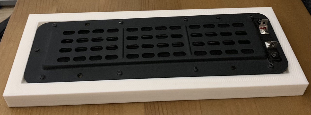

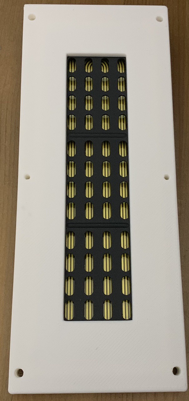

Coaxial is the obvious option, but I would like to try if I can fit in the GRS PT 6816 planar tweeter in there...

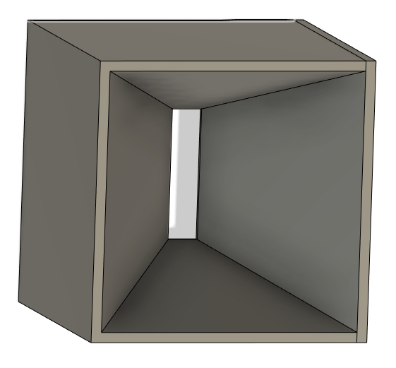

V1 - 60 x 36 horn would fit.

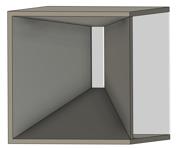

This would be just a standard thing. However, since this is a planar driver, I might actually try to get some inspiration from Yorkville SA-102 - and use the ribbon horizontally. Maybe not the best idea, but I try it at least in 3D It would make fitting a woofer easier.
Or maybe I will try assymetrical vertical coverage first. The ribbon is quite directional anyway...

The Yorkville inspired horn has (as expected) most space for the woofer. It could even fit an 8" woofer and the bass reflex ports / vents can be placed at the front easily. I wonder how much of a problem is the asymetry. And maybe using this horn laid on its side would be better?
If I moved the GRS PT 6816 flange into the corner, I would get an asymetric horn in both directions - and then theoretically 4 of them could be stacked together...in a 2x2 Kallax shelf

I actually thought about combining the PT6816 with two 4" mids in a synergy - but never got around to ordering them.

I wonder if Eminence Alpha 8 or Fane Sovereign 8-225 would be suitable woofers for this application. BC 8PE21 was usable (without a back cover) up to around 800 Hz in my Runt clone. Here the woofer entry ports can be closer to the apex. Even a single central port should allow crossover around 600 Hz without any trouble. Time to fire up Hornresp and do some simulations.

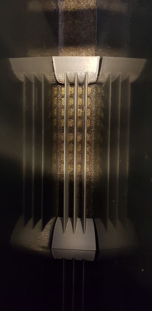

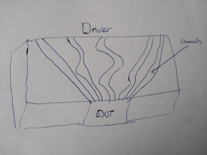

Fun stuff. I would be really careful adding anything like a “phase plug” in front of a planar tweeter as it tends to mess up the smooth response. Maybe vanes like a Smith horn might work? Even the throat area needs to be more of an wider expansion waveguide vs narrow throat. Maybe open up the top wall by 10deg more so not a perpendicular wall?
With 3D it should be possible - but I do not know how it should look like. Could you please make a hand sketch so I get the idea better?

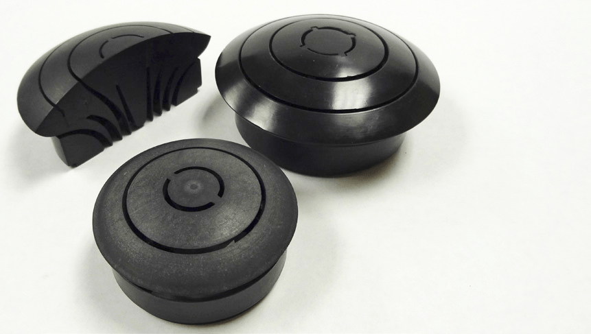

The objective of the phase plug would be to equalise the length of the diaphragm in the long dimension (2D) to a smaller throat while preserving a horn area expansion rule. Here is a conventional phase plug for a dome compression driver:
The basic idea would be equalise the channel lengths by making channels closer to the center have more bends to increase their length. Also the channels need to expand in area correctly. I'm very bad at drawing but something like this:
We can simulate such things in AKABAK 3 now
Jack Oclee-Browns PhD thesis looks like it would have lots of useful info on phase plug design.
Maybe something like this? https://goopics.net/i/g8qous

@xrk971: It is hard to see, the top angle is around 10 degrees, the bottom angle is 40 degrees. I saw this arrangement at Yorkville SA-102 - but use a planar driver instead of a paraline.

Yes, but vanes the other orientation. 90deg rotated so perpendicular to axis.Maybe something like this? https://goopics.net/i/g8qous View attachment 1020873
