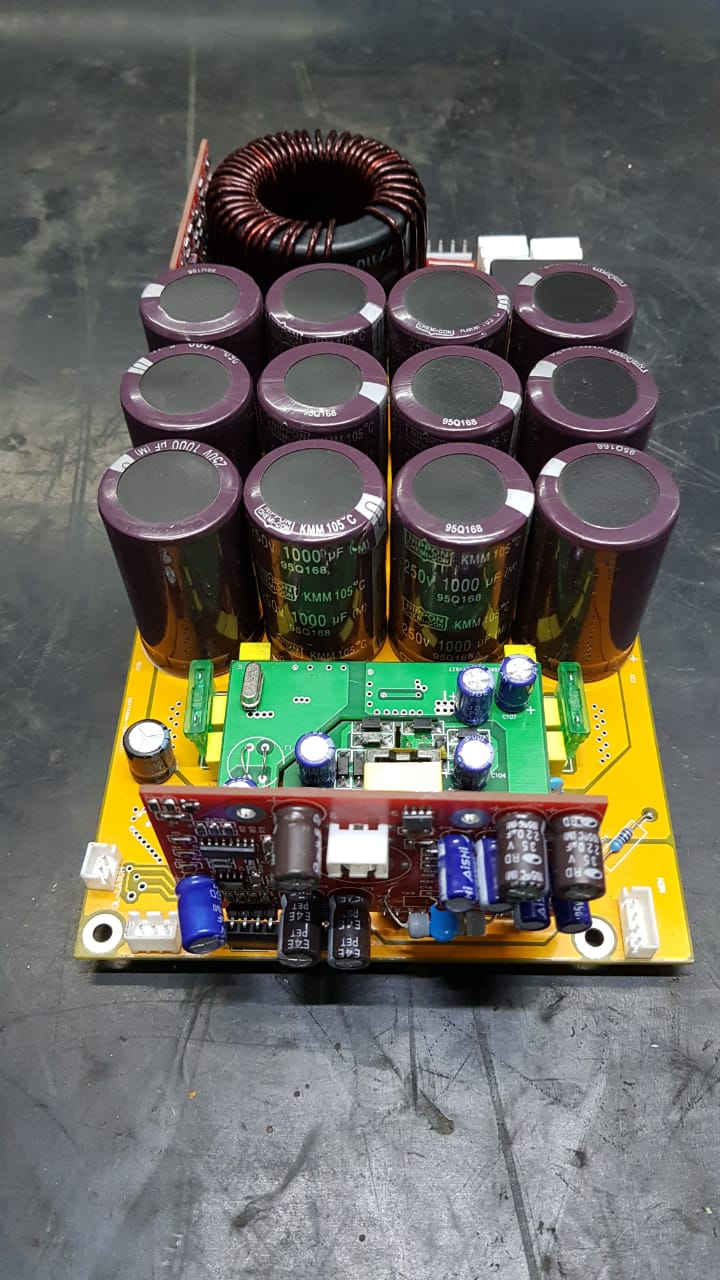

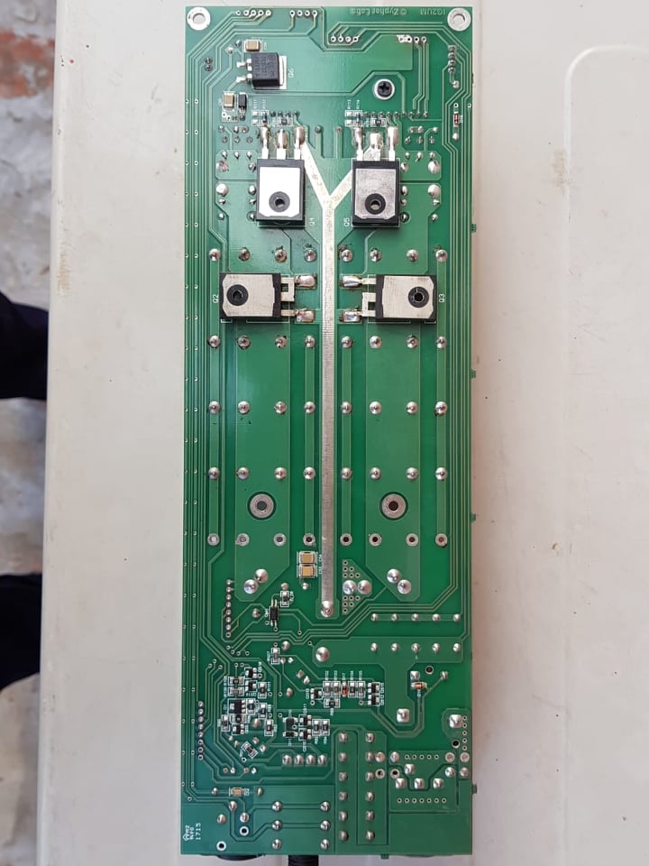

IGBT DCLASS
Hello
greetings here single pair IGBT class D 180 0 180 dc supply rails
warm regards
Andrew😉😉
