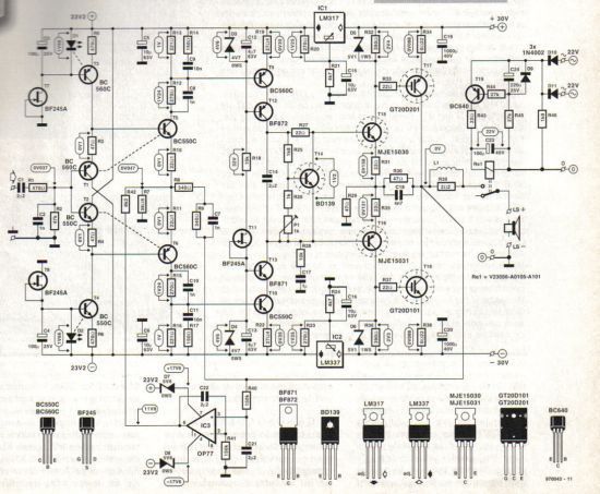

- There are P-channel IGBTs too. The GT20D201/GT20D101 complemantary N/P audio IGBT pair was once available from Toshiba, and a circuit using them was published in Elektor some years ago. Check the following link: http://www.arky.ru/audio/shem/igbt/igbt.htm

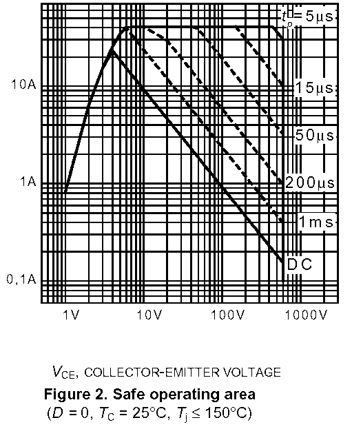

- All modern switching IGBTs feature square SOA, like MOSFETs.

Most data sheets do not show forward bias SOA at DC (needed for linear use) because they are intended for switching (they show turn-off SOA instead).
"a rugged device with a square switching SOA" (quote from IR sheet)

Elektor IGBT amp
This IGBT amplfier was published some years ago by Elektor.
The specs of this amplifier were quite good according to measurements done by Elektor.

One more example of dissipation limited SOA: SKP10N60 IGBT. This is a TO-220 device which explains the much lower pulsed dissipation capabilities. BTW: This IGBT is one of those that is paralleling-friendly.
