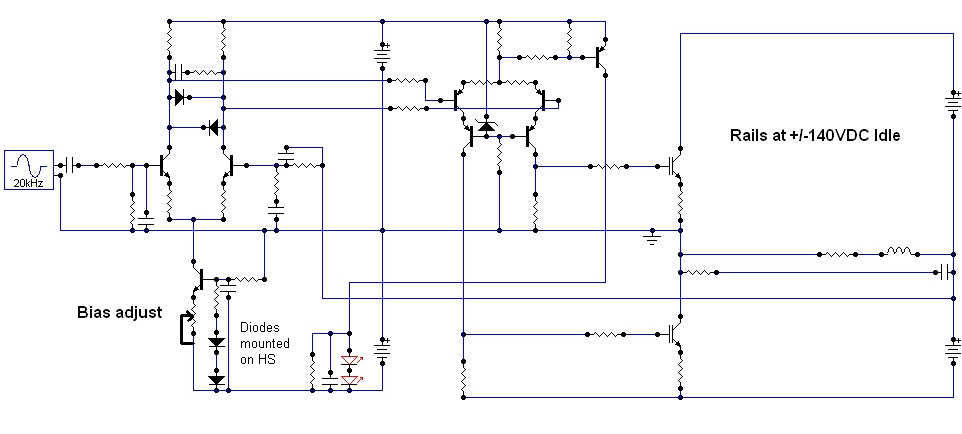

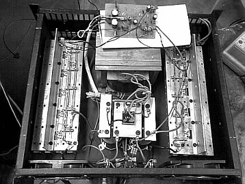

I have been built
an Elector IGBT amp
by Giesberts...
That one from the first page SCH
while ago (1998?)
that was two mono blocks in same chasis...
I must say that was amp to remeber
realy...
etremly fast sound
excelent dumping factor
and operation i class A to about 2.5W
with 400mA cuescient current
the amp shows no Sandy sound against MOSFET amps
sound sometimes could be compared with germanium amps...
IGBT devices was not coupled
but all other BC550C/BC560C was...

Work horse .What is the schematic like I would love to see it !
the photo of your amp looks good,very good
regards Trev
regards Trev
