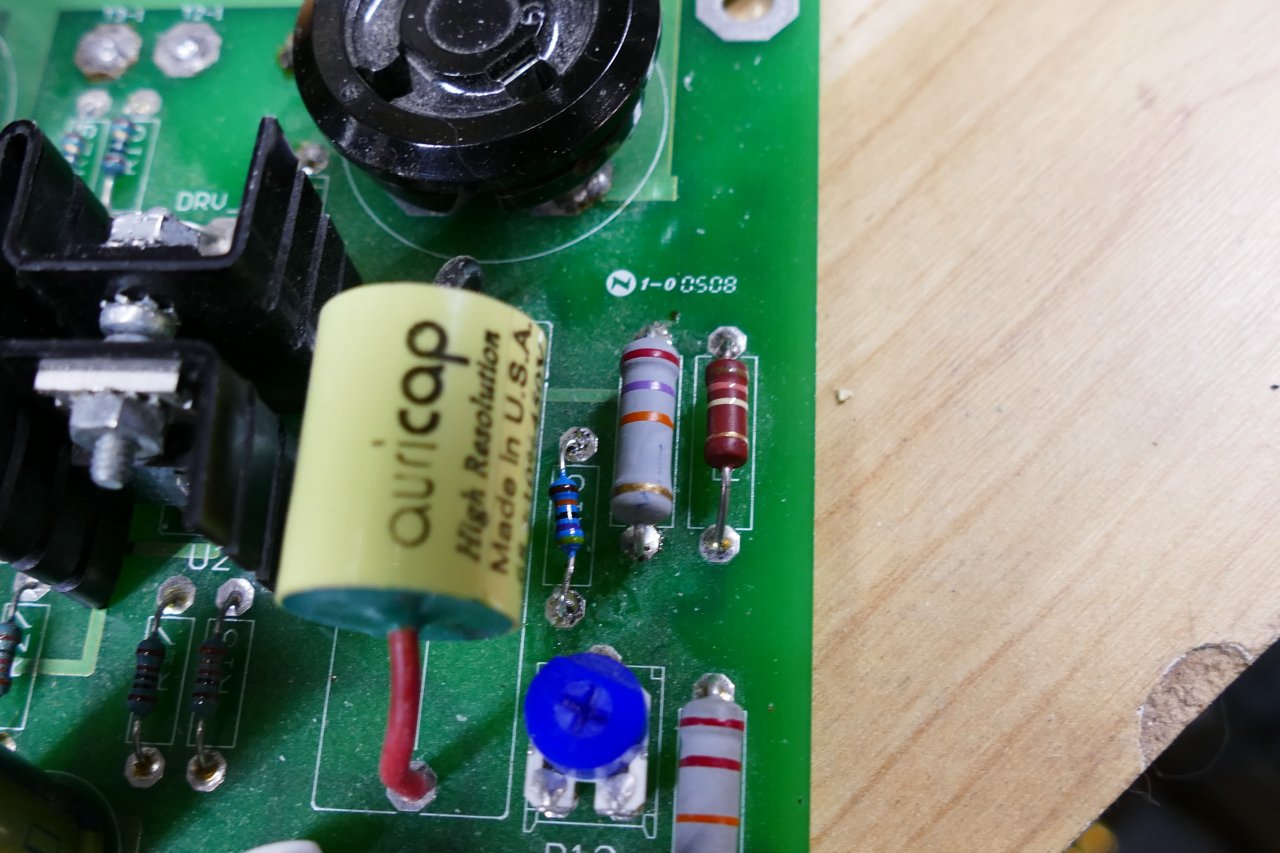

I think I found the problem but need to double check everything. After replaced the cap, and got the cap meter check that found nothing wrong. Now I realized the color is different on resistor. Compare with the original images, it's absolutely missing the red color.
Both resistors have the same value so I guess the top one is burned. Will compare all resistors on both channels to see anything else is bad. 🙂
The values are slightly different. Google resistor color codes.
One is 511, the other is 512. But I believe that the 3rd ring is a multiplier, so one could be 510 ohms and the other 5100 ohms. Did they measure the same?
Could also be 5.11k and 5.12k, that would be a 0.2% difference ;-)

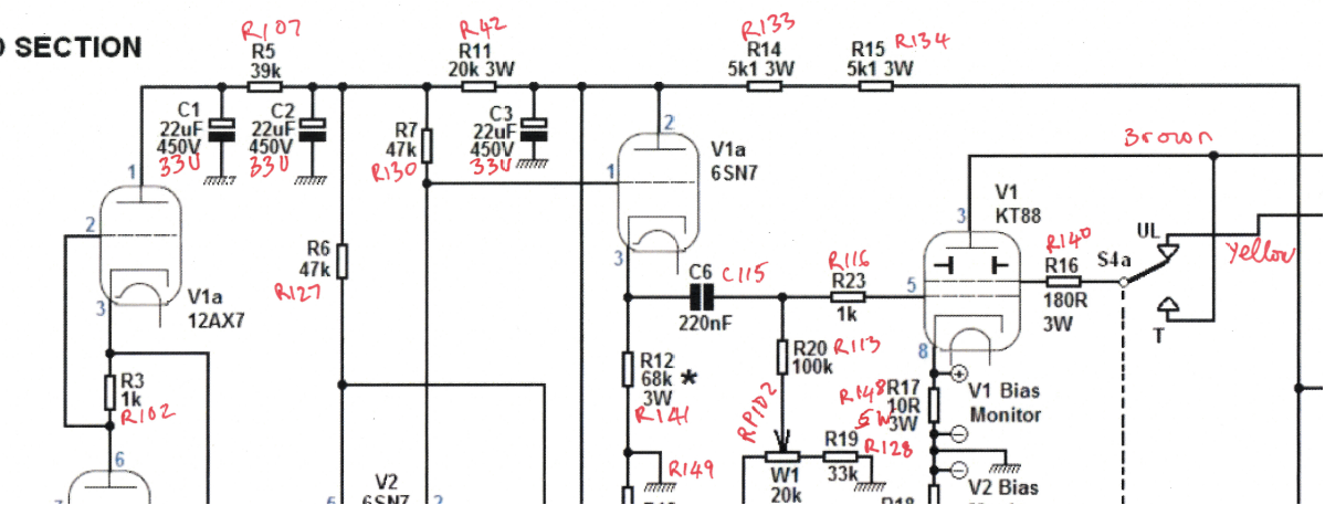

Both resistors are the same value and in series on the schematic so they should be the same color code. It seems like both resistors on right channel has a little bit lower value than the working left channel.

Both resistors have the same nominal value, i.e. 5K1, did you measure them with an Ohm-meter?
Overheated resistors tend to measure a higher value.
One of the 5K1 resistors is clearly overheated, in the circuit both are series connected to a 22uF/450V electrolytic capacitor, please check that capacitor.
If they are series connected and have the same value, both would be overheated the same, or none would.

I am making the following assumptions based on the information I see here and the schematic that was posted. There could be other possibilities if the schematic is not correct, or something else has happened.
It appears that there are 4 of these 5.1 K resistors in your amp. There are two in each channel which are wired in series. It would be rather hard for one of the 2 resistors which are in series to get that burnt with no damage to the other, unless there was an accidental short from the junction of the two resistors to something.
It could be remotely possible that a short (misplaced solder blob...) on one of the new caps could have caused the 6SN7 to draw excessive current, and the "smell" could have been a 6SN7 in red plate meltdown. Did one of them glow brightly at the time the amp made a smell? If so, it could now be dead.

The fried valve is too fantastic: it has a 68k in the cathode. If anything draws excessive current it can only be the cap. It is still essential to compare the current in both channels; perhaps the resistors were designed to dissipate too close to their rated power.

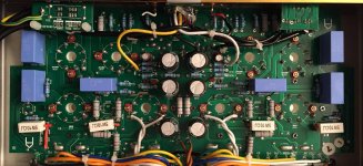

Those 3 black caps may have to take out to do a measurement? I have tool meter to check them but wonder if I can leave it there to get a measurement.
Just the one connected with the 5K1 resistor, remove it and then measure.
I cannot see the overheated resistor in the photo, so it is not updated.

The overheated resistor image post #35 on page 4 which the red color changed to black. The image on post 54 is all original parts. I don't think it was a short circuit except the smell of burning which I turned off right a way. This is gonna hard to desolder this cap but I will try as best as I can.

I can see that desolder the cap would be a total PITA, so try to swap valves first, another possibility is to make dynamic measurements which involves to work with the amp alive with high voltages all over.
If the cap is severely damaged it can be seen, maybe an updated photo will help, if not you must check the caps, be careful desoldering them.
Here was the original image that was working fine before
Probably the smell of burning came from that resistor. I am not sure if it's good or not. Replacing would prevent more damage in the future. I am gonna to take time to compare every single of them. Got the tool to measure the resistor now so I will check them. I am not comfortable to do the voltage check when the amp is on. 😀
