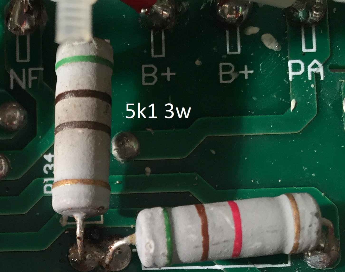

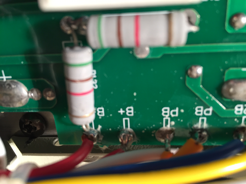

I think I found the problem but need to double check everything. After replaced the cap, and got the cap meter check that found nothing wrong. Now I realized the color is different on resistor. Compare with the original images, it's absolutely missing the red color.
Both resistors have the same value so I guess the top one is burned. Will compare all resistors on both channels to see anything else is bad. 🙂
It does not look burnt. Perhaps getting a bit hottish, but with resistors it is tricky to say what is within limits without reading the datasheet, some have amazingly high working temperatures.
You should start by measuring the resistance and the operating voltage drop.
Here was the original image that was working fine before
Probably the smell of burning came from that resistor. I am not sure if it's good or not. Replacing would prevent more damage in the future. I am gonna to take time to compare every single of them. Got the tool to measure the resistor now so I will check them. I am not comfortable to do the voltage check when the amp is on. 😀
ok,you are right,but the burned resistance is the consequence of the problem and probably not the cause
Get adult supervision then.
There is no other way to tell if a resistor is dissipating more than it should.
Colour and temperature are not good indicators and neither is smell, after the capacitor olfactory fiasco 😛
