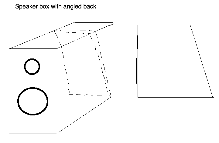

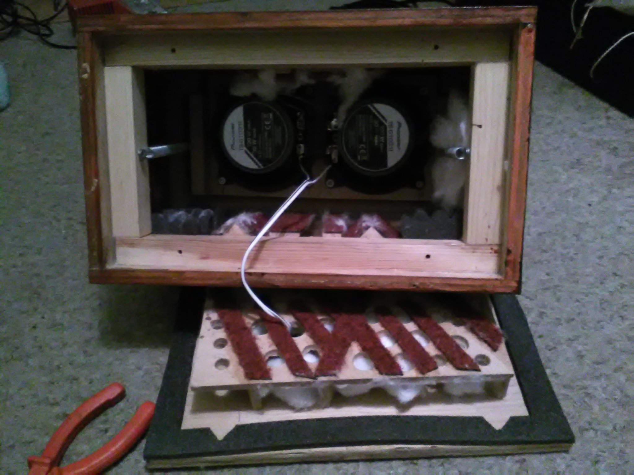

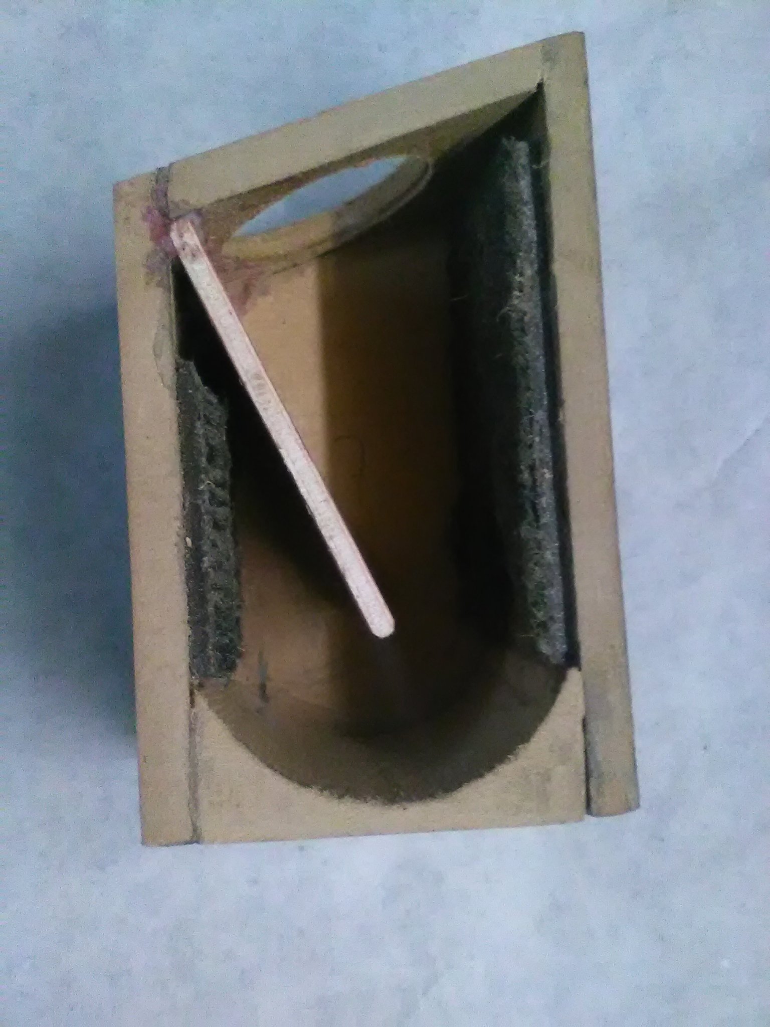

Rectangular boxes are easy to make, tapered boxes absorb the driver back wave; stick in an angled baffle and you get a taper in a box, and get a free brace. The dark stuff is carpet tile, in a vain attempt to absorb internal sound and dampen enclosure vibration, however I doubt it makes an lick of difference.

^ This kind of structures create longer path lengths inside the enclosure than "empty box" has. Imagine "unfolding" the structure at the internal panel, you'd have very long enclosure.
Longer path makes standing waves even lower in frequency and hence less affected by (same) damping material and possibly worsens performance in this regard. But, allows you to tailor the standing waves as well, which might be taken advantage of, extend the low frequency response. Extending low frequency response might be useful for bass box, not so for a mid. Unless, the now longer standing wave is below the mids pass band making it less of an issue, and enables the standing waves within pass band absorbed more then it was a good thing. But it is kind of chasing ones own tail. Another possibility for such divider panel is to make a "stub", try and tune it to some existing resonance and kill it some as 1/4 wave resonator.
Structure like this is good sales argument for sure! 🙂 Otherwise I see it not too important feature in light of whole speaker system since it seems to pass problems around (shift from a frequencies to another). People use this kind of stuff with fullrange systems and less so with multiway systems even though on multiway systems this might work better than with fullranges since there is pass band and stop band for each way, possibility to push problems out of band and reap the advantages. Well, haven't utilized any so this is just theoretical thinking I'm writing about.

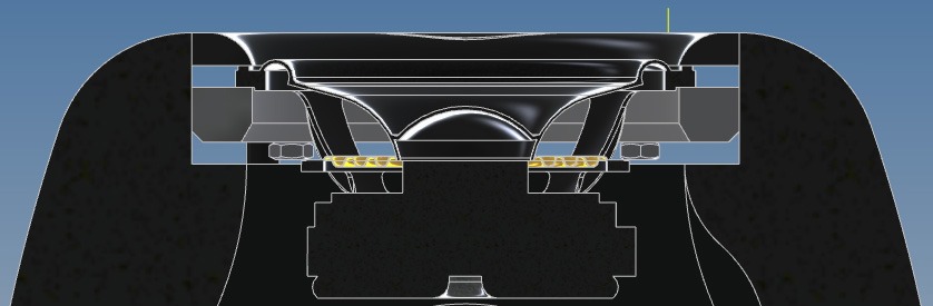

There are some simulations performed in the link above and surrounding pages that show some of these effects. The addition of a 6mm chamfer in front of the driver had a positive effect, and the overall teardrop shape with significant rounding made for a very smooth response. Much can be worked out from basics, but the overall interaction of every component can be tricky to get right. BEM simulation or lots of prototyping is really needed if any sort of optimization is desired.
One thing this simulation did show was that fluent shapes can be of importance even if their dimensions seem small at first.
My own thought proces behind the shape was creating the most fluent shapes, from the cone out to the outer enclosure lines.
(partially hidden by the surround in my case due to driver choice)
Kind of like a horn turned inside out. 🙂
A quick opening up followed by taller smoother curves. Done to limit diffraction as much as possible.

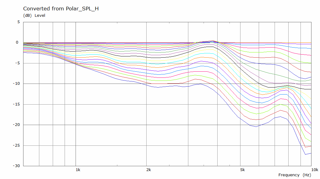

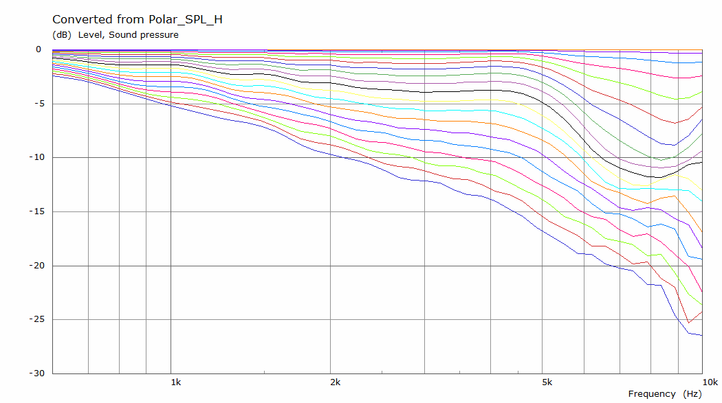

I have to wonder if you looked at the outputs from the simulations and CAD drawings as I find it highly unlikely that these two directivity graphs will sound the same.
Simulations are a guide. A hint.
When looking at directivity, BEM sims are very accurate, there is a reason why all the major manufacturers use BEM and FEM simulations. There is always a need to build and verify but they are much more useful than your comments suggest.
