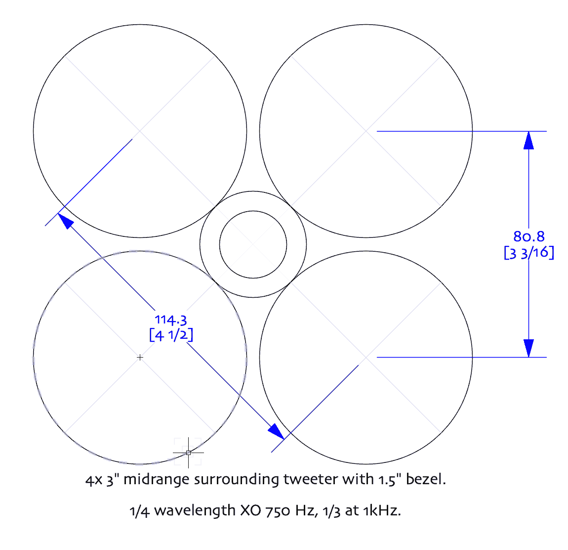

If you are going to build a speaker with 4 midrange drivers in a rectangular array and a single tweeter somewhere in the middle, the size and dimensions of the baffle and where the drivers are located relative to each other and the edges of the baffle are far more important than the shape of the back of the box. It's not clear if you have really solved that problem or not.

It's 4 drivers + 2 passive radiators for each vertical array of speakers. I don't want the speakers to become too big.
At the moment I am looking to make a v shape divider of the 2 vertical arrays. So each array of 2 drivers + 1 passive radiator will share the space.
My only concern is position of passive radiators. To make speakers compact I have to put them in the rear or down firing. Need to read through the other thread hifijim posted

Horizontally the centers of the drivers need to be more or less equal to distance between ears. That's what cross talk paper matt Polk wrote and most online sources recommend. So 7" -7.5". Positioning drivers further apart widens the stage. Bringing them closer narrows.What design criteria are using to establish the positions of the drivers on the front baffle?
Vertically trying to make them as compact as possible. Tweeter is 3" x 4" approximately.
Passive radiators seem to play 180 degrees out of phase. I asked this question elsewhere. Is there a position of passive radiators that will cancel the 180 degree out of phase play . If they are on the same front baffle plane seems they playing out of phase. But if pointing to the back would this sort of align the bass waves with bass coming from drivers?
With 4 mids surrounding a tweeter you want them as close as possible. Ideally one wants to get to one-forth the wavelength at teh XO centre-to-centre. If this can be achieved then the drivers effectively become coincident and there is no lobing… as one gets further and further away from this ideal one gets more and more combing. Typically, because getting mids this close to the tweeter is difficut, you see an MTM arrangment which will comb/lobe in the vertical, not the horizonatl (this is eqivalent to Richard’s "Horizontally the centers of the drivers need to be more or less equal to distance between ears”).
Given a circular array around the tweeter, it will start lobing both horizontaly & vertically, the horizontal can get quite annoying.
You either need a really small bezel on the tweeter and small mids, or a T that can XO really low.
As the listening distance increase, the affect sof the lobing become less noticable. Except maybe the way room reflectiosn happen.

Reading about acoustic lobing. And 4th of a wavelength
All 4 drivers 6.5" dynaudio 17w75xl
The frequency cut off for drivers and tweeter is 2000hz with these particular sda cross overs. 2000hz+ goes to tweeter, everything below 2000hz goes to midrange/midbass drivers. Some other sda models had 2500hz cross over points . Not sure if it's the cross over frequency relevant here.

You might want to consider an arrangment of mids that works to kill the lobing.

Isn't the lobing effect that Polk sda effect tried to eliminate with cross talk cancelation? It seems like horizontal lobing is resolved. But vertical is introduced since I am replacing one 8ohm 6.5" drivers with a vertical array of 2 6.5" drivers
What if your proposed position of 4 drivers is rotated 90 degrees. Basically I making a horizontal sda effect+ vertical sda effect. Just random thought. Not sure it's gonna work though

6.5" drivers start to lobe at 1285hz. If using this formula
f = (2 * c) / (π * D)
Where :
Trying to find out the vertical distance between the drivers to minimize lobing..
