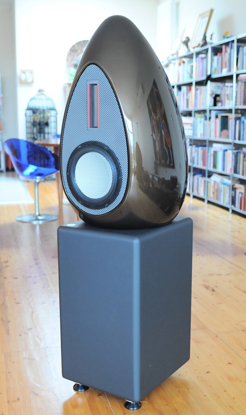

I have not heard your speakers so that would be total bull dropping's conjecture to suggest they have any fault. Just suggesting the difference between a very complex shape because CAD says so and a simple radius it quite small when put into a real room and easily overshadowed by room, driver, and crossover issues. I have found the bandwidth where the drivers are reasonably in phase to be more significant than some suggest. There are some outstanding speakers with simple box shapes and less round over than even I manage. How can that be? Because they look at more of the overall issues. The more exotic the shape, the further away from each other the mid and tweet wind up, and so the bigger the problems with off axis. I prefer to trim my flange and basket to shift those problems as high as I can and concentrate on the bandwidth were the drivers are reasonably in phase.
One could have more fun. Make it round-ish and go to town with a rasp or angle grinder making some ugly convoluted random shape to further distribute any refractions and confuse baffle step. Maybe dimple the baffle with varying size, randomly placed dents. Not easy, hard to simulate, and most likely to fail WAF. Actually, with the computing power available, I am surprised no OEM has done this and then printed or machined the result. Design is far cheaper than manufacturing.

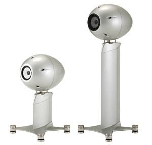

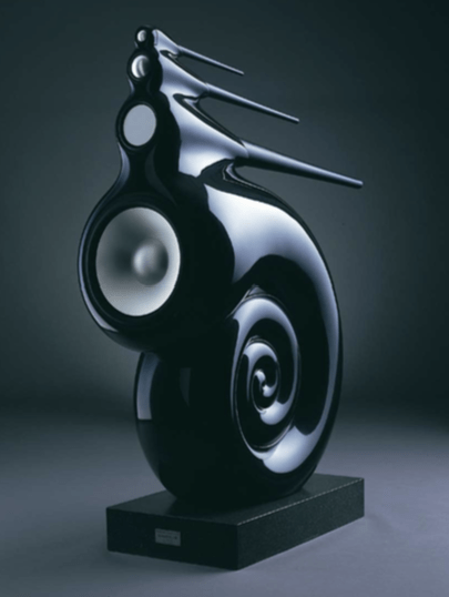

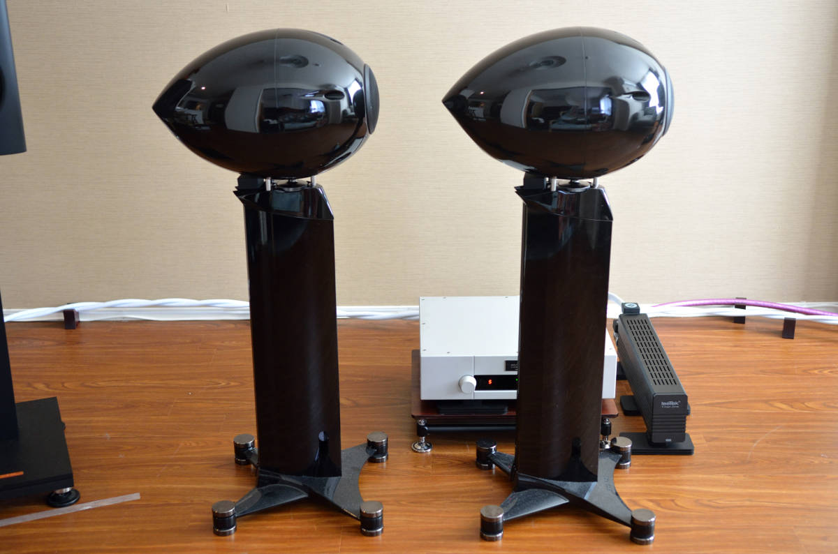

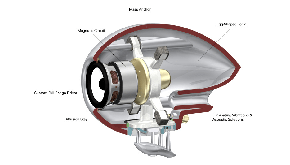

Except for the flat baffle. Mach 5 did the eff 2-way midTweeter egg better, and B&W probably represents th eleading edge.

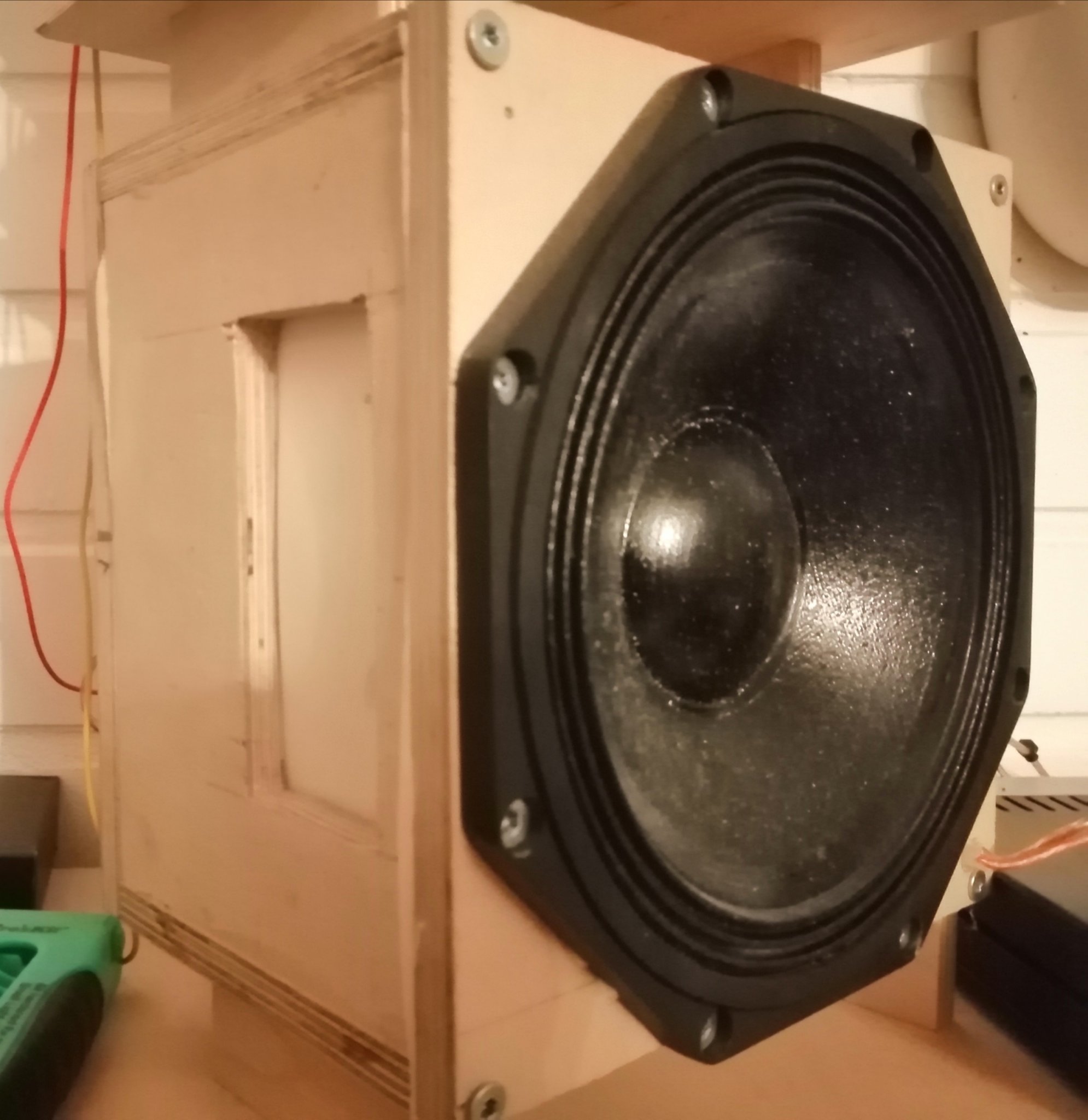

Here is best I've ever come up with. No bottom end, but least diffraction and resonances of my builds, passive cardioid. Cheapest smallest and fastest build, no need for recess or bracing 😀 doesn't get any better for home builder, but it is some work to tune the response and requires woofer and tweeter at least to make a system, with compatible requirements for those as well. Bass boxes are easy to build, just plan the problems outside of the pass band. tweeter waveguide doesnt need box at all which makes overall easy build without much structure related problems. Certainly less than all 3 drivers on rectangular single box without roundovers. But possibly demands for active xo so.. pick where the easy part is, in the garage or with a credit card or on a design desk.
Ideal structure depends on the application and design of course. Ideal shape for home is simple box since minimal tools required and cost is low. Or just get the thing printed somewhere and call it a day.
It's a closed box, it's just a taper ( like B & W nautilus ) bent around to fit in a box. They're VERY small, about 80 mm tall - a computer speaker that needs a sub.![]()
