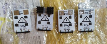

Hi Tibi, I received four HV bridges two days ago, my three bridges 320V, 80V and 80V are all right, but I got complaints from the bridge ordered by friend "Merlin el Mago" you remember, our orders are joined to my address to save delivery costs. His bridge is rated at a higher voltage (150V) than requested (125vac, O,8A, 50Hz). Please see pic atch. on left side. Is that all right within the specifications, or was misplaced, intended for another person?

Thank you for delivery confirmation, Jordi!
The bridge for Merlin el Mago will work just fine between 24Vac and 150Vac, including requested 125Vac.

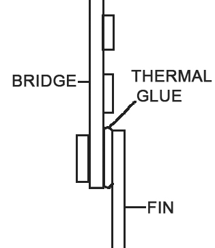

Thank you Tibi for your reply,
that's exactly the thermal glue i have, i would use that. But to be honest, it would be convenient for me to fix the bridges to the aluminium chassis fins (even if less effective as heat sinks) just to give them a stable still position in the chassis, as in my amp PS section i don't have a PCB to solder them and for the first try they're still "flying". Previous diodes where fixed to those aluminium fins indeed.
Just wanted to be sure connecting the rear metal pads to chassis "ground"won't be a problem. The rest of the bridge would not be connected, see picture below
