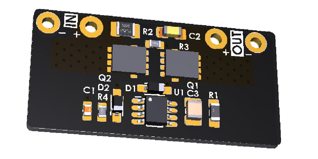

BSS123 is not the right choice here.
Of course not, i only used the transistor types for the footprints. It's still only a rough draft.
Practical HV mosfets would be BSS127/dmn60h080ds for X10-X40 and STB24N60M6/ixfh26n60q/sihj240n60e/sihd240n60e for M1-M4.
The regulator is easy, as there is only a single one that works at 450v and only at 50-60Hz as the 1170 takes a lot more current at higher frequencies.
A small reminder when using with a typical valve center tapped transformer: the max output voltage drops by half. So much for my hopes to replace all the mercury rectifiers 🙂 Certainly not an issue with new designs which don't use a center tapped transformer.

I would never have thought of such an obscure part like the 1170 without the information you shared. Not in a hundred years. Once the part is known, finding out how to use it is not that hard.
Sadly, it appears very hard to incorporate it in my existing projects as they all use choke input supplies with center tapped transformers and low dcr chokes. And relatively high voltages. I need new transformers in order to try the synchronous bridges out. Cannot see this happening any time soon.

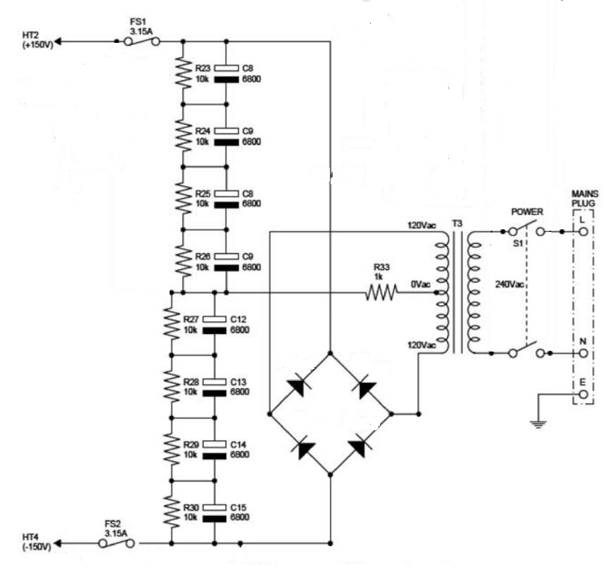

Hi Tibi. Not being an electronics expert I got a bit confused a while back with the various posts about centre tapped tranformers. Will your Saligny HV work in the power supply arrangement attached below? I think it'll be fine but thought I would check.
Assuming so, and if it isn't too late, can I amend my GB order for 1 * Saligny HV to increase the AC voltage to suit the schematic (240VAC).
Sorry to be a nuisance but I decided to build something different to my original plan.
The issue with centre tapped transformers is only their voltage inefficiency. In your case there will be no problem as the voltage is so low.
Yes, Saligny HV will work.
