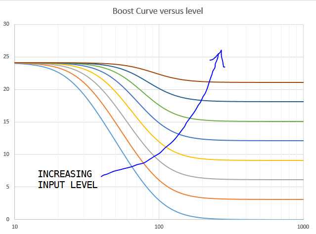

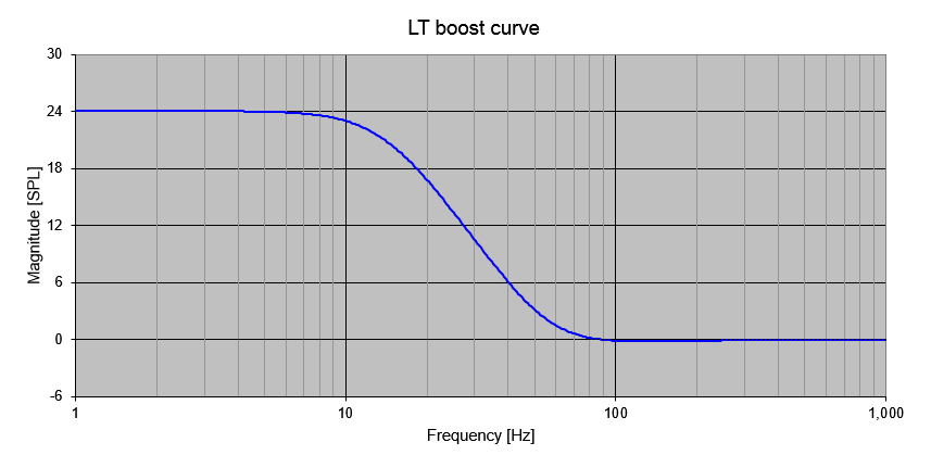

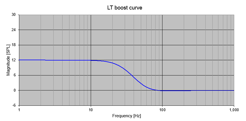

For measurements, could you try doing a series of sweeps with REW at different volumes (looping through the plugin to measure its effect) and post the "all SPL" view? If you can set REW to pink noise instead of sine sweep that would be interesting as well. It should come out looking something like this, right?
Not exactly. The highest input level should have the LEAST amount of boost... you have it backwards.Congrats on getting it working!
Reverse the order (top to bottom) of the curves and align them so that they all intersect at the lowest frequency, e.g. at the upper left.
Also, the shape of the curves is exactly the same near the middle, where the boost is just beginning. The shape will only differ at the lowest frequencies.
Doh, of course. so like this?
Like the attached plot. The blue curve has the largest difference between the boost at low and high frequencies. This curve is what you get with very low input level. As the input level is raised, the amount of boost is limited so as the total output will not exceed some level (in this case it's 24dB on the y-axis). This means that the relative difference in level between high and low frequencies is less, because there is less low frequency boost.
In the attached plot the input level increases from lowest curve to highest.
Bingo. You posted your reply while I was writing my post.
Thank you, yes this is very clear. The measurements through the plugin should match this with a minimum of distortion, if all goes well.

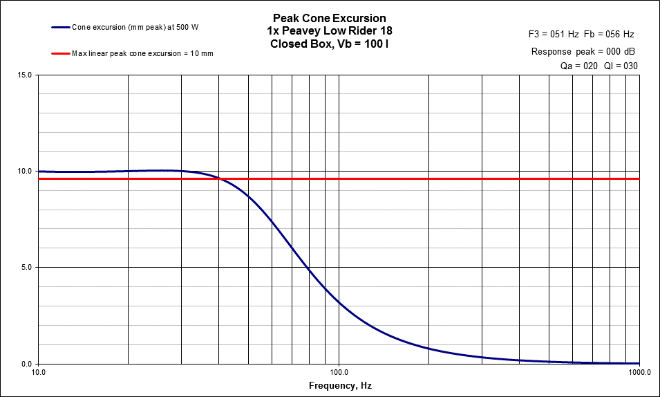

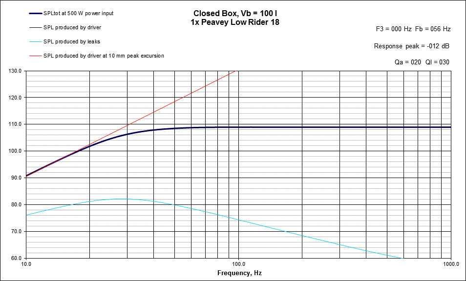

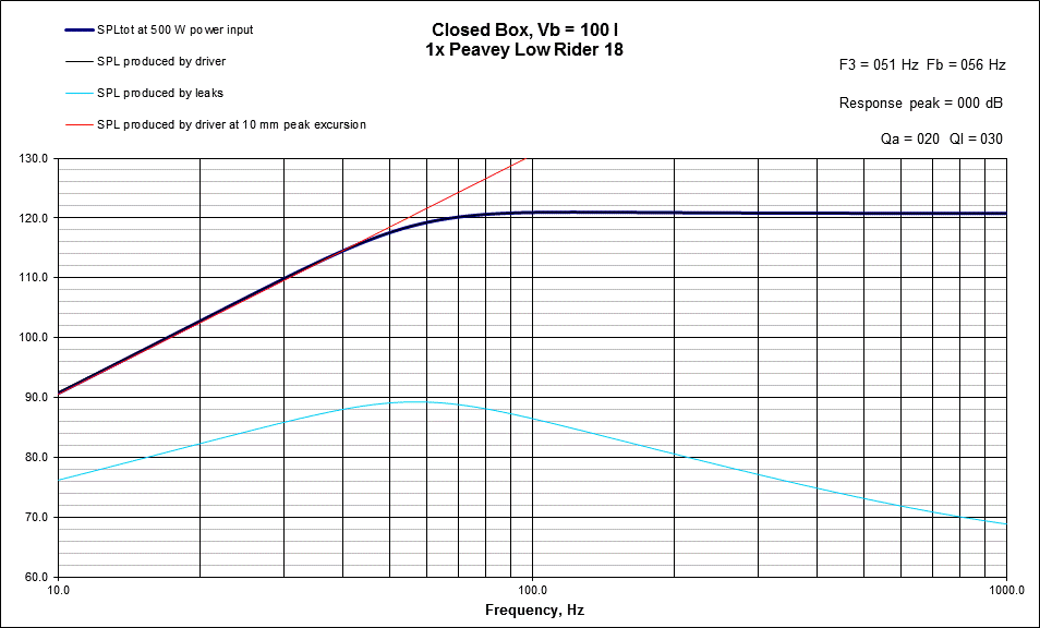

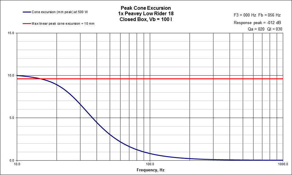

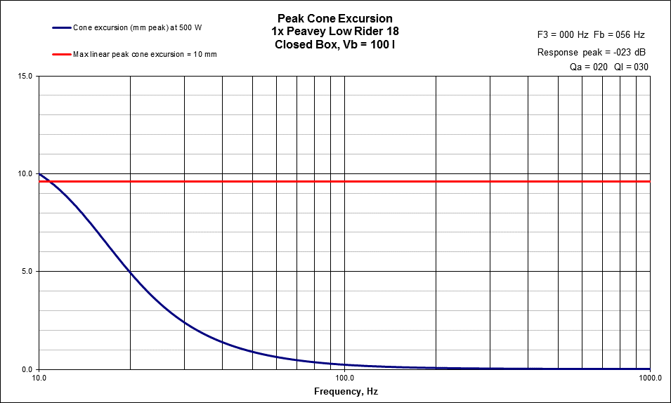

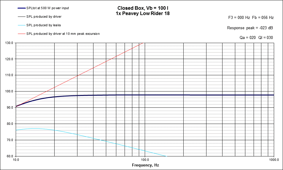

I worked up a model of the CLLTwbl plugin paired with a driver in a closed box to show how limiting the output voltage limits the power delivered by the amp to the driver, which also limits the cone excursion. In this example I am using a Peavey Low Rider 18 (because I actually have a pair of these) in a 100 liter closed box. There is no magic about this driver - it could just as well be any subwoofer driver in a closed box. I am using Unibox to generate the driver plots and my ACD tools to generate the LT curves.
The first (leftmost) two attached plots show the frequency response and cone excursion of the driver in the box specified, given 500W of input power. The Fb is about 56 Hz with Q about 0.78. Excursion tops out around Xmax (Xmax=9.6mm) at low frequencies. We can use a Linkwitz Transform to boost power to the frequencies below Fb to extend the response lower in frequency into real subwoofer territory.
The next three attached plots show what can be achieved when I choose to extend the response lower by two octaves using an LT. The boost that is required is as much as 24dB at low frequencies, and this now transforms the in-box response to Fb=14Hz and Q=0.707. We only have the same 500W of input power available, and Unibox scales the SPL levels shown in the frequency response and excursion plots so that this power level is not exceeded by the boost required by the LT. You can see that with two octaves of extension the frequency response is very flat but if the amp max power should not be exceeded at any frequency the output capability is reduced at higher frequencies - this is the case if we don't want to exceed the 500W power ceiling but we are getting input signal with "full" low frequency level. You can also see that with this frequency response, the excursion remains below Xmax even though the low end of the response has been extended, because the overall gain is reduced. As a consequence, this also limits how "loud" the system can play to about 98dB.
If we want the passband level to be higher (louder) but we still don't want to exceed the 500W capability of the amp or exceed Xmax at any frequency we can simply reduce the LT's boost. The next three plots show an example of the system when the extension has been reduced to 1 octave (12dB). Now the frequency response does not remain flat to as low of a frequency but the passband (e.g. 100Hz and higher) level has risen by 12dB to about 110dB. We have traded off low frequency extension for higher passband SPL level. This is accurate when we don't want to clip the amp or exceed the driver's Xmax.
So, with a conventional Linkwitz Transform you are faced with a choice of how much extension to use, and the amount of extension will influence amp clipping, cone excursion, and passband SPL. What if you could just automatically vary the amount of extension as the program material permits it, using more extension when the amount of low frequency bass was not high enough to exceed the amp's power output capability or the Xmax of the driver, and then dialing it back when there was more bass energy? Well that is EXACTLY what my plugin does! It dynamically changes the LT boost curve from moment to moment, using as much boost as possible without exceeding some signal level threshold. Since the internal signal level is directly related to the amp's output power and, as you can see by my example, to driver cone excursion, the plugin is limiting both of these as well.
The above example is a bit simplistic in that it does not take into account the relative amount of power in the very low bass versus 100Hz and higher, and other factors, but I hope that it illustrates the motivation behind the plugin and the benefits of using it in place of a traditional LT.

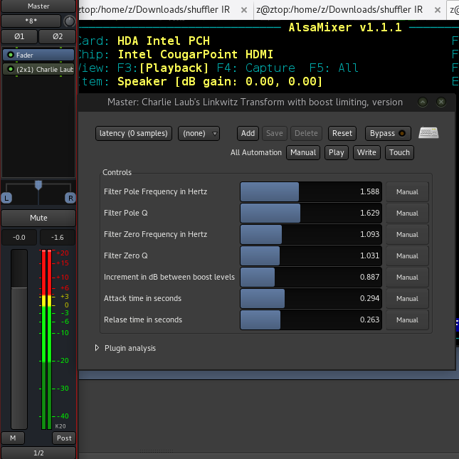

First, in a console, type "listplugins" and then look for the CLLTwbl with ID 9999. It should be listed. If it is listed, have you set the ecasound LADSPA path variable? You should be able to type echo $LADSPA_PATH in a bash console and it should return the path to the plugin. Let me know what happens. It would be better if you can (at least initially) run it in ecasound because it can return error/debug info if there is a problem.
Finally, why are you using the values shown for the parameters Pole Frequency, Pole Q, Zero Frequency, and Zero Q? These are non-sensical and might be causing the plugin to crash. I should probably change the suggested/permitted ranges for these. Try using parameters like:
Pole Frequency = 20
Pole Q = 0.707
Zero Frequency = 100
Zero Q = 0.707
Increment between boost levels = 2
Attack = 0.1
Decay = 0.1

I tried everything within the ranges given by the GUI. I also suspect the nonsense values might be the problem. Will try in ecasound
What were those ranges that you mention above??? I didn't supply any suggested min or max for most of the parameters, so the GUI was just making these up on its own.
It may be the case that the IIR filter calculations suffer roundoff error problems with very low frequency values (like 1 Hz), which can cause the filter to blow up (pin the levels) and not recover. Also, you might have accidentally set the Pole Frequency to be higher than the Zero Frequency, which I didn't think about and this might cause some errors in the code somewhere... not sure. I am coding up a couple of sanity checks on the input parameters and have added suggested parameter ranges as well.
I avoid GUI interfaces - I find that they encourage the user to invoke the plugin and then twiddle with sliders or dials to see what happens without thinking about what is going on, what the values mean, etc. I fear that this is exactly how many people check out these kind of "rack effects".
