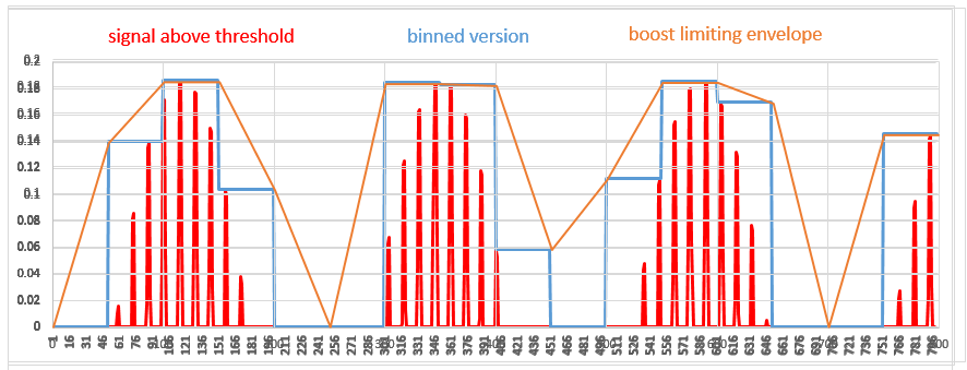

I did some coding yesterday to check the CPU utilization. The LT is basically a general biquadratic filter, which is one of the filters available through my ACDf plugin already. That was the starting point. I wanted to see how the CPU utilization changes if I added a number of other biquads, calculated in parallel. I put in 10 and then 25 and the CPU utilization was still not even 1% on a Raspberry Pi 2. This is great news - it means that I can use many very similar LTs and switch between their outputs.
Since the calculation is so inexpensive it doesn't seem worth it to save the output of each for some period of time. This would involve multiple ring buffers of total size (N LTs * sample_rate * latency) and this is not an insignificant amount of memory. Instead I can use a single ring buffer that will hold an index (unsigned integer) that indicates which LT output should be selected and then will use some algorithm to smooth that out over the user supplied latency period leading up to that sample. Once the latency period is up, all the LT biquads are recalculated from the delayed input sample stream and the selected/mixed LT output result passed on to the plugin output. This costs 2*N times more computationally (N is the number of LTs) than a single filter, but that doesn't seem to really amount to much in terms of real-world CPU utilization.
I also had the idea that it might be possible to use the smoothed LT selector as the input for an LED driver via GPIO pins that will indicate the current level of boost limiting, like an overload indicator. I would need to find a fast way to toggle GPIO pins...
I have done a little back of the envelope planning for the boost limiting algorithm and I think I have something that is computationally lightweight and can be implemented with pretty low latency if desired.
The main idea is to bin samples and then look for the maximum amplitude sample within each bin. If the max sample value exceeds the threshold, we them look among the N Linkwitz Transform outputs that are being calculated in parallel for the one that has just enough reduced low frequency boost to bring the sample value back below the threshold. At least this much boost limiting will be applied to all the samples in that bin.
To make the programming easier for me the bin width will be made the same as the buffer size of the LADSPA host. For example, I use a 1024 sample buffer at 48kHz and this comes to about about 2.1 milliseconds of audio data. The processing requires that a couple of bins are inspected for the max value before the samples that they contain can again be spit out, so the minimum latency should be on the order of 4 bins, or in this example 8.5 milliseconds. I previously thought that the minimum latency should be on the order of half the period corresponding to the lowest frequency and gave the example of 10Hz --> 50 milliseconds. I later realized that this is really only for the release time of the boost limiter, so that as the waveform passes through zero and then increases again you don't generate pulsing of the boost at 10Hz. While he "attack" can be on the order of one or two bin widths to make the boost decay over longer time scales I will simple slow down the rate that the limiting can fall back to zero. I figured out a straightforward way to do this.
In between the attack and the release we are more or less following the contour of the signal, discretized into bins. To ensure that the boost limit is always at LEAST as much as needed I will implement a rule about how the boost across and between bins are "connected", using a linear interpolation when the boost needs to be increased or decreased. This is illustrated by the attached plot.
The attachment is a plot with three separate signals:
  • the signal that is ABOVE the threshold in RED
  • the binned version of signal that is ABOVE the threshold in BLUE
  • the envelope that the boost limiter will follow in ORANGE
The signal in this example is a combination of two sine waves, one at a low frequency and the other at a high frequency. The red trace "signal above threshold" is for example the part of the signal voltage that is, for example, greater than +/- 1.0 (the absolute value is shown). To make the plot I had to manually stack three plots in Excel, so please excuse the blurry axis labeling.
