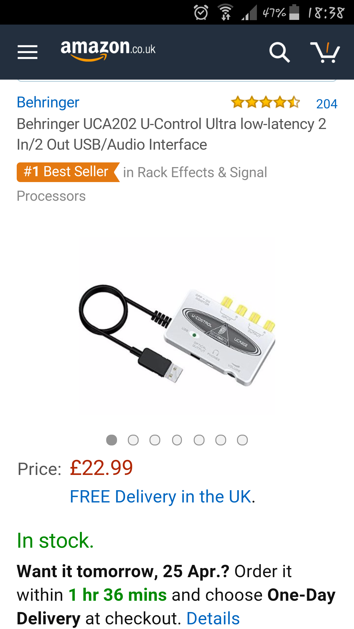

I'm sure you can set up a startup script. What are you using to get the audio I/O? I never had success with USB sound cards on the Pi for full-duplex.
Hi dynamike. I'm using a Behringer
