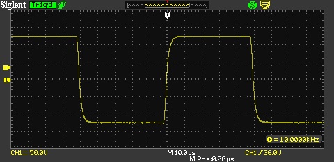

I got my parts in today and put 12pF in parallel with the 100k feedback resistor. Circuit looks pretty stable and 10kHz square wave looks pretty good now. I'm tied up for the next couple of weeks going out of town but I should be able to do some distortion measurements pretty soon at higher levels than before.

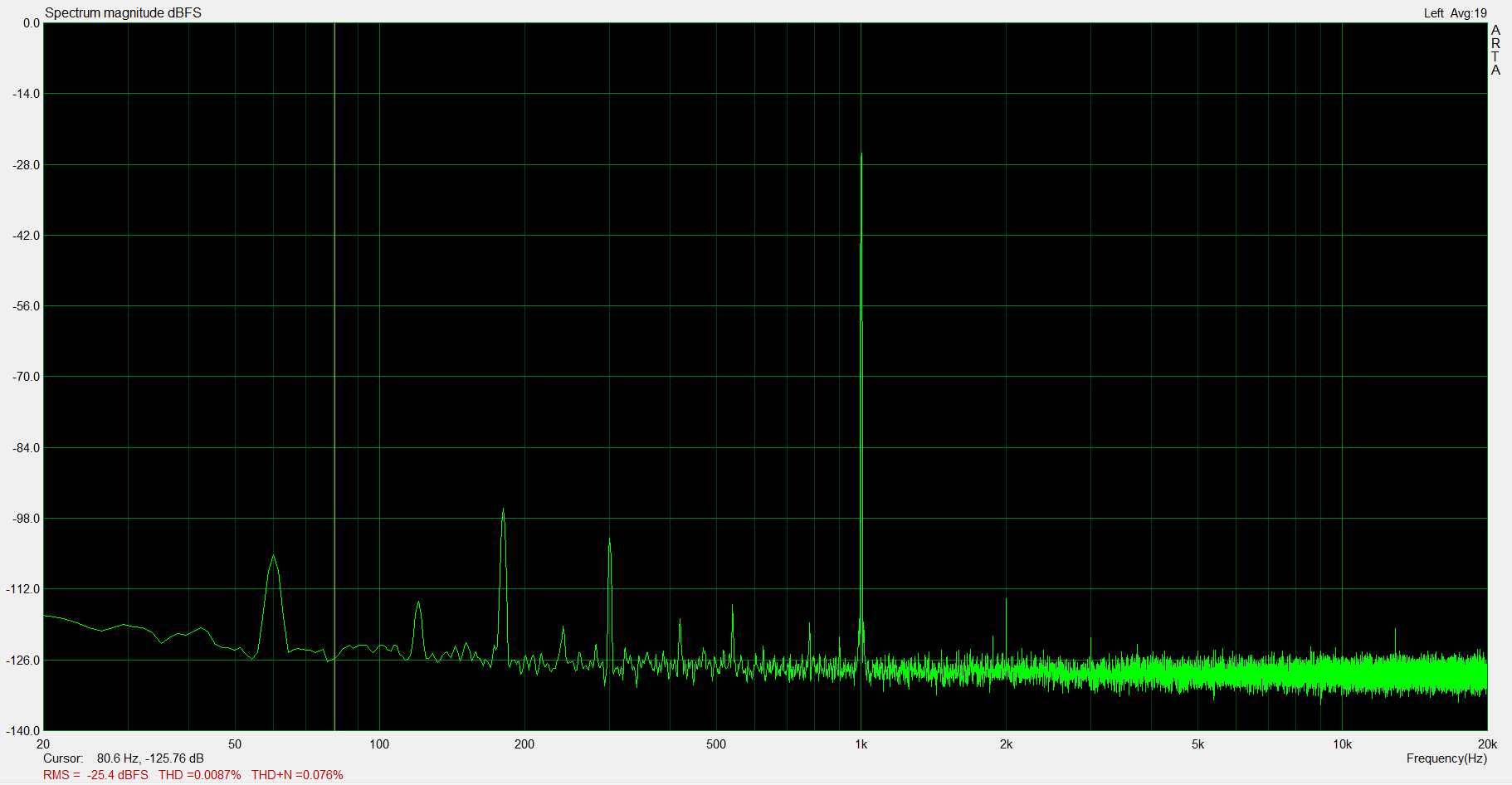

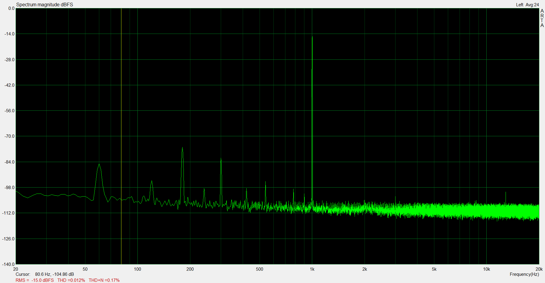

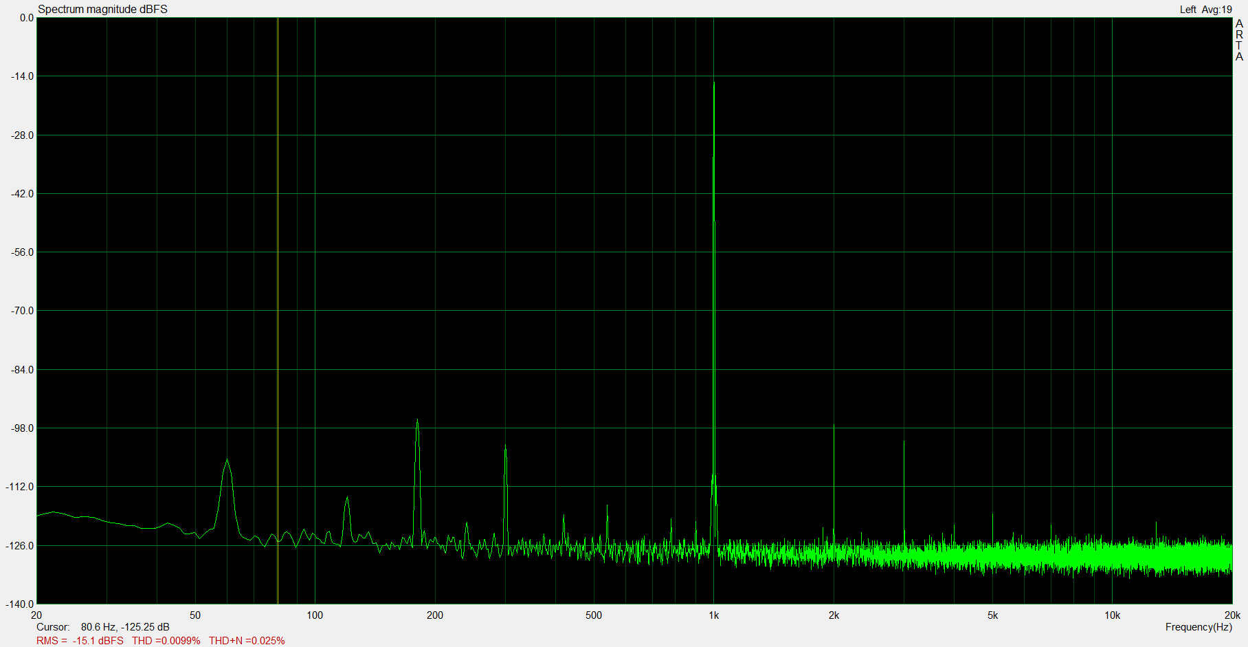

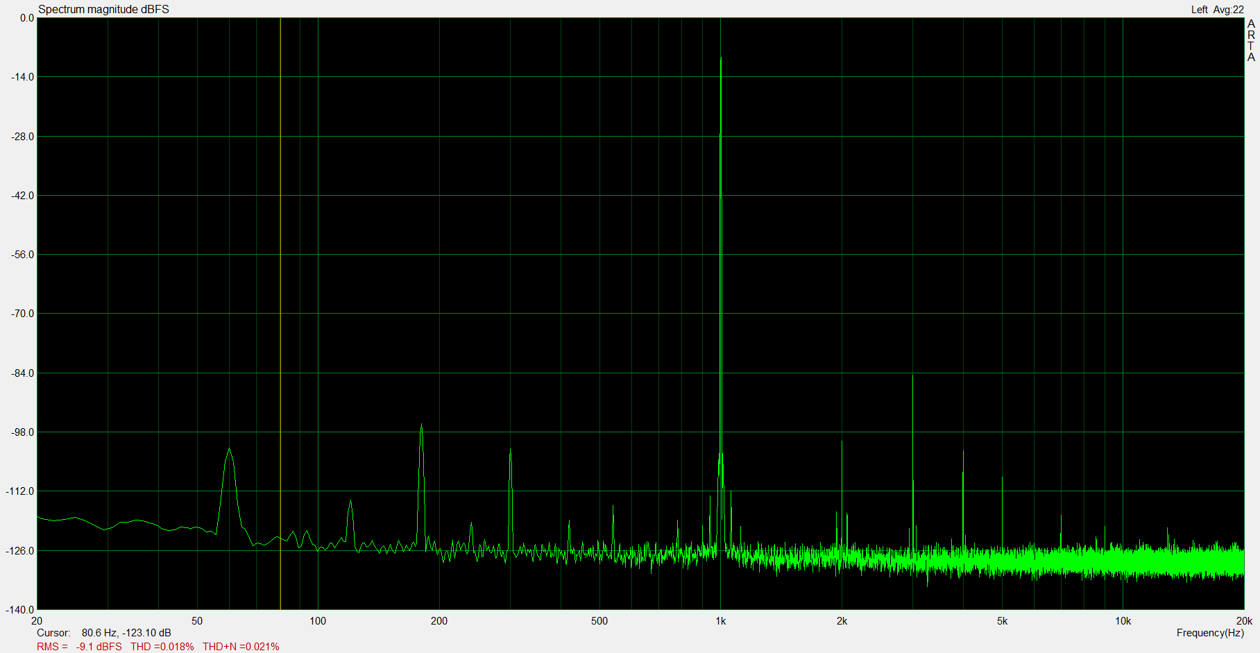

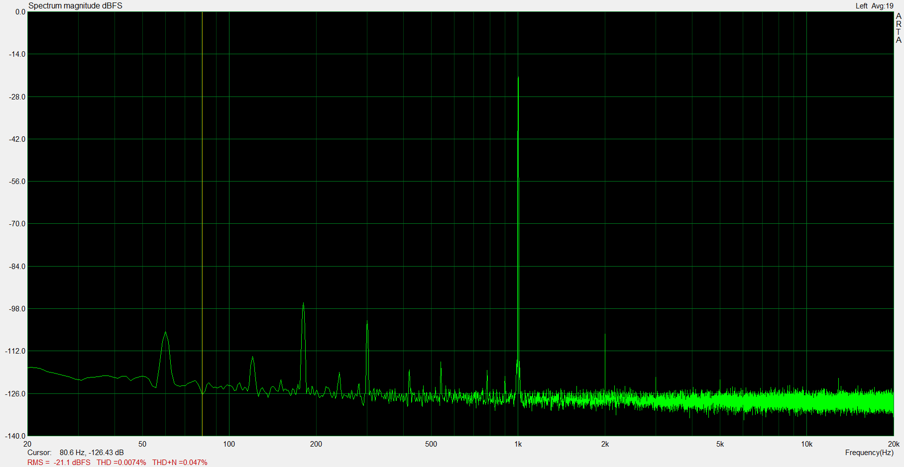

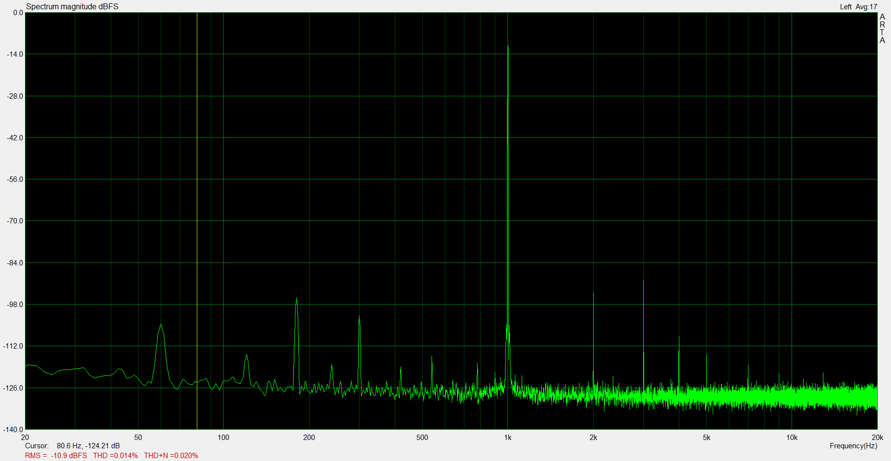

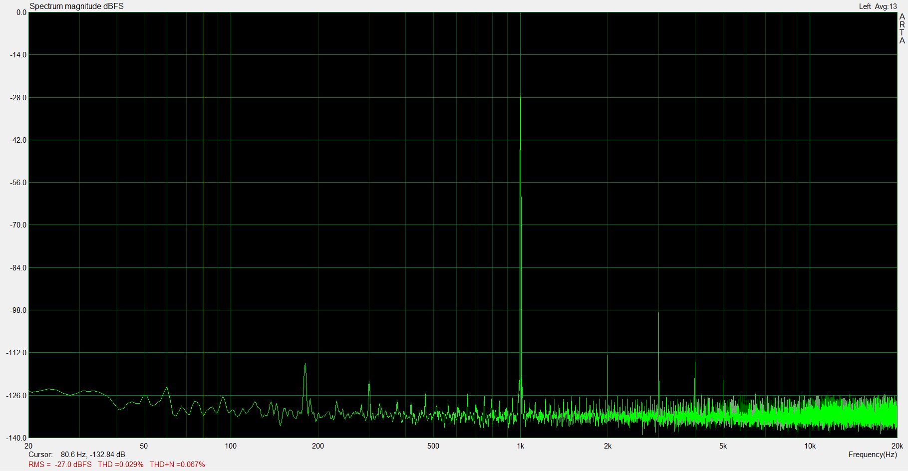

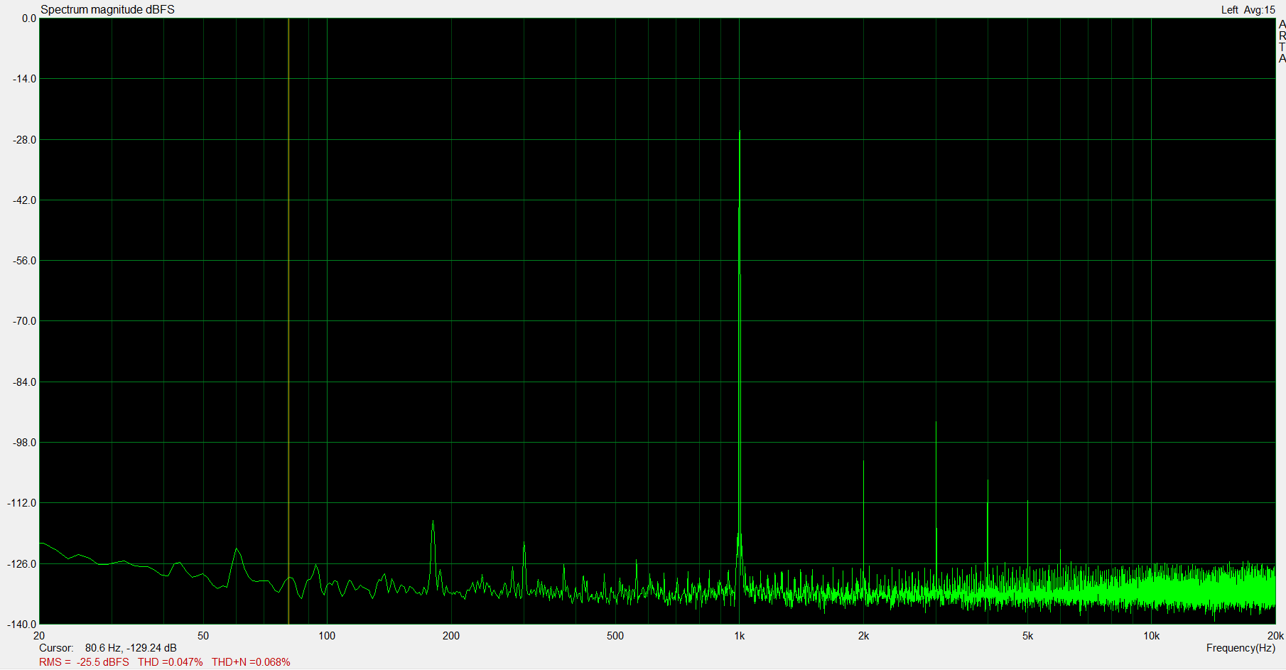

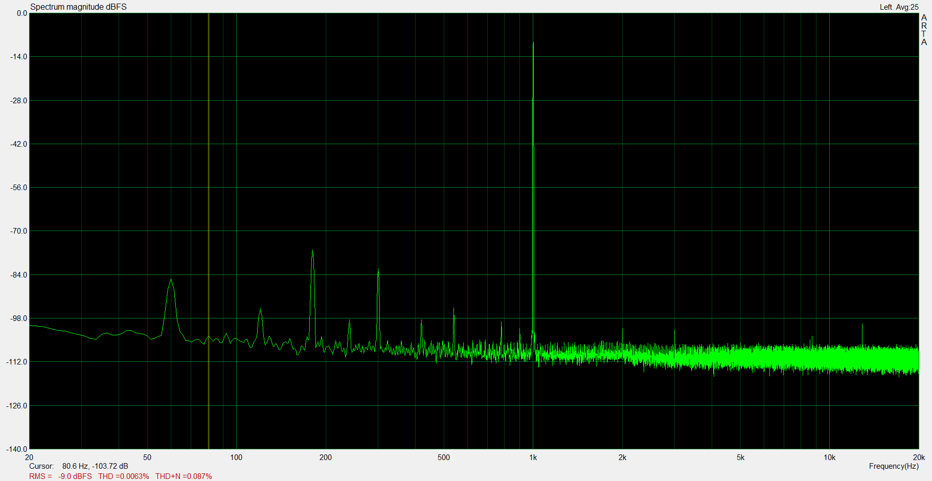

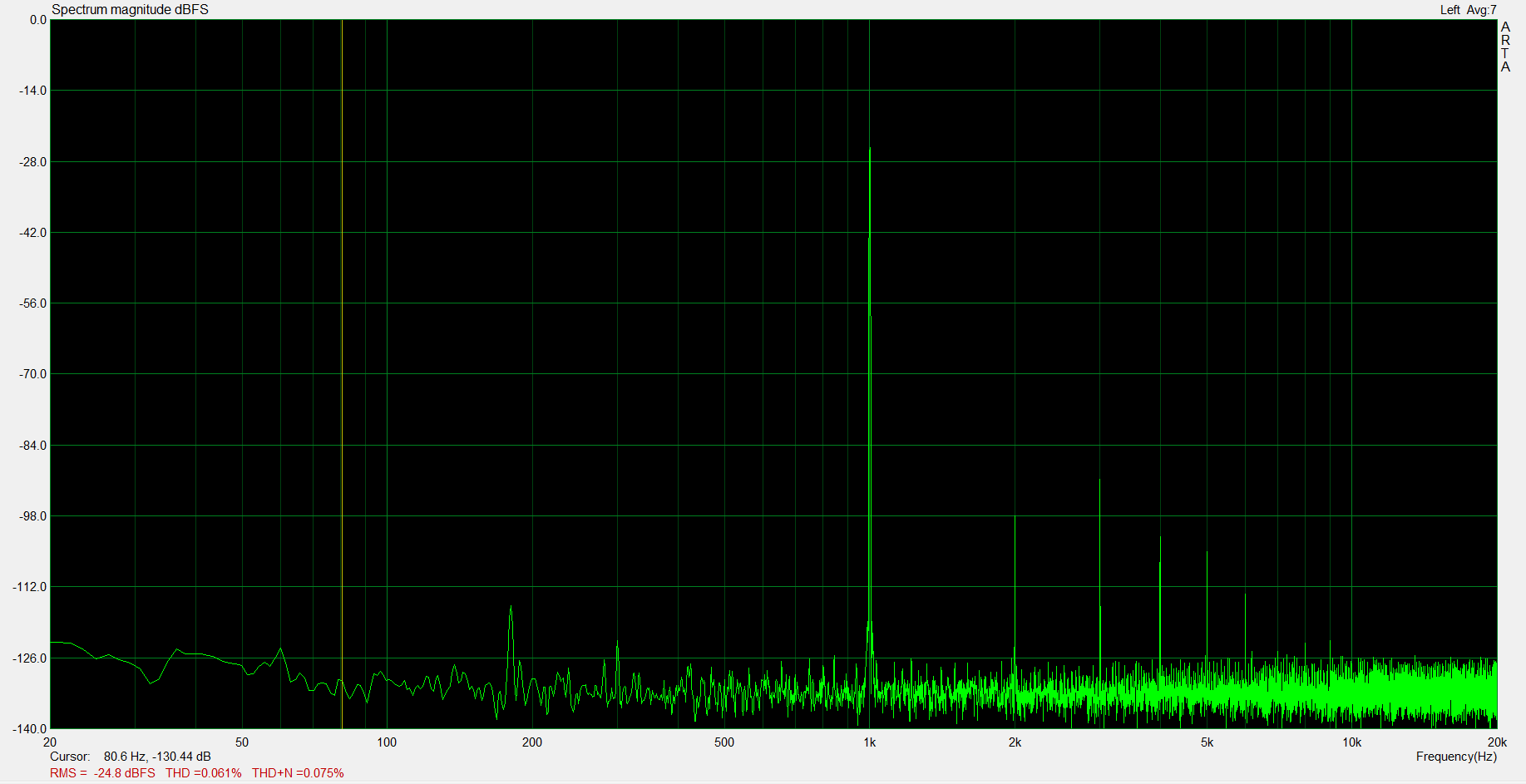

Well, I did get some test time before the trip. Conditions were 1080V B+, 600V plate idle voltage, 35V screen. Here are the results:
10Vrms, .012% THD (buried in noise)
20Vrms, .0063%
30Vrms, .0087%
50Vrms, .0074%
100Vrms, .0099%
160Vrms, .014%
200Vrms, .018%
250Vrms, .029%
300Vrms, .047%
323Vrms, .061%
I expected an increase in distortion since I raised gain to 13.3 (from 10) but a reduction due to the decrease in screen voltage. Looks like the screen voltage reduction had the stronger effect.
In all, I think these are astounding results. At 160Vrms output (the requirement to drive my Unity-Coupled amp to clipping) this approach results in distortion that is two orders of magnitude lower than any triode I have tested at similar output levels.
