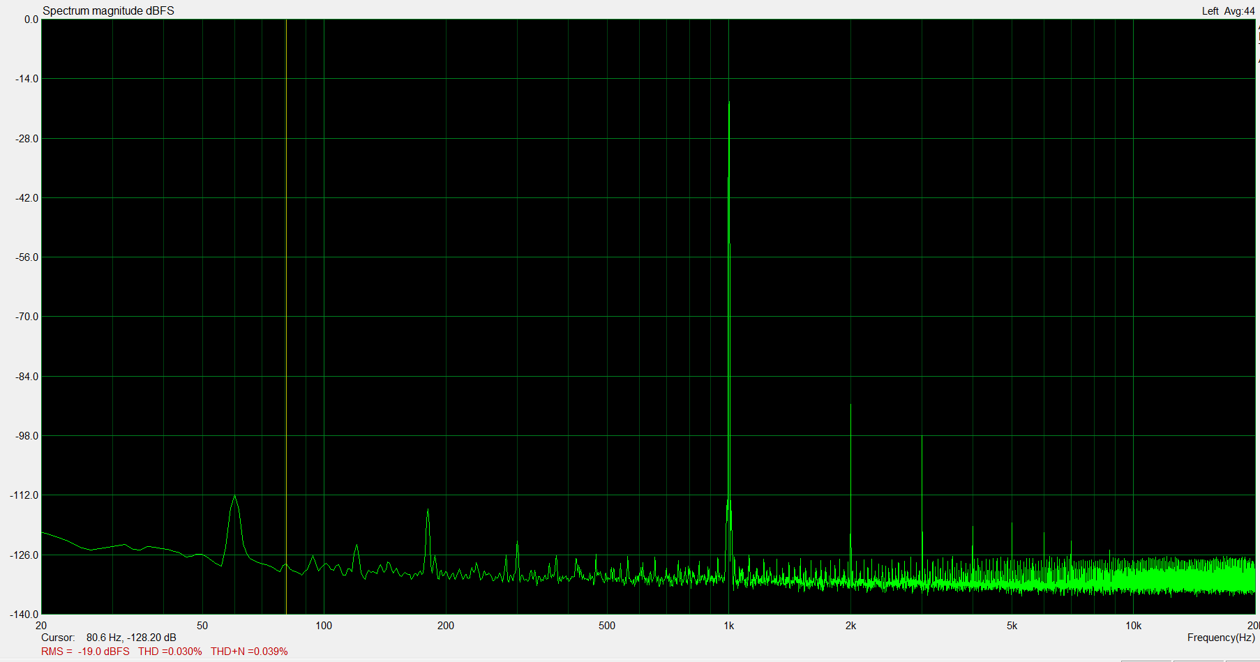

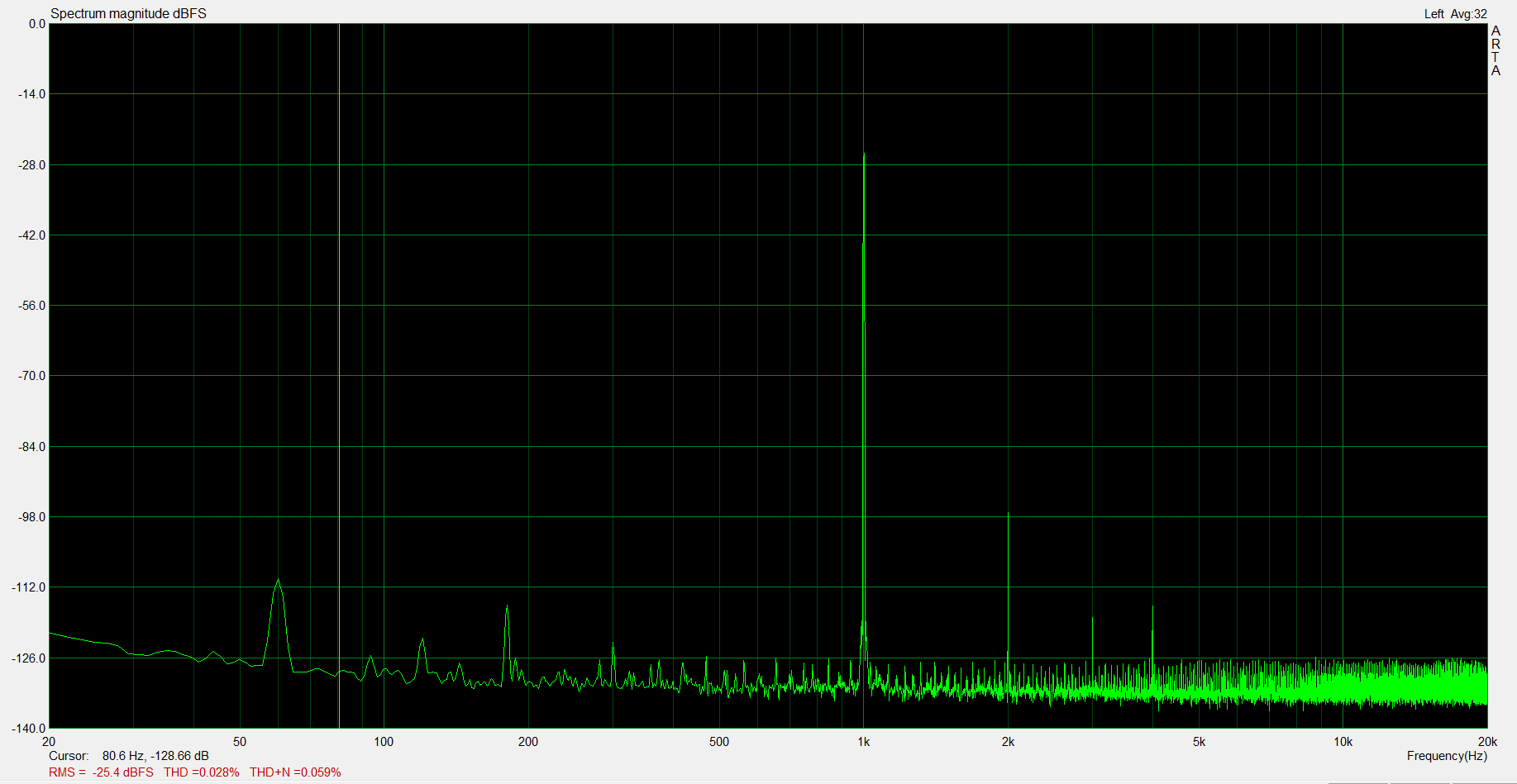

I got the ringing mostly tamed playing with different gate stoppers and did some distortion measurements today.
I tested up to 276Vrms output (spectrum attached). This is getting to the ballpark of being able to drive CF output stages. I can go up further from here without hitting the supply rail but high order harmonics rise rapidly above this level.
This is with ~980V on the B+ and plate idling at ~550V, so I am getting up to within ~40V or so of the positive rail. There is no reason I can't run this with a higher supply voltage. With the power transformer I have, I should be able to do some tweaking and get ~1150V.
If I can eventually get up to ~320Vrms output with this low distortion I'll be happy. Almost there...

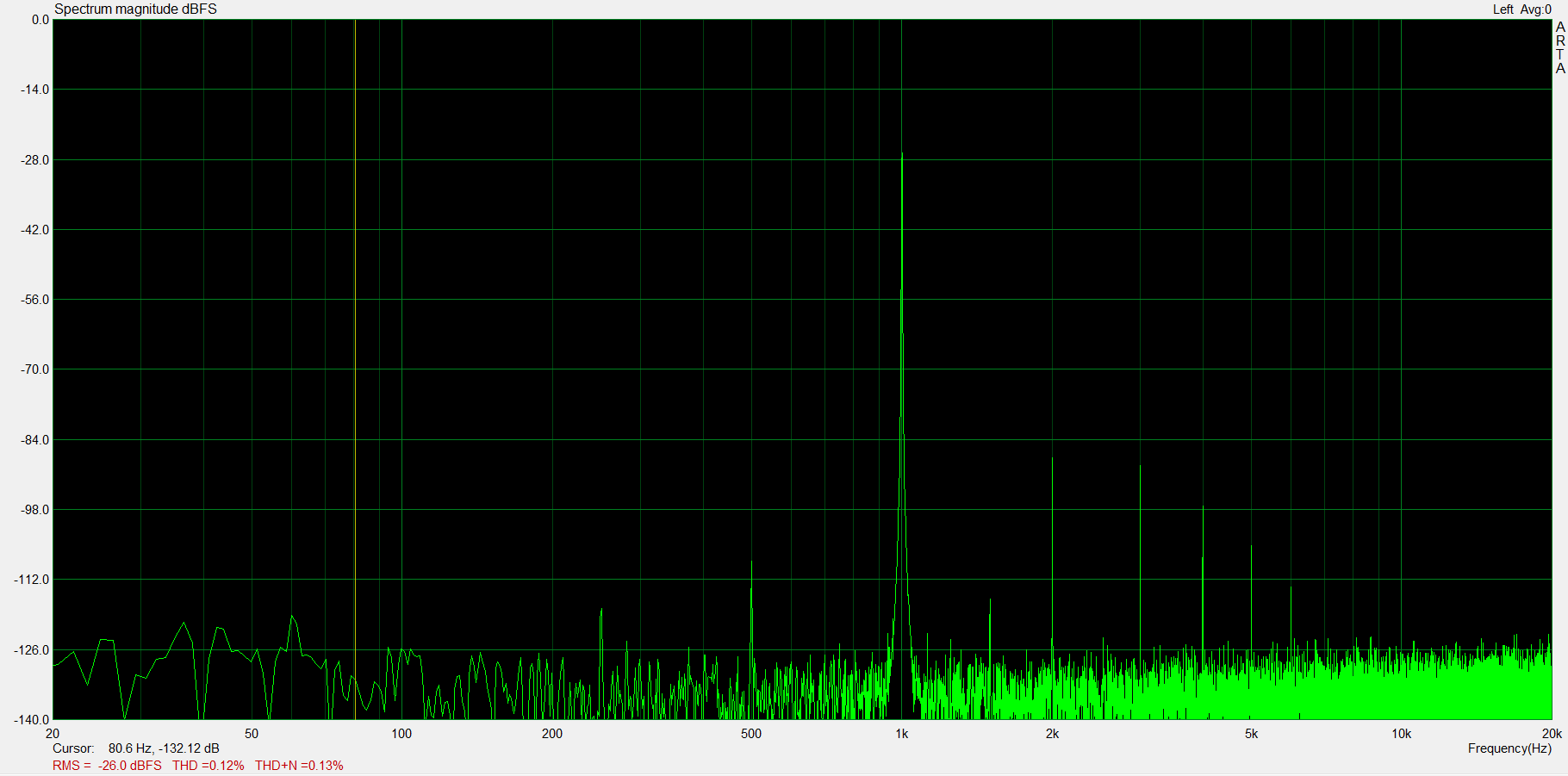

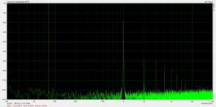

I increased B+ and did some more testing. I got up to 300Vrms with .24% THD after which I got a rapid rise of lots of high-order distortion.
Then I switched to a higher tap on my power transformer and bumped B+ up another 35V or so and I got the same result, onset of clipping at just above 300Vrms.
Then it occurred to me that the ADA4700 was the one doing the clipping, I switched to the ADA4700 output and confirmed that it was clipping at that level. So it looks like a can't test to 320Vrms like I wanted to without building a higher voltage driver and I'm not going to do that just to get that last little bit. I'm calling this acceptable. It should work with a driver that can swing enough and adequate B+.
I think I'll order a pair of SE transformers and build a bench amp and see how it goes.
I have attached results at 285Vrms, 300Vrms, and 305Vrms

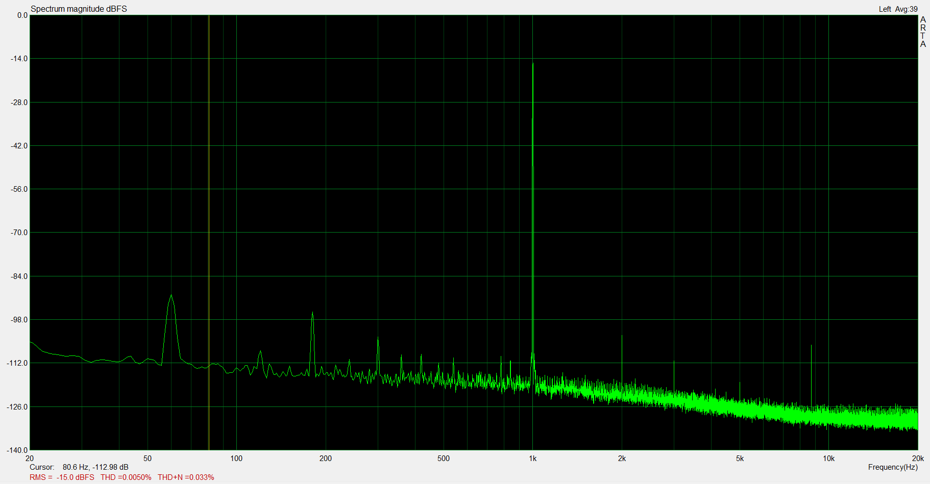

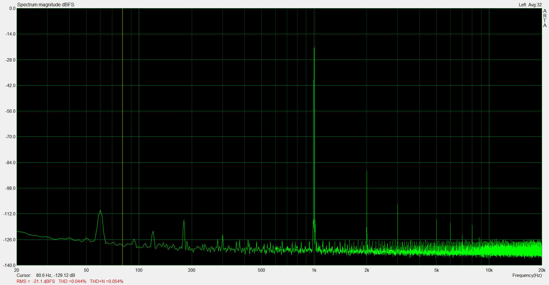

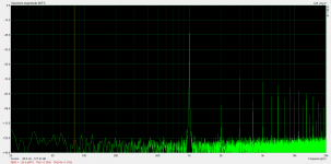

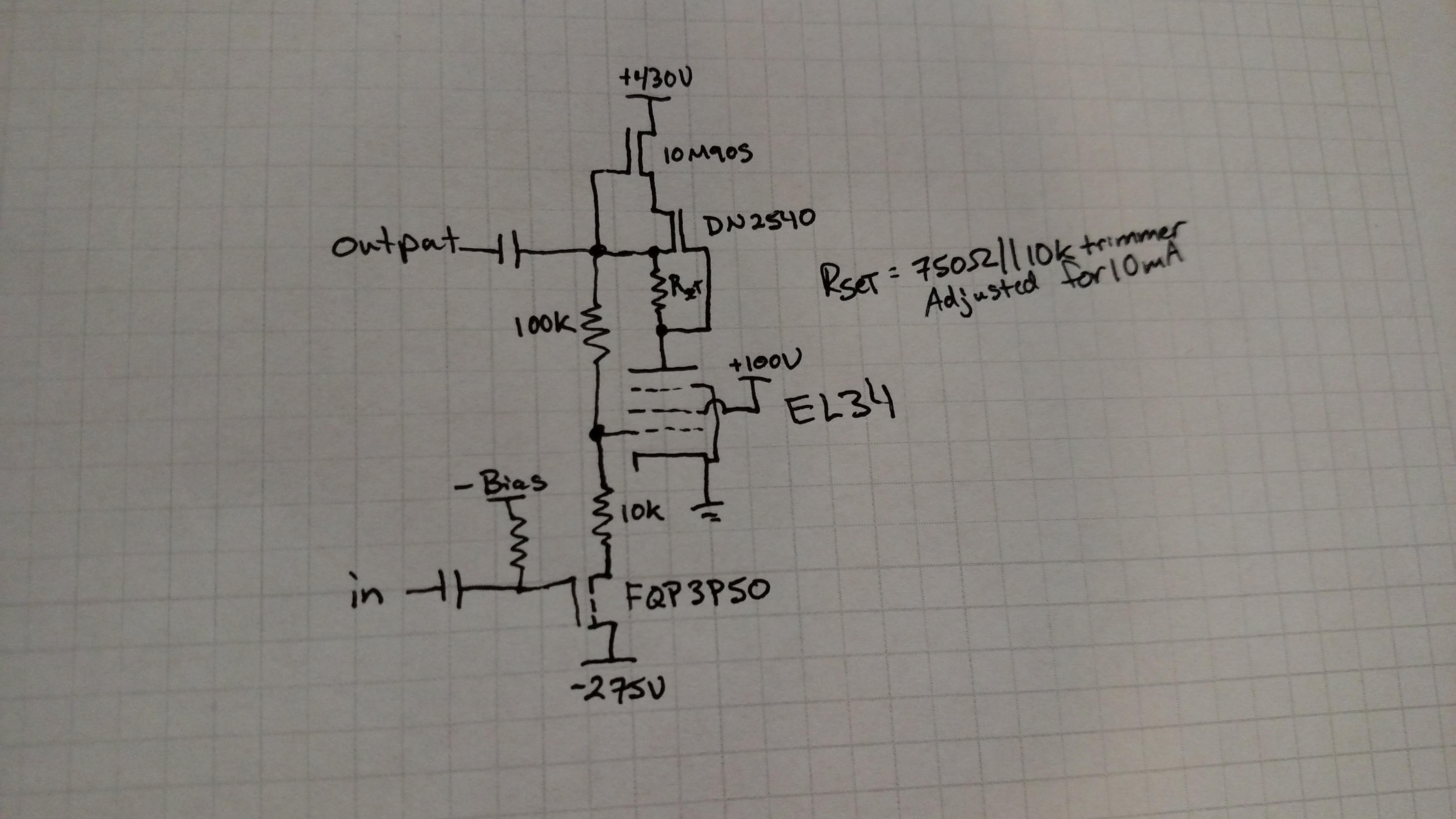

Some time ago I attempted to eliminate the follower that drives the feedback network and drive the feedback network from the CCS "mu" output (the source of the bottom fet). This resulted in a CCS that would no longer function properly. This was with the board with 1500V+ (expensive) parts on it, so I decided to go back to the lower voltage board and experiment some more on the simpler circuit. This time I included protection zeners on the CCS fets (I have omitted them in the past since they seemed to be fine without them).
I ran some tests under similar conditions to earlier tests (in post 35) to see what kind of difference there was with the simpler circuit. Results were as follows:
.014% @ 10Vrms
.023% @ 20Vrms
.028% @ 30Vrms
.044% @ 50Vrms
.075% @ 75Vrms
.12% @ 100Vrms
Results were very similar for all but the smallest levels. There was a bit more second harmonic at lower levels. I consider the simpler circuit to be an overall improvement due to the simplicity factor and the fact that the output is now taken from a point that has more standing current (the current of the feedback network as well as the EL34 itself) so has increased capability to drive downstream capacitance.
Next test is to build up a high-voltage version with protection diodes and see if it works.

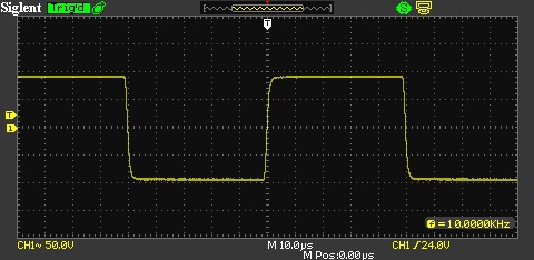

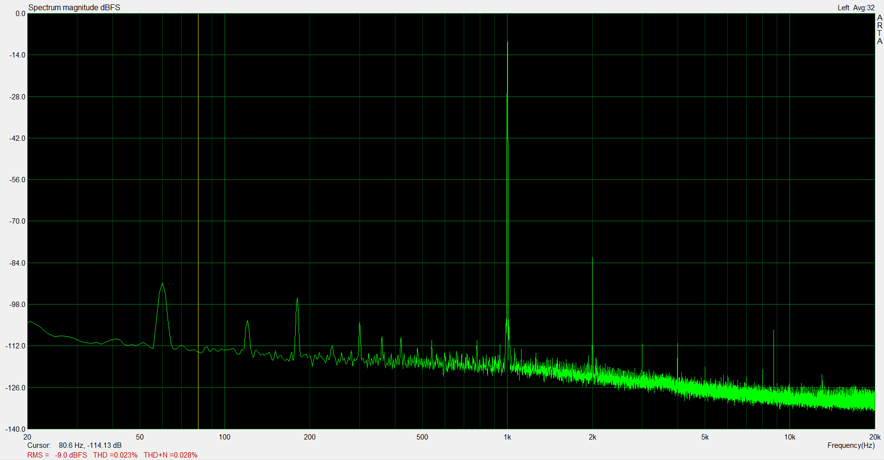

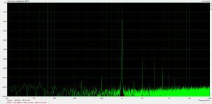

I ran an extra series of tests on the circuit on the post above to show what performance would be if you optimized the operating point a bit for the amplifier we were talking about via PM.
Here is what distortion would look like if you raise the plate idle voltage to 330V or so. That would still give you plenty of output voltage to drive the output stage to clipping. You could use the same supplies for the driver and the output stage. Measurements are for 10, 20, 30, and 63Vrms output.
Of course, you could also use an EL84 with the plate at ~300V and distortion would only be a little bit higher.

I set out experiment today to answer some lingering questions I have had about this circuit. One thing that I have noticed is that distortion is higher at low plate voltages. This makes sense if you look at EL34 (or other tube) characteristics. Curves tend to have variable (and sometimes negative) slope there. So what can be done?
It appears, from looking at characteristics at various screen voltages, that the kinky curves mellow out at lower screen voltages. So was the 100V too high that I was using?
For distortion testing today, I decided to keep plate idle voltage at 200V and vary the screen voltage. Then I would measure RMS voltage output at 0.1%, 0.2%, and 0.3% THD and just see what happens. I did this for EL34 (Electroharmonix), 6L6GC (Winged C), and KT66 (Sovtek). Results are below.

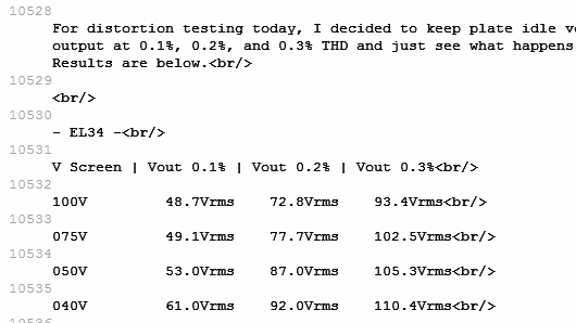

> It looks like the forum software deletes all of the extra white space characters
No, they are there. ("View Source"). Many browsers obey the HTML philosophy of not taking repeated white-space literally.
Dashes or underlines are a 2-thumb typist's easy hack.
The forum formatting surely has Tables, but forum-code tables are even more tedious than raw HTML tables and I never touch the stuff.
{CODE} will sometimes respect whitespace. (Again, may depend on the broswer.)

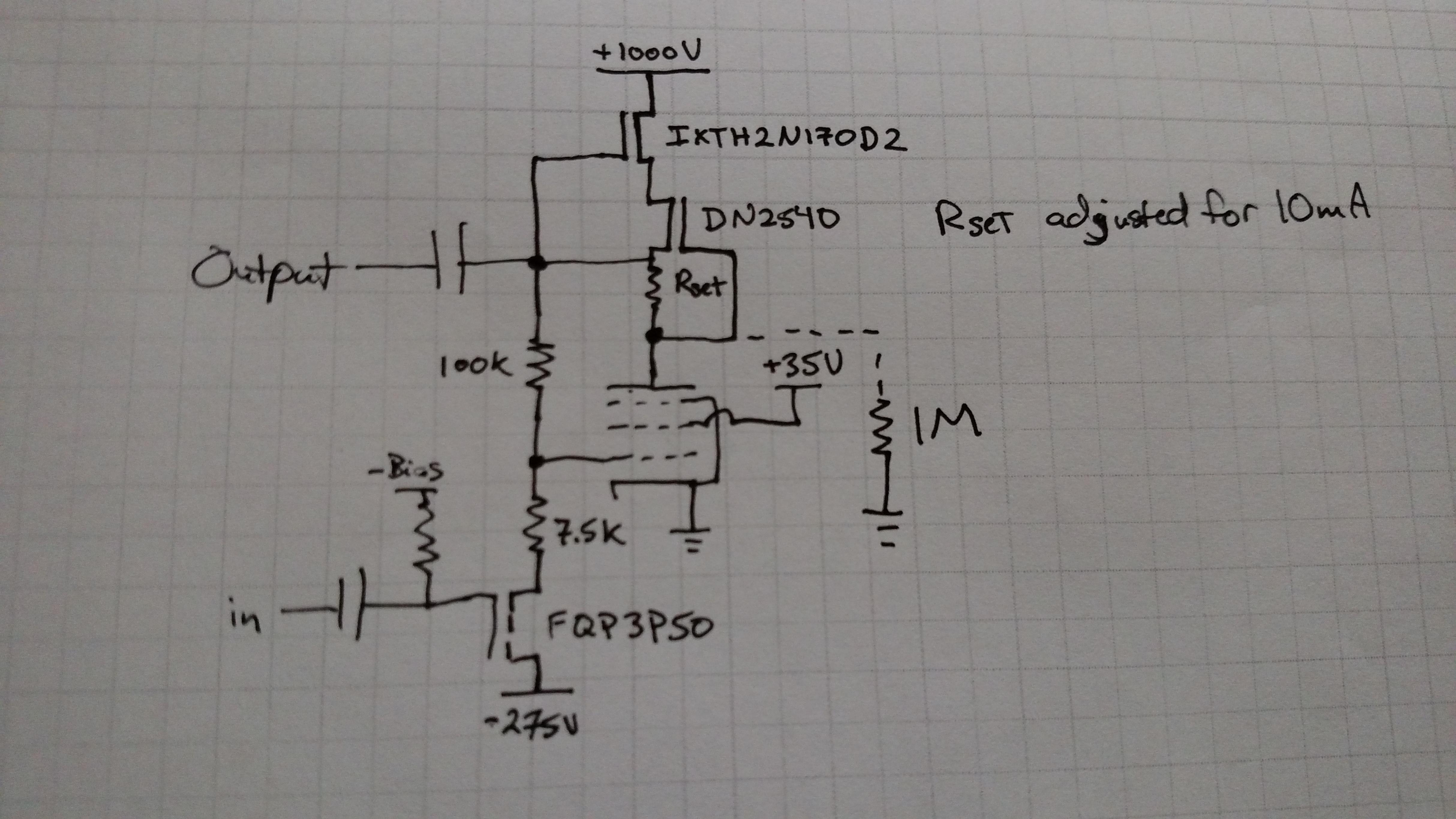

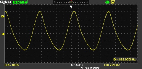

So here is a current schematic of what I am working with at the moment. I increased the gain by decreasing the source resistor for the p-channel fet. I also put an IXYS part on the top of the CCS cascode to handle the higher B+.
I was totally excited to power everything up and prove that it could drive a CF output stage with low distortion and I got oscillations. 🙁
Fortunately I stumbled onto a fix. I started measuring voltages with the multimeter and found that simply connecting the multimeter from ground to the EL34 plate stopped the oscillations. Apparently 1M is enough to do it. I would prefer not to degrade CCS performance by loading the plate directly at audio frequencies so maybe a series RC will do it that only comes into play at ultrasonic frequencies. More experiments to follow. I probably don't have any suitable capacitors so I'll probably have to make an order.
Edit: forgot to add that I am using 500R stoppers on both CCS fets.
