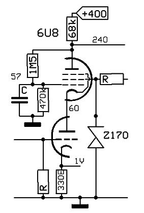

Idea for driver for CF output stage

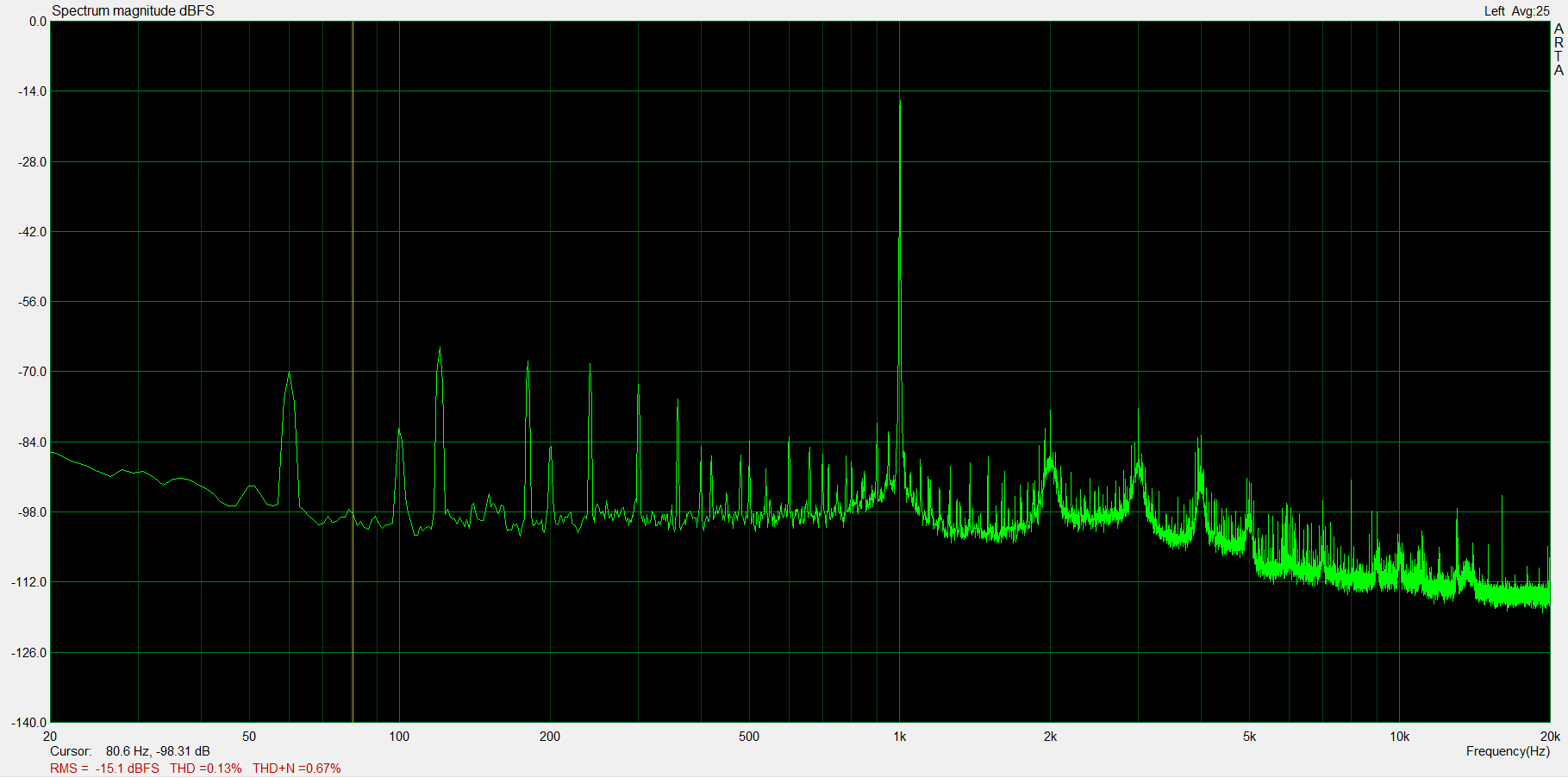

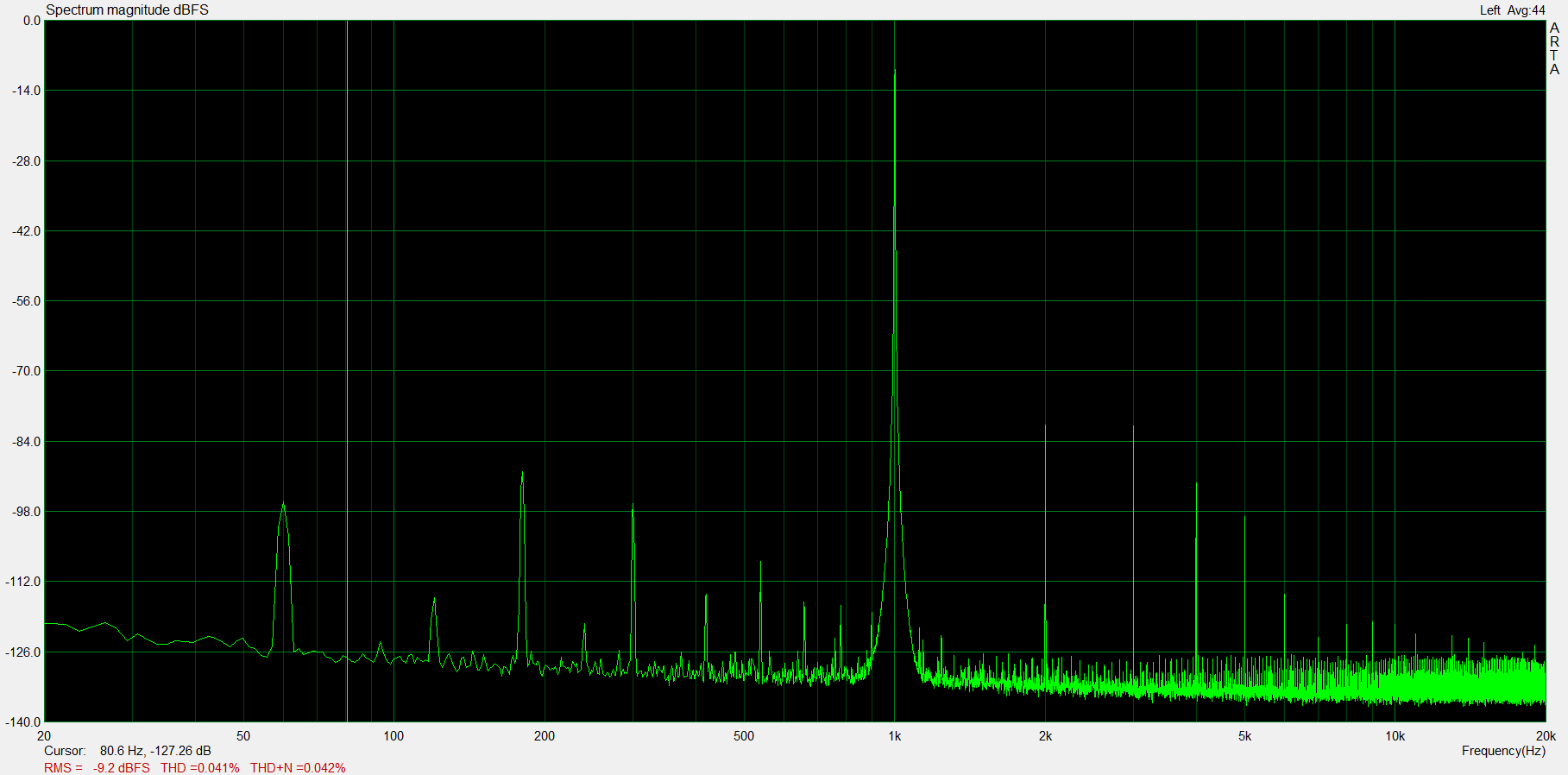

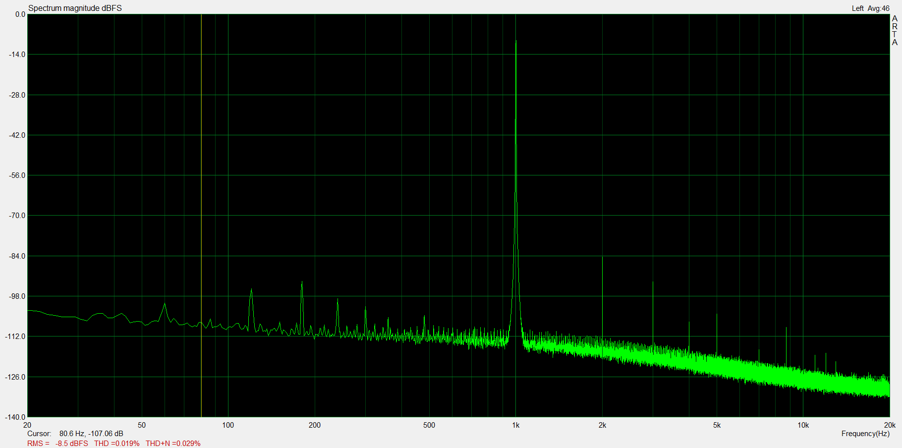

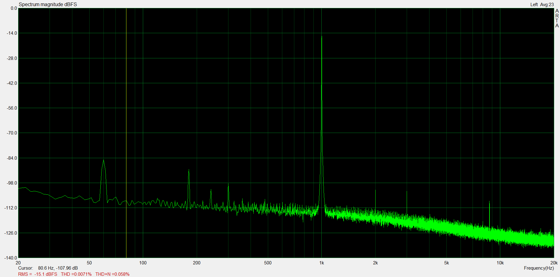

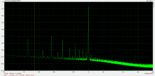

Well, I think I have a good signal generator amplifier for further experiment on this circuit idea. I added some filtering to the ADA4700 to limit bandwidth and suppress distortion a bit.
Attached is the distortion spectrum. Anything above 3rd harmonic is unmeasurable and distortion is <.01% all of the way up to the +-48V rails. This should be adequate for generating drive voltages to drive the EL34 all of the way up to where I want to test.
Next step is to construct the higher voltage B+ for further experiments with the EL34.
Note: the ~8.7k peak is some artifact of my measurement setup and is always present even without signal.

For filtering, I simply put an 820pF capacitor in parallel with the 100k feedback resistor to give a cutoff frequency of 2kHz. I could probably do a bit better on harmonic suppression with a bit more capacitance but I'd have to be prepared to drive it a bit harder as it would start affecting the amplitude of the fundamental more if I did that.
For the supplies, I used two cheap 48V medical wall-wart types with isolated outputs and stacked them. They were made by Meanwell. I didn't even use local bypass caps near the op-amp, which would definitely be good practice, but noise floor seems very low as-is.
As far as layout goes, you can see that in post #19. The only thing that has changed since the picture is that I hung a capacitor from the resistor on the right. As you can see, layout is not particularly tight. I had to bend leads and flip the chip so that I could put an improvised heatsink made of a couple of wires on the pad. It seems adequate. The op-amp has a thermal shutdown feature and I haven't seen it engage, but then again I haven't left it running at full amplitude for long periods of time. The only thing that has changed since the picture is that I hung a capacitor from the resistor on the right.

Just for kicks I put an EL84 into the circuit and drove it to 19Vrms to see if it would make a good input tube. Here are the results:

I'm using the Mosfets in the EL34 circuit just really to see how low distortion can be on an EL34 with CCS load and so-called "Schade feedback." Most of the Mosfets can be replaced with tube followers if one desires, except the p-channel fet.

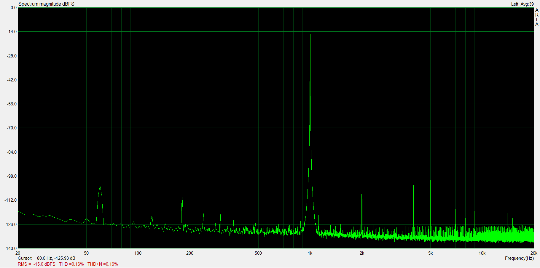

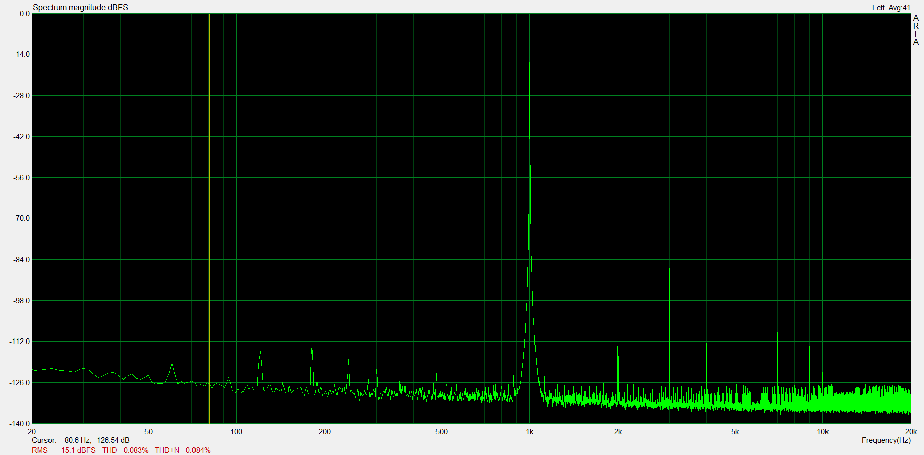

After testing bandwidth, I hooked the ADA4700 up to the EL84 to do some higher output distortion tests.
Results:
.0084% @ 10.7Vrms
.019% @ 21.6Vrms
.027% @ 30.6Vrms
.049% @ 50.7Vrms
.060% @ 75.4Vrms
.083% @ 101.1Vrms
I'm very pleased with these results.

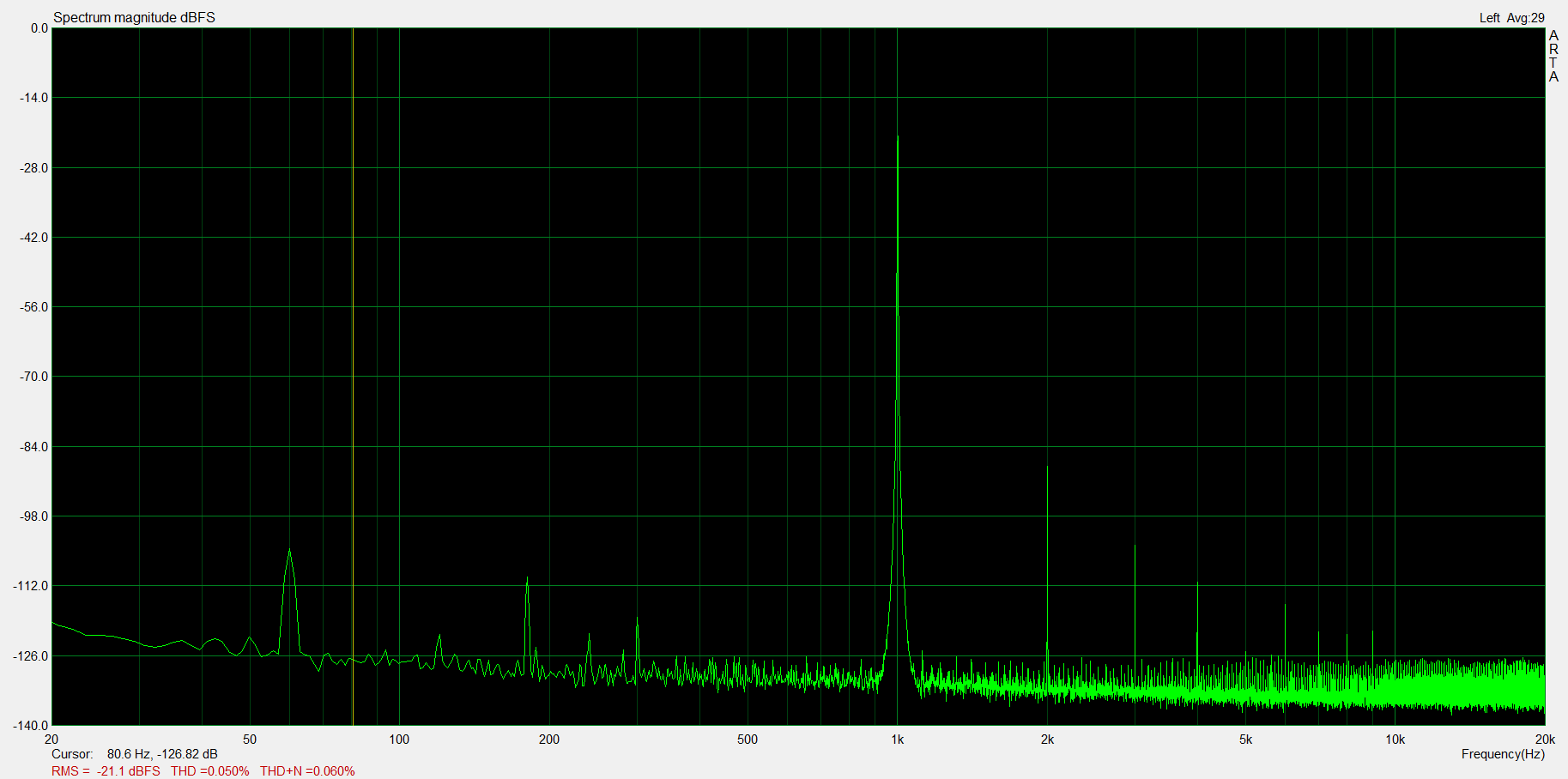

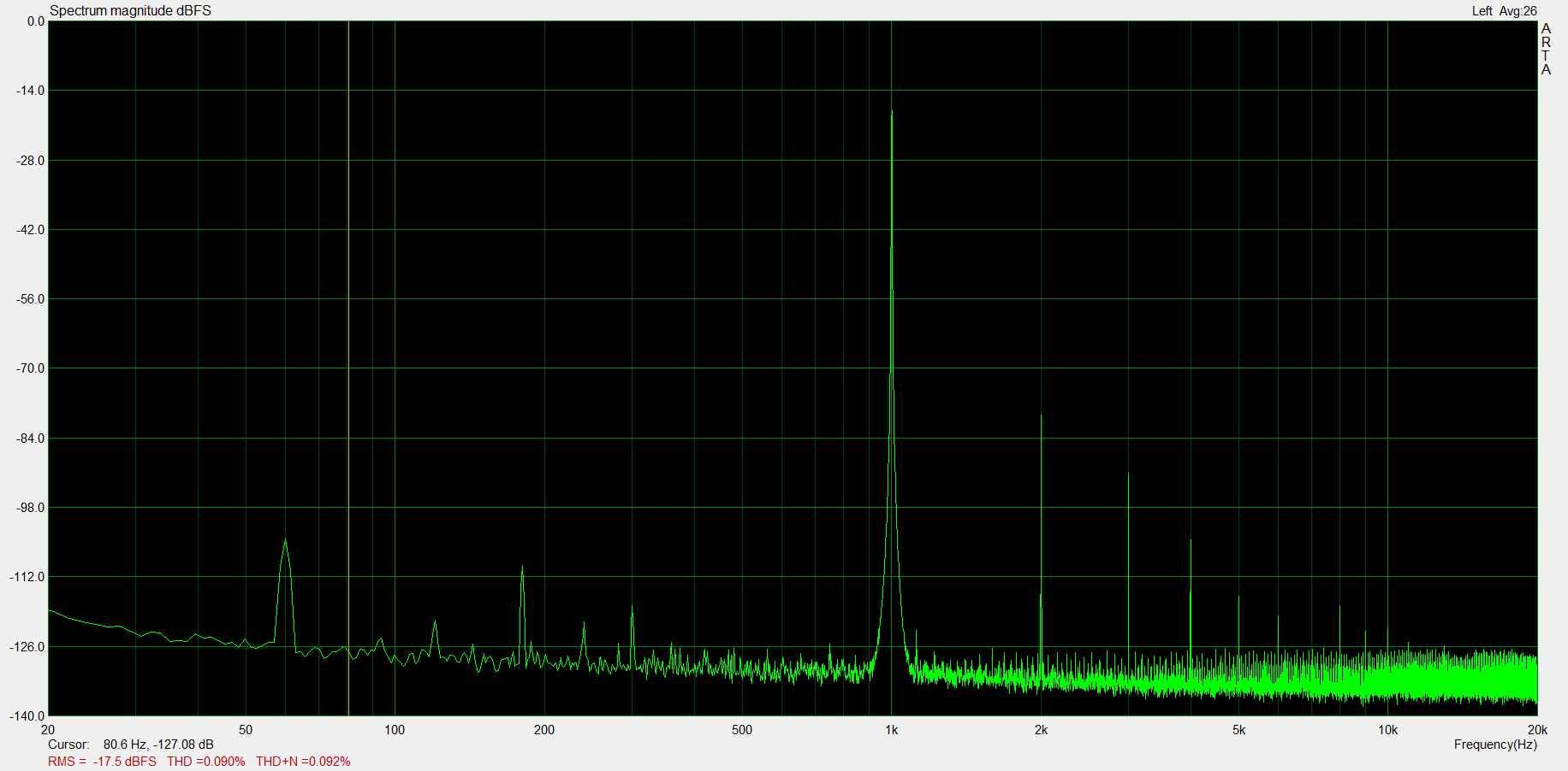

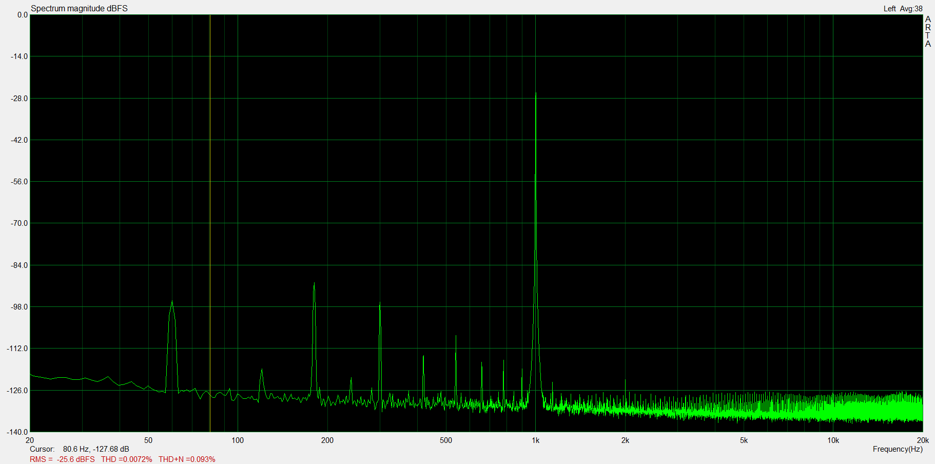

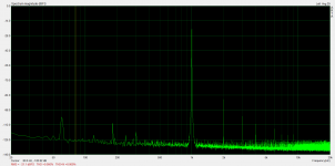

I did another round of testing similar to what I did for the EL84 on the EL34. What I did was set the idle plate voltage to give minimum distortion at 100Vrms output. Then I measured distortion at that and lower levels. Here are the results:
.0071% @ 10.0Vrms
.0098% @ 20.2Vrms
.023% @ 30.2Vrms
.050% @ 50.1Vrms
.090% @ 75.7Vrms
.16% @ 101.6Vrms

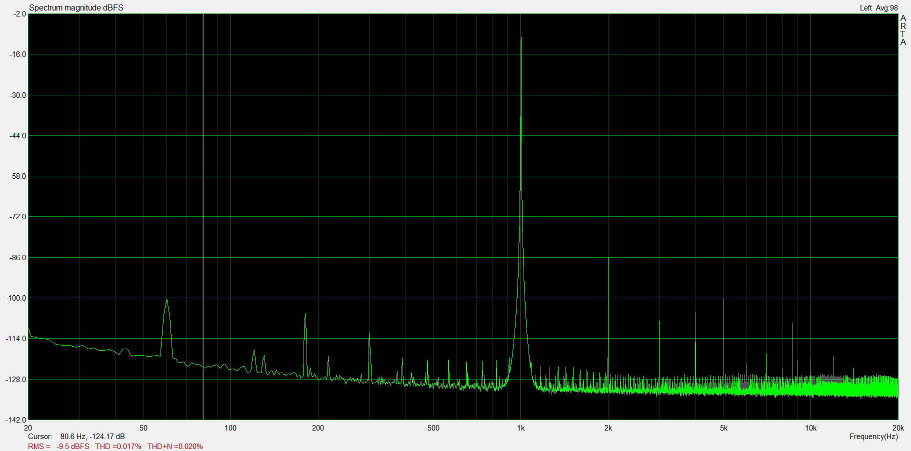

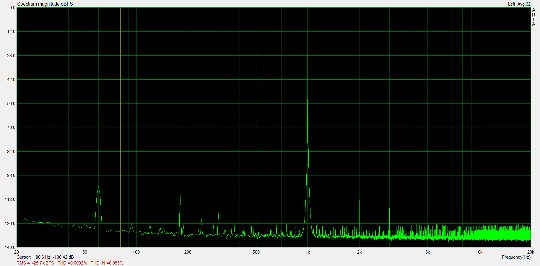

After that test I decided to tweak settings to see what would affect distortion. First I started by varying screen voltage. I saw pretty much no change in distortion from 80V to 150V on the screen (and changing bias to keep plate idle voltage the same). That surprised me. I figured that varying screen voltage would make a difference. I prefer to keep screen voltage somewhat low since that reduces the necessary negative bias on the gate of the p-channel fet.
After I did that, I varied idle plate voltage with a 30Vrms output signal to see where in the plate voltage range was most linear. It turned out that setting the plate voltage as high as possible without clipping minimized distortion. I have attached a distortion measurement at 350V idle plate voltage and 30Vrms output. .0092% distortion with a nice waterfall harmonic characteristic. I can't wait to see what happens when I construct a supply that is capable of swinging large output voltages from that and higher operating points.
I now have all of the parts that I need to construct the 800-1000V variable supply to test the EL34 to voltage outputs that should be capable of driving a CF output stage, so those test results should be coming soon.
I hope I'm not counting my chicken before it hatches but this circuit may also end up as a substantial upgrade to the 841 driver in my Unity-Coupled amp.
Edit: Keep in mind that my driver amp is putting out ~.009% distortion, so I really have no ability to really measure the distortion of the EL34 here at this operating point. It appears to be very low, whatever it is.

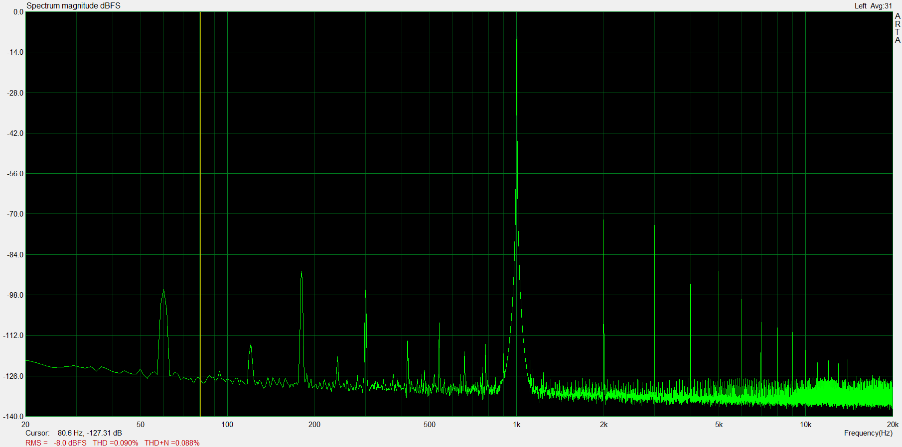

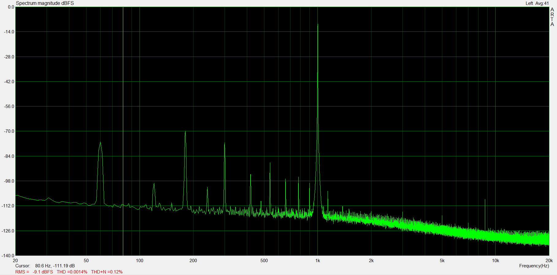

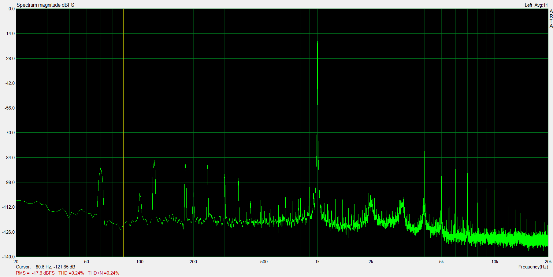

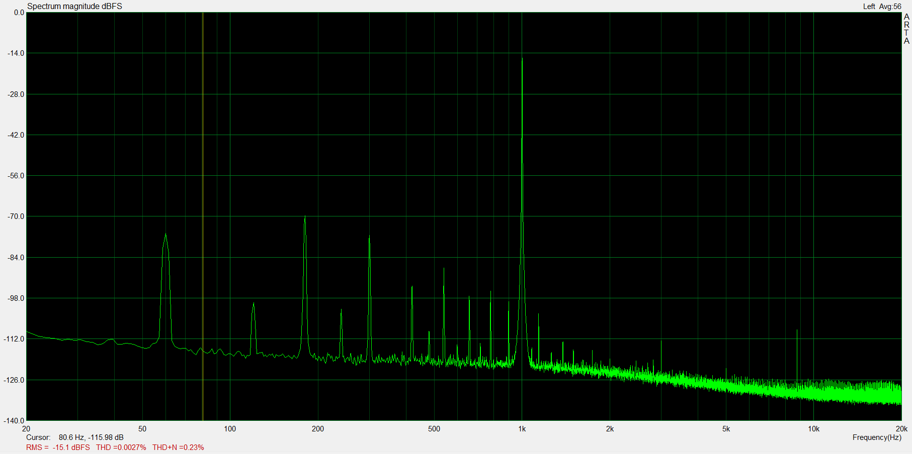

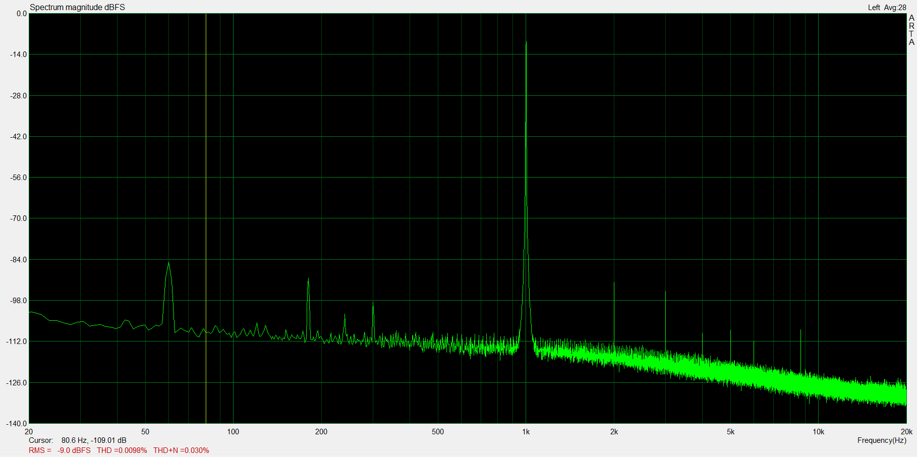

I finished the HV power supply and set it up for 800V (I am waiting to go for the full 1000V because I currently have 900V upper FETs in the board). I set the EL34 plate idle voltage at 450V.
I got what I consider to be astoundingly low distortion for these voltage swing levels.
.0027% @ 10Vrms
.0014% @ 20Vrms
.0072% @ 30Vrms
.0047% @ 50Vrms
.0041% @ 75Vrms
.0057% @ 101Vrms
.041% @ 200Vrms
.090% @ 230Vrms
I will attempt 300Vrms when I get the 1500V CCS/FET driver board built up with 1000V B+.

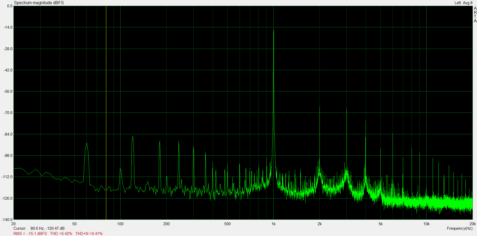

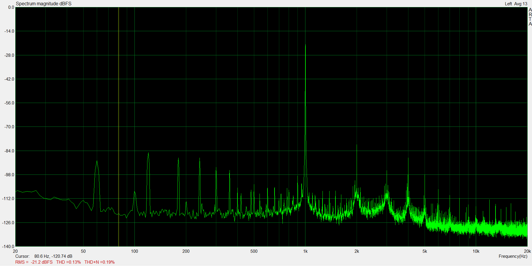

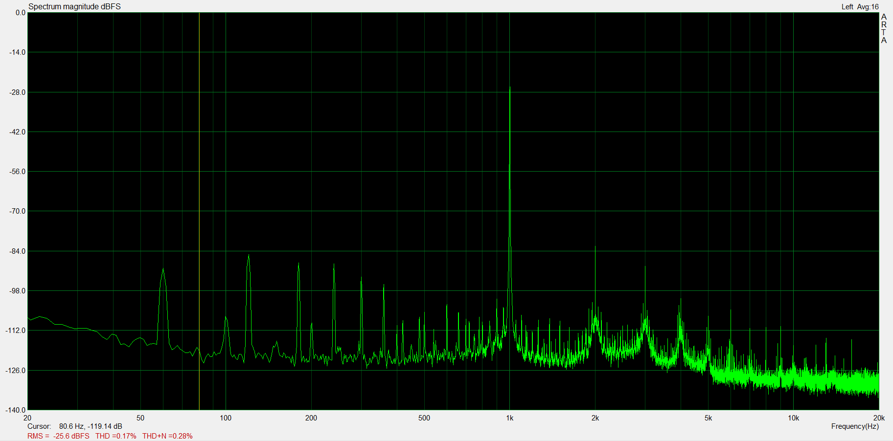

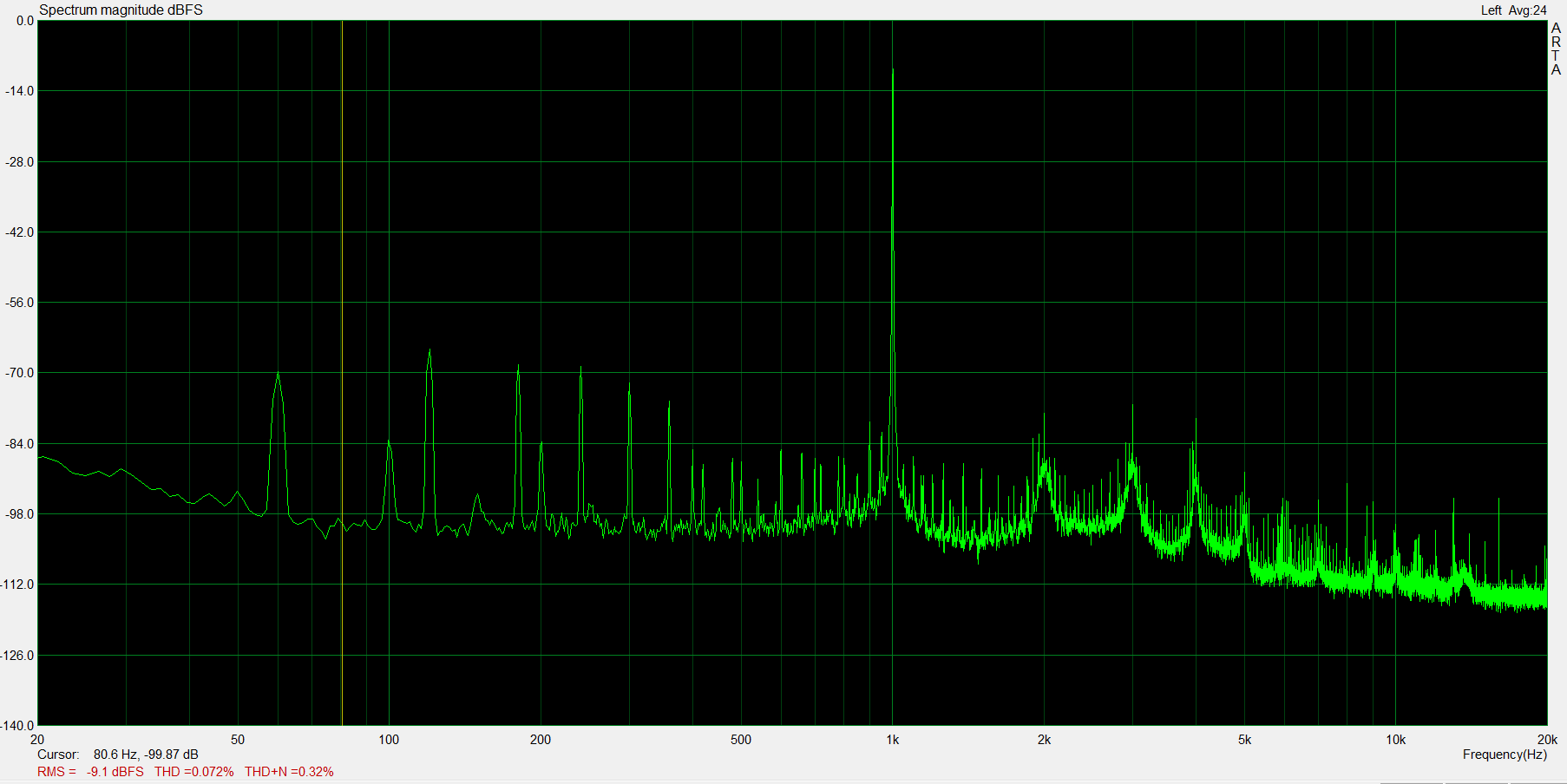

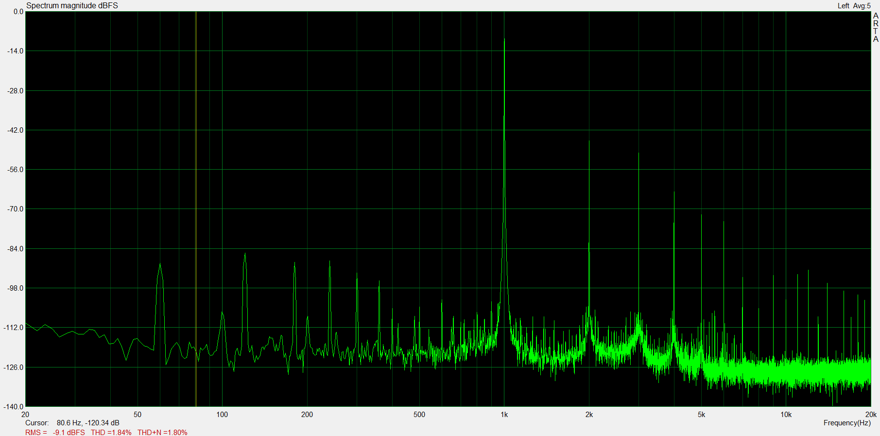

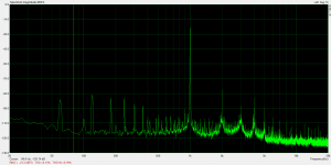

I took some measurements from the 841 stage in my Unity Coupled amplifier for comparison.
.13% @ 10Vrms
.072% @ 20Vrms
.17% @ 30Vrms
.13% @ 50Vrms
.24% @ 75Vrms
.42% @ 101Vrms
1.84% @ 200Vrms
These aren't exactly apples to apples since I measured this in-circuit and on the EL34 test setup they are being driven by a cleaner source and have a lighter load.

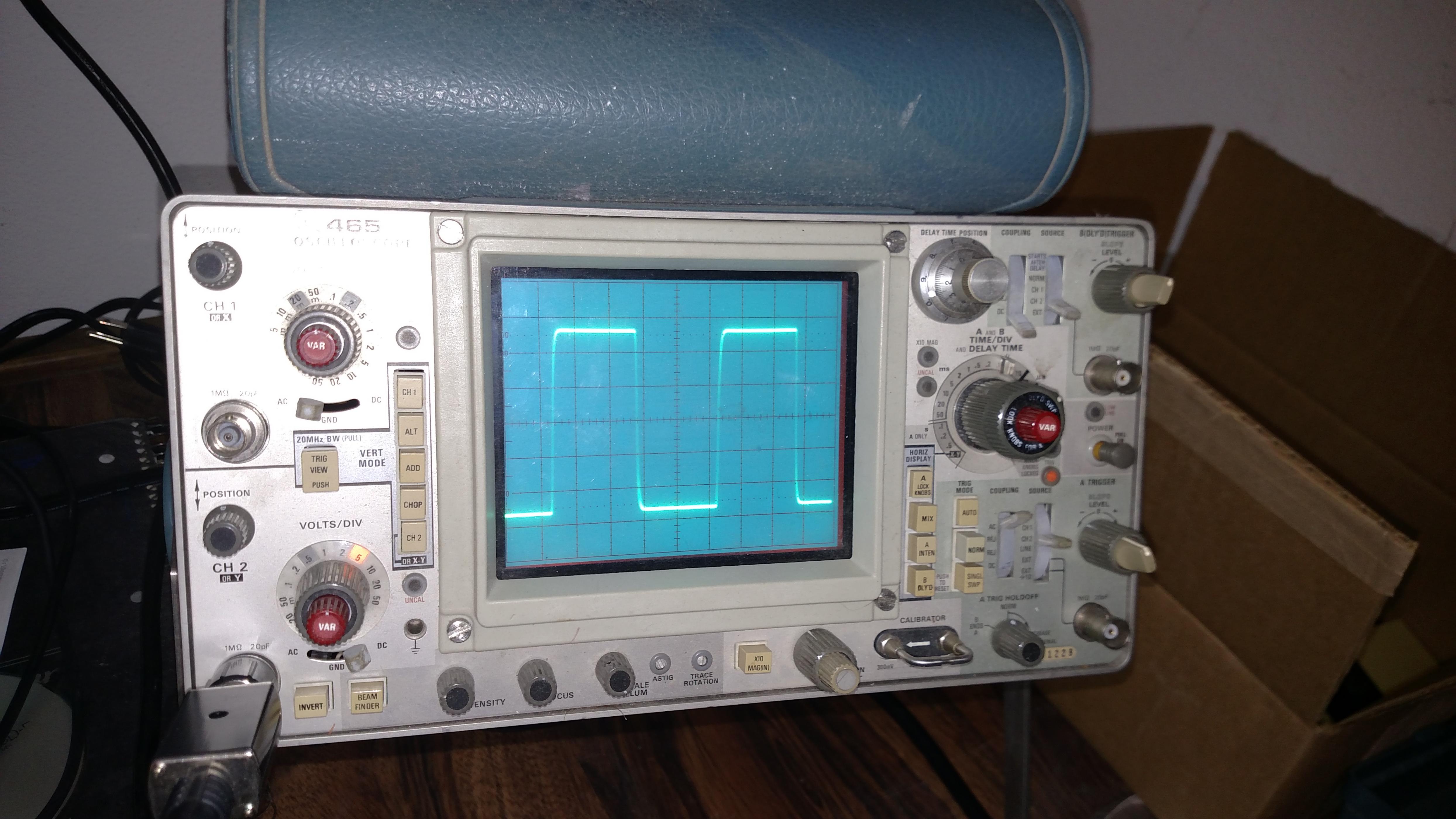

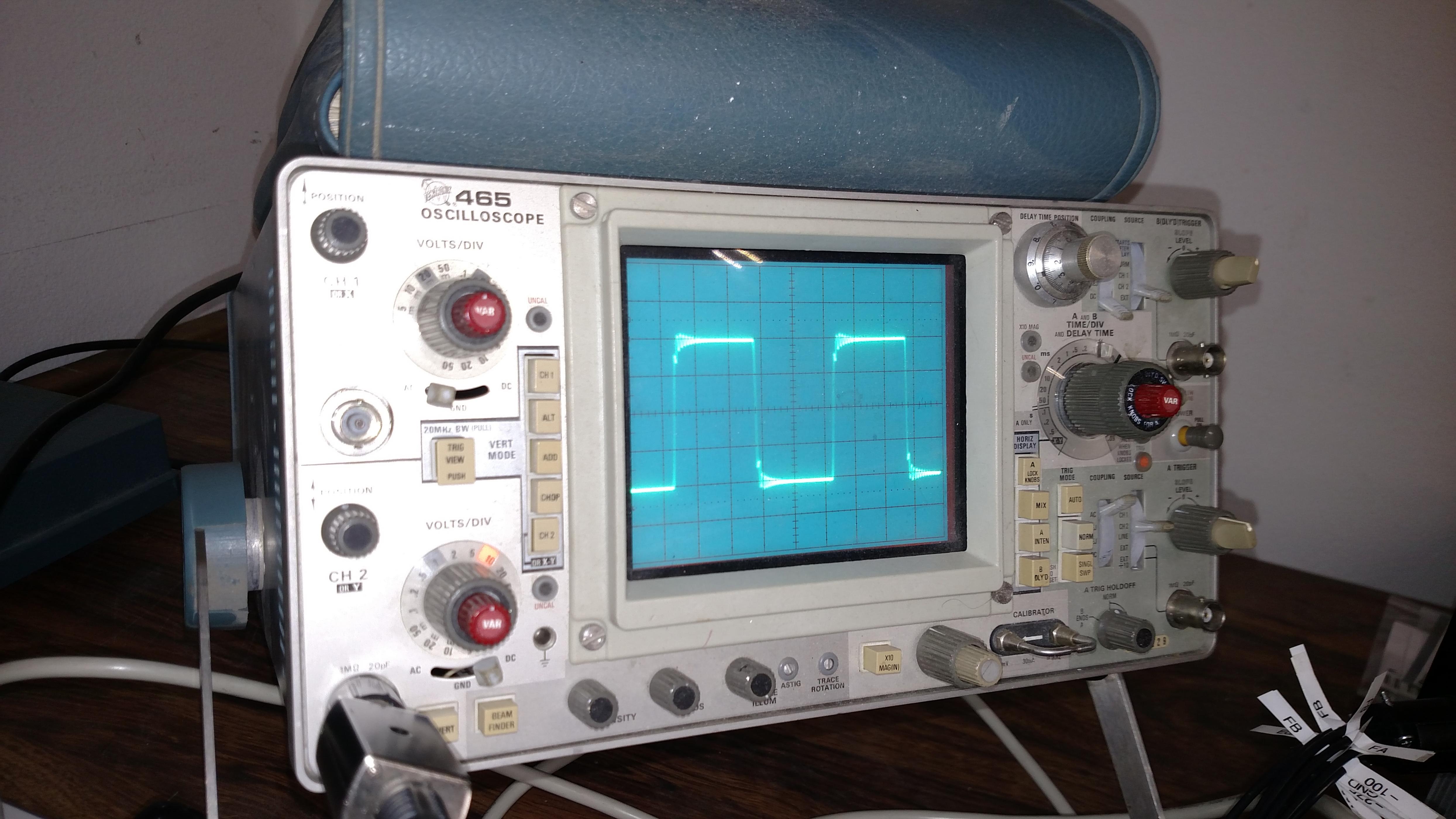

For the CCS I ended up using an IXTH2N170D2 (replaces 10M90S) as the upper device in the cascode and I used an STW4N150 (replaces FQP2N90) for the follower for the plate feedback. This gets me from 900V max rating to 1500V (1700 for the CCS).
I just did some bandwidth testing just now with the new parts and the circuit was 3dB down at 375kHz.
I have attached an image of a 20kHz square wave and as you can see there is ringing this time with the new parts where there was none before. The frequency of the ringing is ~1.1MHz. I'll have to order some parts to try to tame it.
