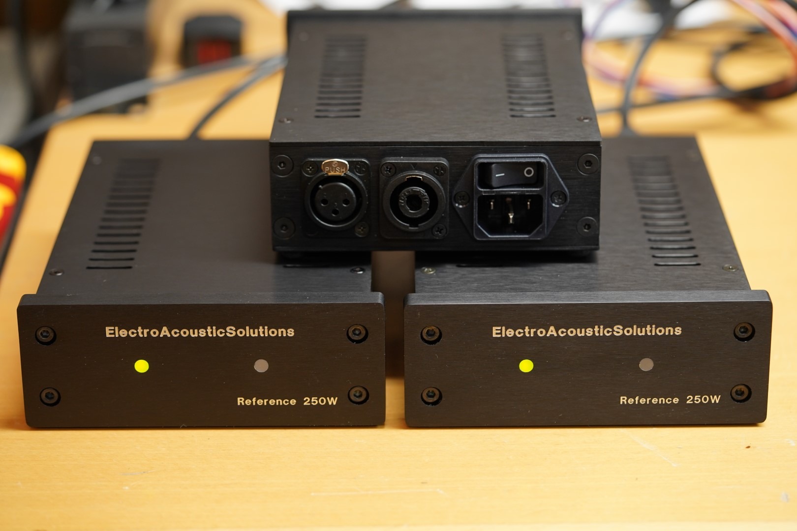

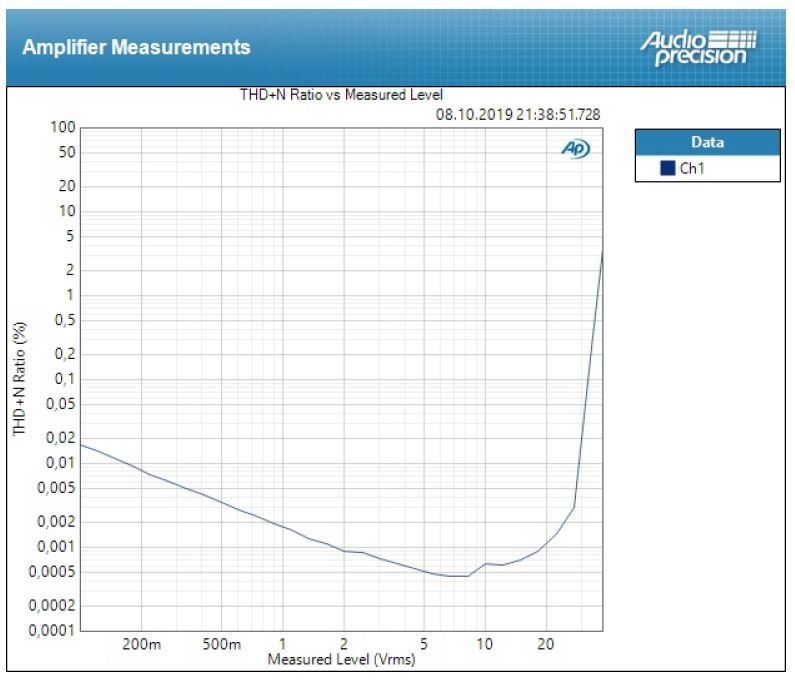

I use the Hypex NCxxxMP modules a lot! These are the sweetspot of digi amps for me. Very easy to handle, robust, "cheap" and neutral sound. You can easily change the gain of the input buffer with one resistor, even change the OPA to opa1612 for e.g.

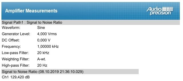

I got a S/N of 129dB(A) with a NC250MP. I'm sure that's VERY close to a Purify setup and way easier to handle.
I really like the sound descriptions here - that's exactly the experience I had. Transparent AND smooth at high frequencies, no distinct character. I have the impressin that many people who don't like switching amps never heard a good Hypex/Purify amp - these are really good.

Yes! I like to reduce to 20dB cause i often use them for measurements and then "calculation" of output voltage is easy ;-)Did you reduce the gain to achieve that?
This was for pressure measurements, it needed to be able to go from DC with maximum dynamic range (129dB still was not perfectly enough - but I could not do more quickly).
NC100HF have a better S/N for 2-3dB - so they are great for high sensitivity tweeter. What tweeter do you use? I never ran into problems but either use HiFi tweeters or higher impedance PA drivers (to get less noise).The NCxxxMP modules are great! I have them all over my system. The NC100HF hanger module is a bit too weak though. Can’t drive my 3ohm tweeters properly.
