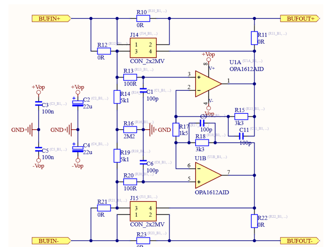

You say you use it without a buffer.... How can you bypass the Audiophonics LM4562 buffer/gain? Did you change the OPAmp feedback value (resistors)? The minimum gain of that stage is 7.2dB, which is a lot when combined with the 13dB gain of the module itself, especially if used with modern sources that have 4V RMS out.
I would definitely not recommend no buffer at all, though.
I simply ordered it bypassed with 13dB of gain, so honestly I don´t know how they do it precisely, apart from the fact that physically it is a jumper solution.
My source is a low impedance DAC with a lot of RMS out (RME ADI-2 pro AE), cables are short, and it works very well, so what might there be to be gained with the buffer? No offense intended, just like to learn!

The 1ET400 without buffers needs close to +22 dBu (10V RMS) input for a full 400W/4ohm output. Not many DACs or preamps can do that.
The input impedance is very low... only around 2-3k. However, if you are happy with the result, that's all that matters really.
I drove it bypassed with nos pcm63 dac. No issue, no noise, hum. Keep cables short. Sound wise, you need to hear. I do kind of like it bypassed, better than with opa1612 oboard buffer, but likes it better with burson v6c. So new buffer board is inbound.
The noise must be somewhere else in your system, the build or it's a faulty buffer. An OPA 1612 and LT3045 is not going to add noise. Attached circuit. Just not going to happen..I've tested the Purify Eval1 kit. It sounds very clean, but the buffer stage is way too noisy with high efficiency drivers. I could clearly hear noise in the listening position with 100 dB horn tweeters. Any Hypex nCore amp is dead quiet. I have ICEpower 2000AS for my subwoofers, and they are great. Tons of power and super tight sound.

That makes sense, and I was very surprised by the noise we heard with the buffer. The noise was still there with the input disconnected, and even with the inputs shorted. When the buffer was bypassed, it got dead quiet.The noise must be somewhere else in your system, the build or it's a faulty buffer. An OPA 1612 and LT3045 is not going to add noise. Attached circuit. Just not going to happen..
We had two EVAL1 kits, both behaving the same way. I did not assemble it myself, so my friend who did could have done something wrong. We had a Hypex SMPS on both kits. As you say, either faulty buffers or something with the build.
