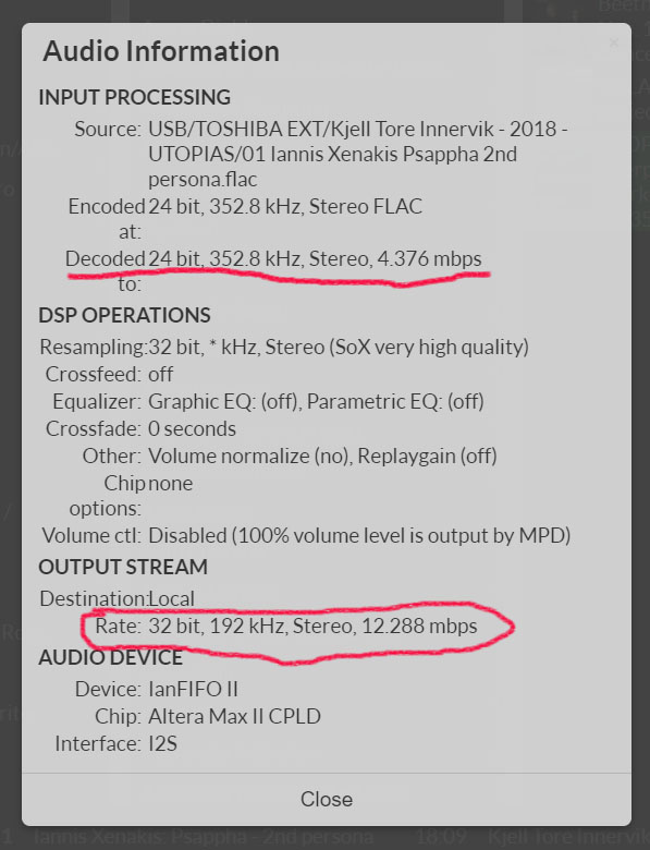

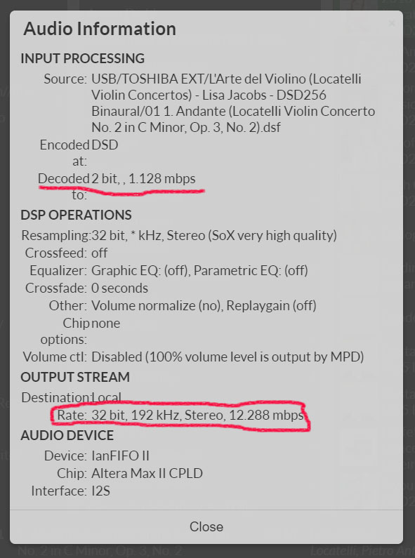

I have sussed the noise issue....it only does it on the 2 highest SOX sampling rates....32bit 352 and 32/384. All other rates work fine.
This may mean something to you guys!
Hi guys,
I have the same kind of problem with fifopi (45/49) and 9038q2m dual mono.
Using IANFIFO II driver in Moode, I can't output higher than 32/192
(If I use audiophonics 9038 driver, I can output up to 32/384 but I get a lot of noise.)
Does some of you know a fix for this problem?
Thanx

Hi, thank you for the help.
I just tried:
- generic1 i2s(hifiberry) outputs at max 32/192
- generic2 i2s(rpi-dac) outputs at max 24/192
- audiophonics outputs max at 32/384 but I can’t play dsd128 and Dsd256 dop, because of a lot of suttering.
I had the same problem with ian isolator and allo katana where the max output is 32/176 for dop dsd playing.
Any ideas why?

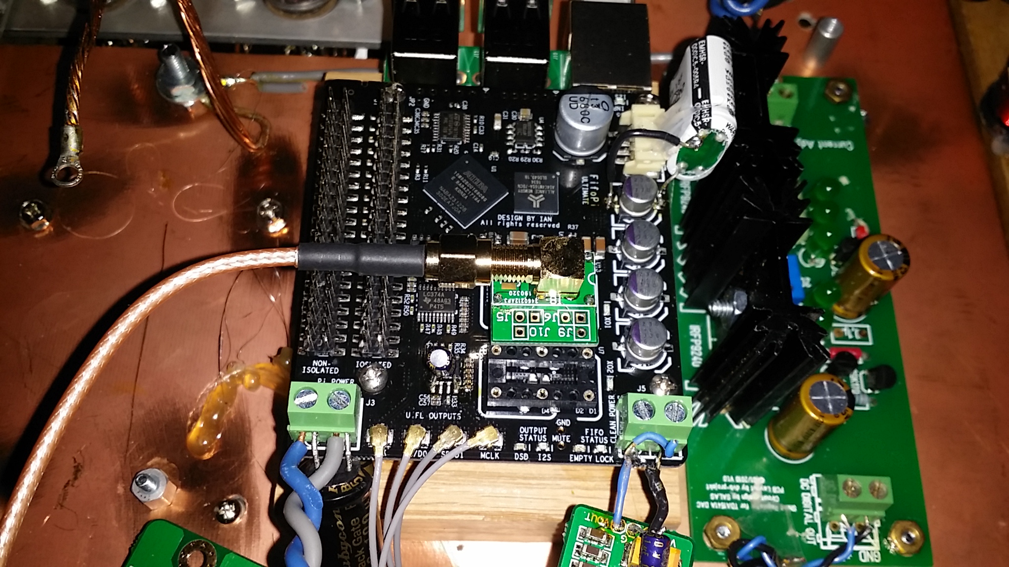

Supersurfer
I followed your lead and fired up the WTMC SC cut @ 45mHz before building the oven. Without your post I would never have thought about running it without the oven and a best effort power supply.
It is a preview of greatness to come. Even on a mediocre linear PS and just hanging by its wires it is a major step forward over the NDK SDA it replaced. The NDK was no slouch with very good PS, supercaps and BG HiQ caps.
I am getting similar result to your description. Big step closer to real sounds of instruments, voices & percussion. It is a good upgrade for me. I value micro details, laid back reality and dynamics.
As with previous clock upgrades the increase in dynamics and lowering of sound floor makes it sound louder even at the same measured db at seating position.
Current plans are to add the oven and put the master clock in its own chassis with SMA cable to FIFOpi.
Thanks Andrea!!

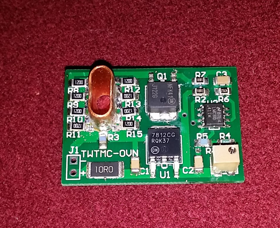

Hi Wlowes,
Good to know you have a similar experience! After the holiday season I will start with the oven.
I see you use the black gate standard on the input of the fifopi (for powering rpi?) and a supercap soldered on the board. Did you experiment with these components (and placement)? I use a supercap on the input connector (and the bg on the iv-board), I am not sure the supercap is a good solution soundwize, the bg’s have never failed me though.
My standard cap placements (after years of experimenting) are to use oscon for digital circuits and elna silmic or black gate for analog.
Silmic makes the sound more silky, the black gates (standards) give more blackness and low end power.
Hi Wlowes,
You were right when you said it's a game changer. I leave the digital front end powered 7/24 so it is starting to burn in. I listened today and it was totally changed (better) after 3 days on the oscillator and 24hrs on the squarer. It is truly one of those times you need to re-listen to the entire collection. I built the oven, but still need to build a PS so I have not heard the clock with the oven. I'll report impressions in a few weeks when it's finished and burned in.
I played around a bit with supercap positioning. The cap on the FIFOpi clean power rail is a winner. Dynamics, slam /attack are the result. It's a keeper for me.
I think you missed the BG HiQ on the FIFOpi on the power pins of the masterclock output buffer. Cleans up the signal and adds that nice BG touch you mentioned. Highly recommended.
Like you, I like the results from BlackGates. I think I counted 75 in total across the system.
The Rpi power has a BG F 100u. I can't say if it is warranted or not. I have quite a good linear supply to the pi and just add the BG for good measure. Putting the same cap on the + and - pins of the TDA1541a had a major impact. The pi PS also important but not as much impact.
Also placed a supercap on the I2StoPCM power rail with good impact.
I can also relate to your comment about having a system capable of revealing the small stuff. I also have open baffle speakers with minimal crossovers. Amps are 6c33c OTL and very transparent. Slagle autoformer line-stage, and dual mono triode output on the DAC. I keep resistors to a minimum, and use hand wound manganin in all the key places. The result is that every improvement in the front end shines as everything downstream is capable of much more.
I just tried:
Any ideas why?
They are mainly software issue. Can you try piCore player for 384KHz? I use this configuration without problem.
Or, reset ESS controller to factory default setting to see if any change?

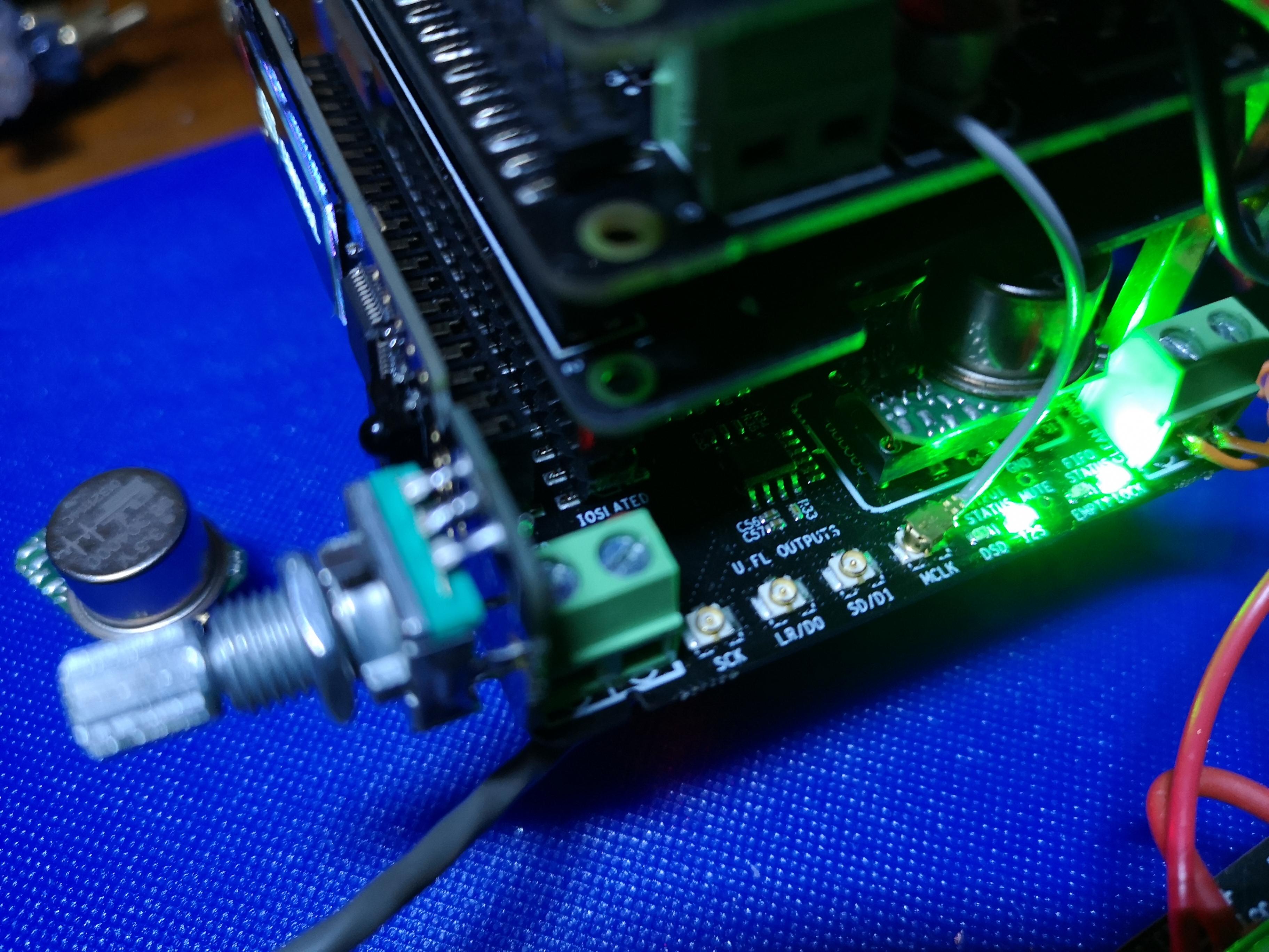

received the ShieldPi, thanks ian, your service is second to none:) , after installing it, seem to have a darker background and better treble.
i have a problem with the 98mhz pulsar clock, both led of the clock on the fifopi
are flashing and d2 ,d3 on the e9038m dual mono is no on. happened either by
the 98mhz clock itself or together with the 90mhz pulsar clock, currently it work with just the 90mhz pulsar by itself.
Hi minivan,
pulSar doesn't have OE pin, so you can use only one of them on FifoPi. Please don't use both of them at same time.
Ian
