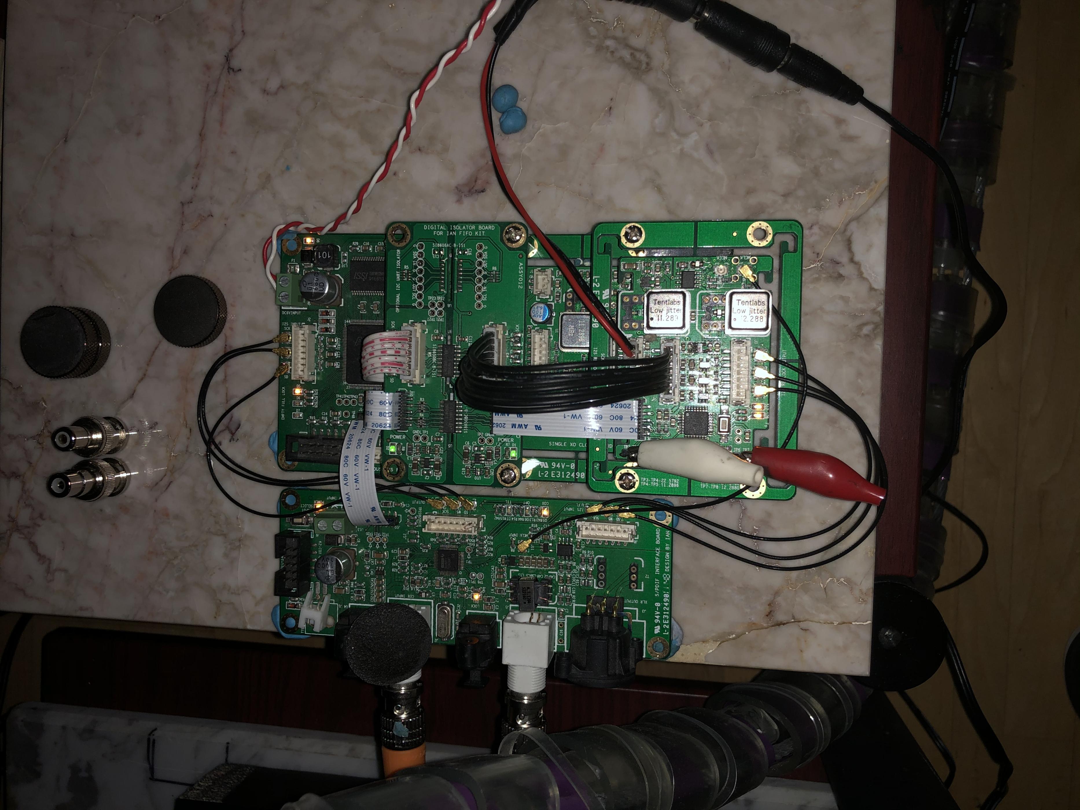

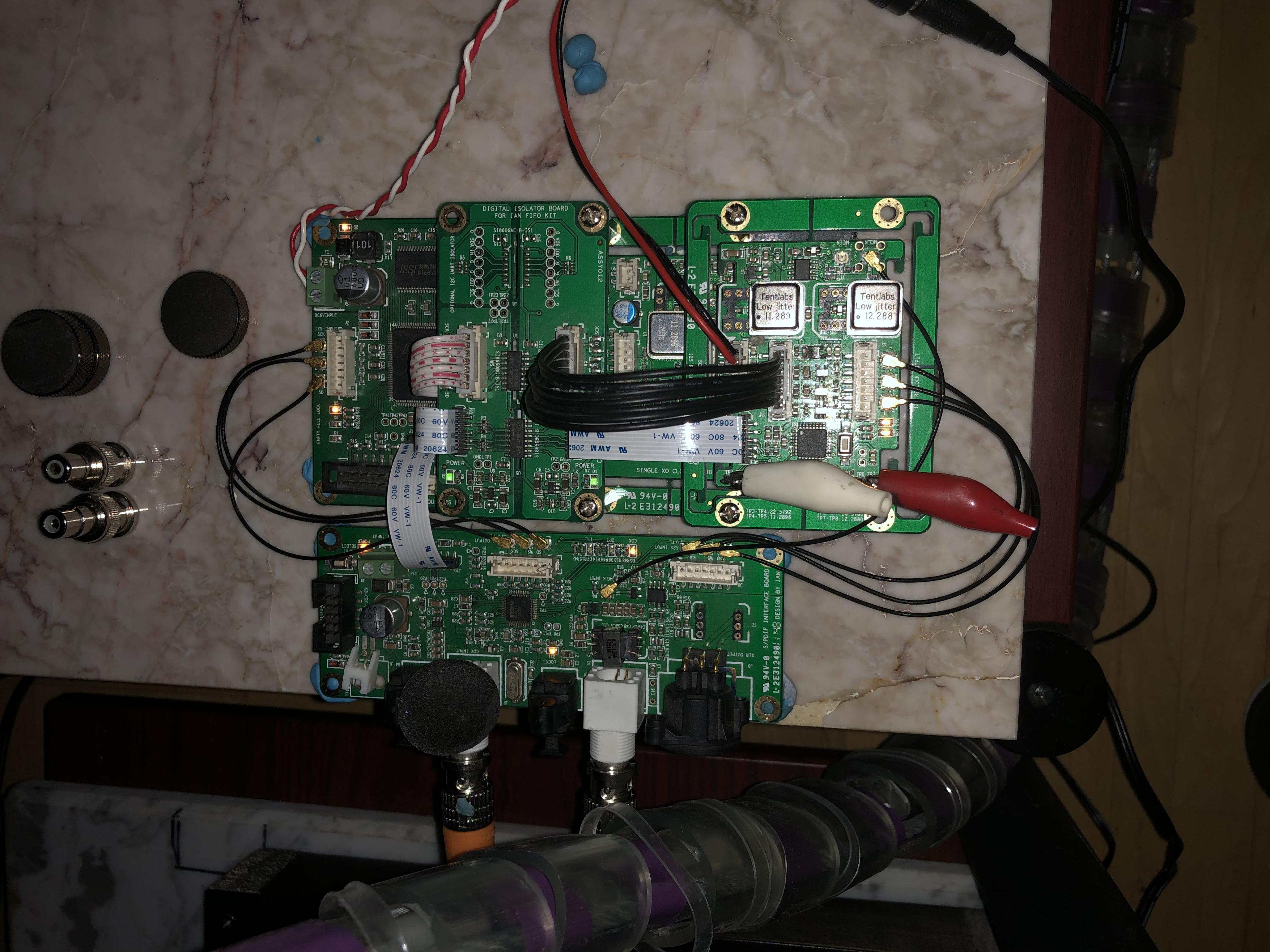

Just wanted to give an update, i tried tentlabs xo 11 mhz and 12mhz XO on my original fifo kit and i like it more than the crystec cchd957 22, and 24mhz ones.. more natural sounding..
Thanks for the report on TentLabs. Continues to reinforce the value of low phase noise clocks.
Attached are some pics..
Anyone knows the part number or where to get the shorting plugs? Im currently using clips to select the right xo frequencies.
