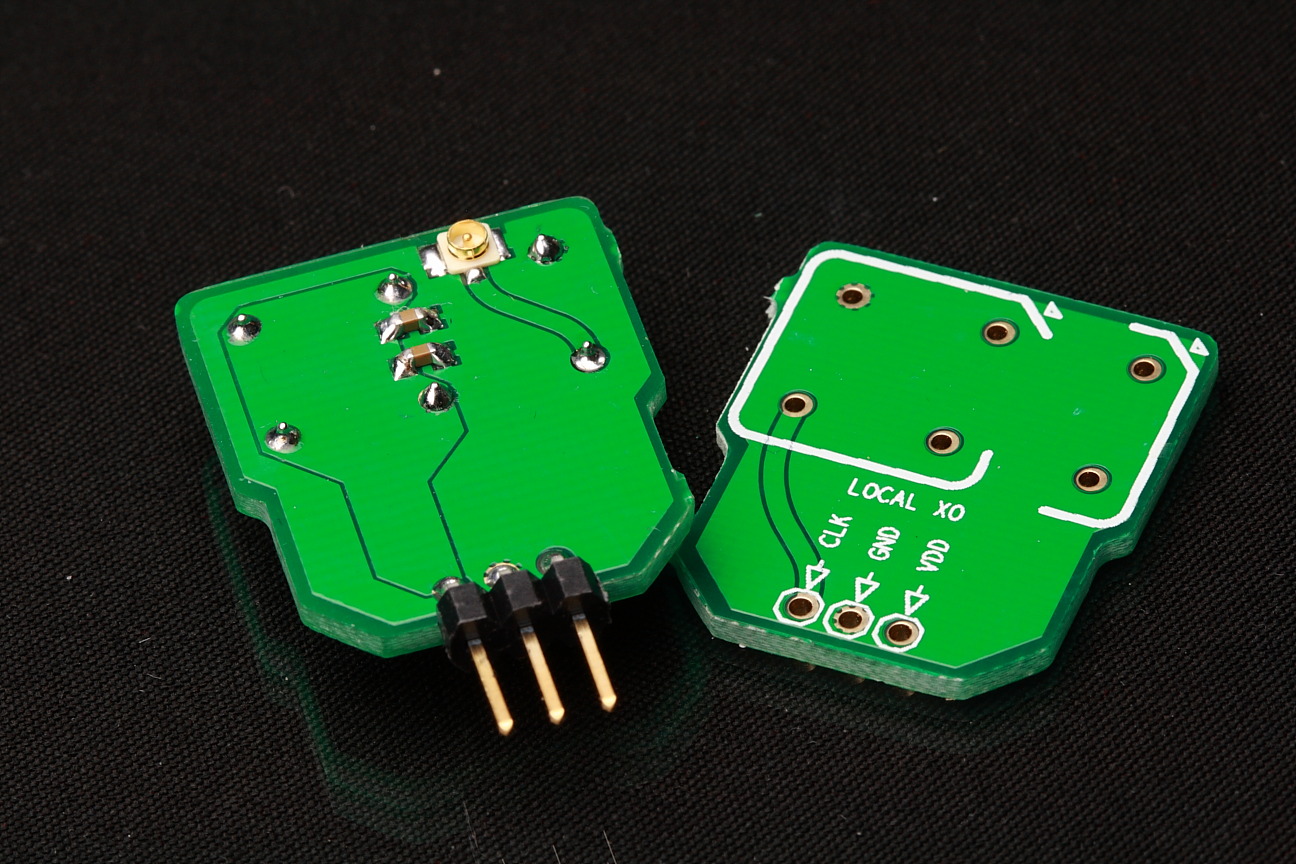

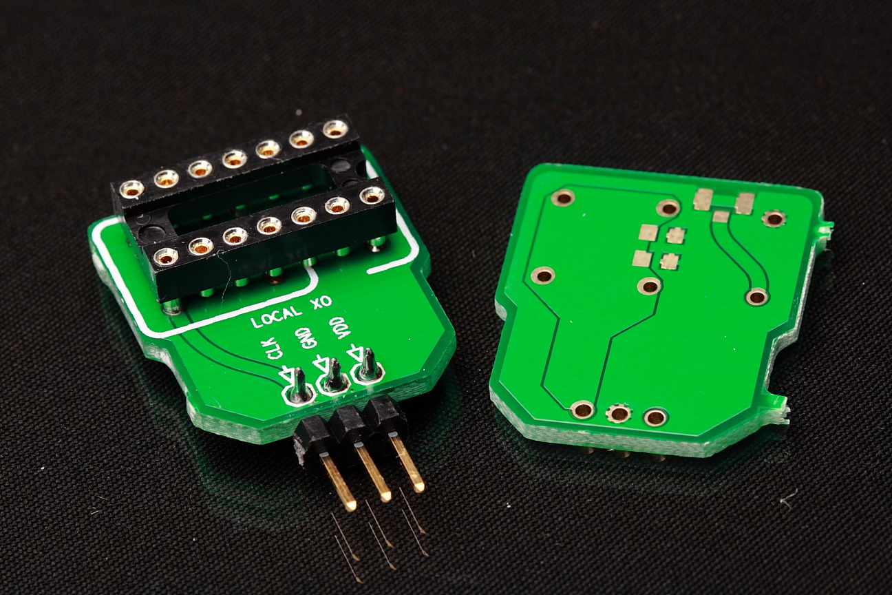

1. it allows the clock from the BIII and probably BII to be removed and this adapter connected in its place, then it has a u.fl connector header on it (mini bnc) which allows proper connection on an external master clock signal to be connected from the fifo clock board output so that you can run a synchronous clock, running the dac from the very same clock as the fifo.
it also appears to have a place to connect a clock in a socket on top to allow you to easily switch between synchronous and asynchronous clocking. I would say you can probably use this with BII, maybe not as neatlyI havent studied it closely, I dont use BIII or BII with fifo, i'm running an ackodac

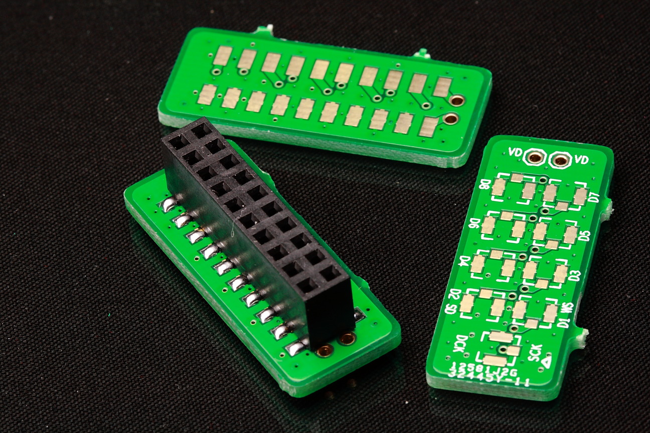

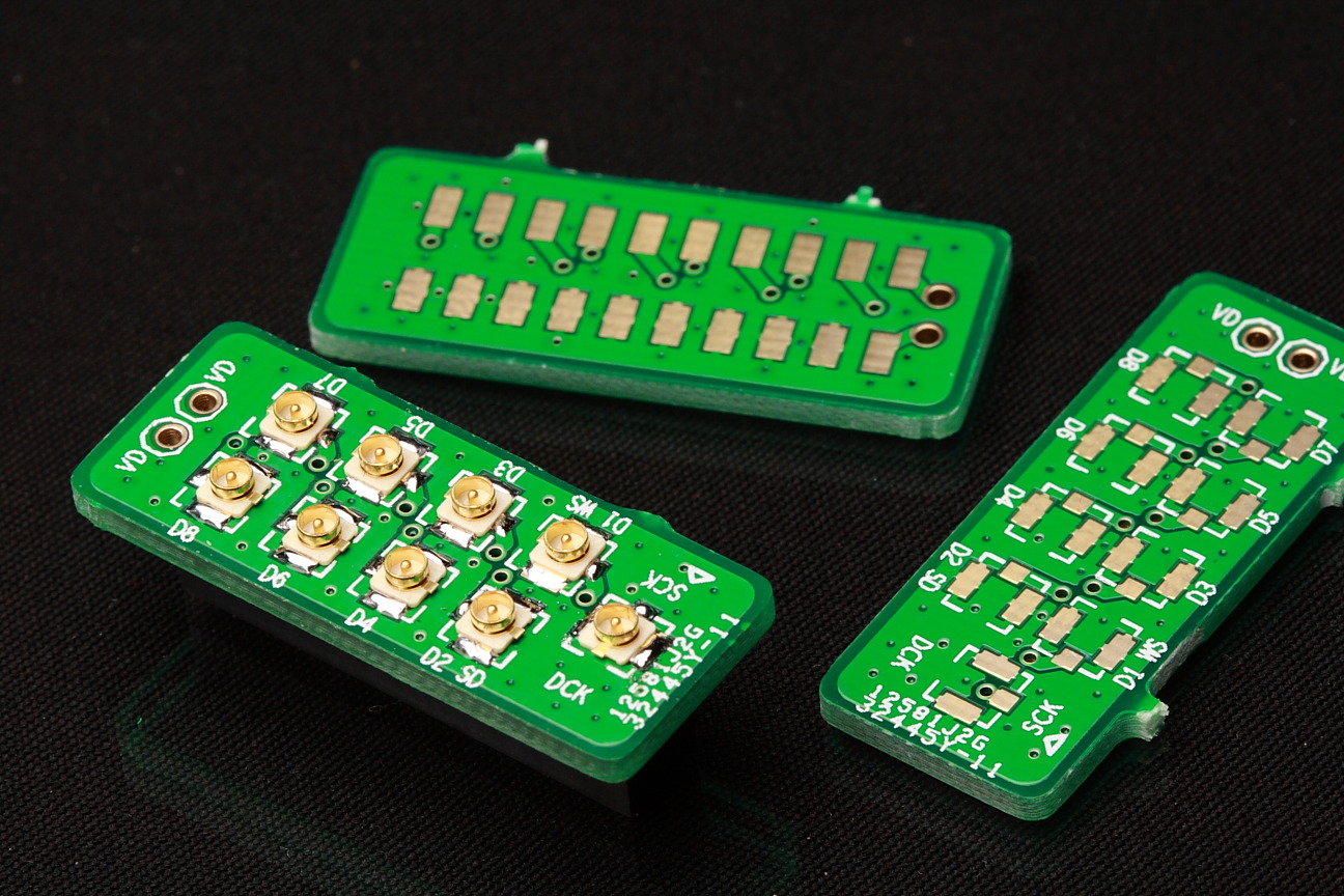

2. the second part converts the multichannel i2s header on BIII to multiple u.fl headers for the rest of the i2s inputs for BCK, WCK, SDATA (BCK, D1, D2) for better impedance controlled and neat connections, pinheaders really arent ideal for i2s and the fifo has u.fl for better signal integrity

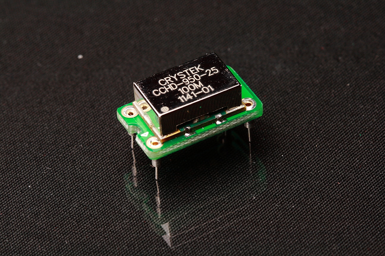

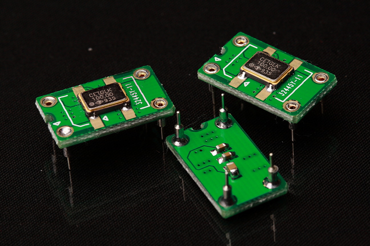

New universal SMT XO adapter tested
New universal SMT XO adapter is compatible with most popular SMT XOs, CCHD957,CCHD950, 7*5, 5*3.2,3.2*2.5,2.5*2(NZ2520S)... The decoupling capacitors at back are optional. Two 100n 0603 and one 1u 0805 are recommended. But if the XO has good internal decoupling capacitors, then you don’t need any of them.
I did some test on a couple of different size XOs yesterday, CCHD950, NZ2520S and a normal 7*5 XO. They woke well. See the pictures for details.

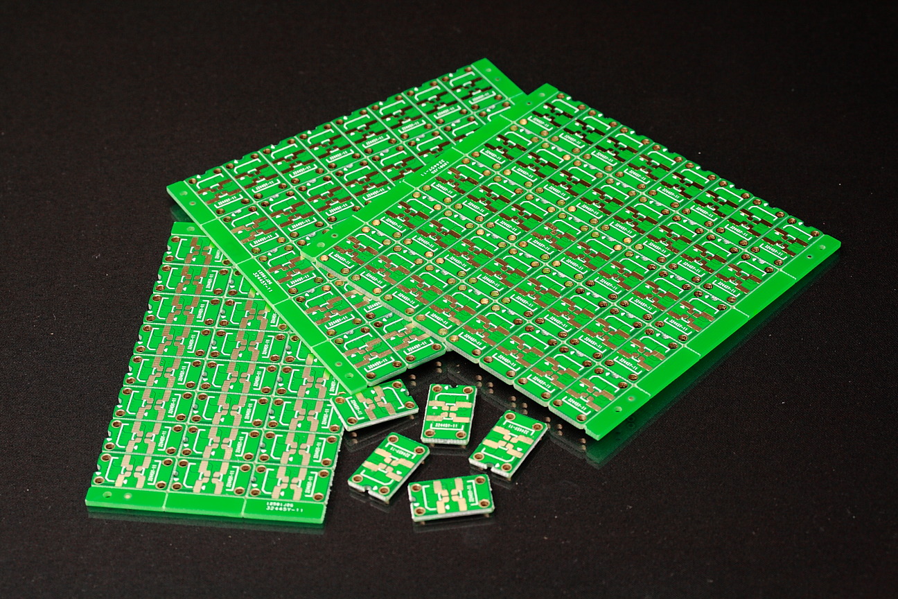

The manufacturer combined 40 of them in one piece of PCB with v-cut. I don’t like the rough edge. You have to use file or sand paper to make it looks nicer before assemble. It seems I have enough PCB to supply this time. One FIFO KIT still comes with one adapter kit for free. I’ll list it with the GB II details for those who need more.

Ian, they look perfect!
I had not seen those 2 x 10pin headers with the surface mount connections previously, only through hole versions, they've really allowed you to achieve the most compact and optimal arrangement! I tried to work out an arrangement earlier in the year with a through hole pin header part and didn't ever get to an arrangement I was happy with.
Almost makes me wish I had a BIII!
Yes, that's exactly the reason I like them. It's kind of perfect solution, even better then I thought.

Regarding Buffalo III adapter boards...
I'm not sure if You are planing to ship them already fully assembled with u.fl conectors and 2 x 10pin headers..as I can see at Your pictures.
I thing that for Buffalo II owners could be better to have just u.fl sockets and free access to confection pads on the other side of PCB.
Actually just clean PCB and not mounted u.fl conectors that would be OK with me.. There should be some "DIY-handmade" way to connect it to "ancient" BuffaloII 😎 ...
Well actually it seems to be perfect!!! for my Duall Mono I2S wiring set-up..😀

Soldering those U.FL sockets is not an easy job. I would be more than happy to supply the bare PCB only. 😀
