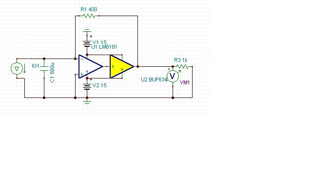

Well, due to my own stupidity, I blew up two LM6181's yesterday. Sigh. I should have read this app note before playing with a current feedback amplifier:
http://cds.linear.com/docs/Design Note/dn46fa.pdf
The filter caps in the feedback loop of my IV converter made the LM6181's oscillate and get so hot that I burned my finger on them. I'm sure they are dead now.
It's not easy as far as I can see to limit the bandwidth of a current feedback amplifier. Some kind of prefilter is needed according to the app note. So, using current feedback amplifiers for limited bandwidth audio DAC's appears to be a difficult thing to do.
if your I/V R is larger than the min stable feedback R then you can add a series RC in parallel to give a shelving low pass - its a start
"noise gain" series RC to gnd at the input lets you use a smaller feedback
R, lowering, pushing out the "shelf"
in fact a quick sim showed a low enough Z "noise gain" input network stabilizes a LT1227 with pure feedback C - but that is in sim - depends on op amp output Z modeling which is often poor at CFA in/stability frequency
