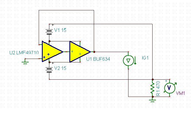

Not in the CEN IV circuit.
The added bonus is that Zin of the IV now equals Zout of the opamp.
And since the open loop gain is >120dB, and open loop output impedance is <1k,
you can argue that the OPA1641 Zout in follower mode would be <0.001 ohm.
And no, I don't have measurements to prove.
But yes, we have a PCB and will try it out some time.
Patrick

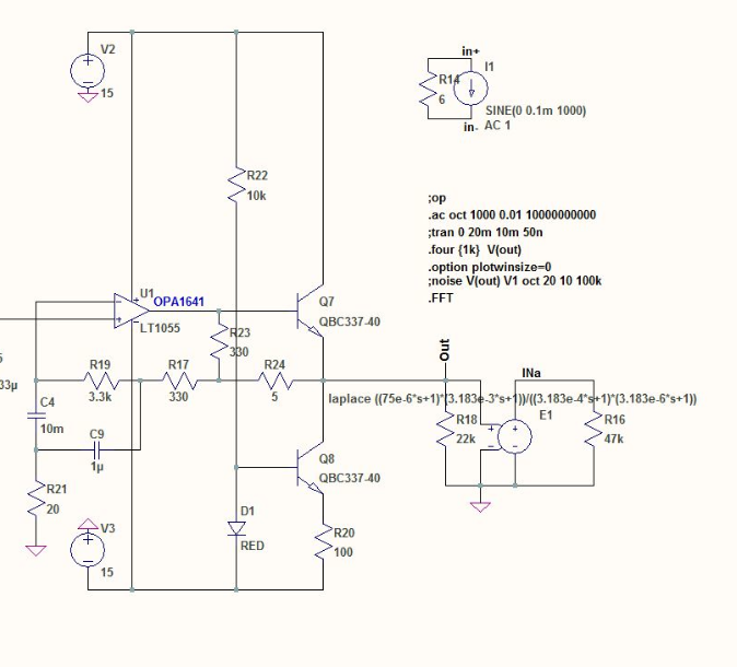

I use the OPA1641 in one of my phono amps in the second stage. I biased it into class A and added a buffer. That way it worked so well that a discrete design was not better.
Really interesting, did you ever tried OPA827?
Yes, i prefer the OPA1641 but the OPA827 is very good too. I also preferred the ADA4627 slightly over the OPA827. That is not based on measurements but only on listening.

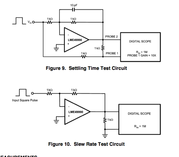

It is a bit like wine tasting. The longer and more eager you listen the more differences you find. I would say in a blind ABX test the differences will be swapped. I value topology higher in importance then swapping opamps anyway. In I/U converters we must be really sure that the opamps do not slew and snubbering and integrating is the right way to go i think. I just got back a digital preamp i friend of mine builds since many years and it sounded much better then before. I asked him what he did and he answered that he uses a bigger integrating cap now. The sound was much more analog like. Richer and more fluid without any loss of detail. I think he uses the LME49990.

Here is the second stage of my phono RIAA where you can see the principle. Ignore the name of the Opamp and the inbuilt EQ in the feedback loop.

Don't get too excited about this circuit. It's actually worse than a "normal" IV converter using opamps, either in terms of noise or distortion. I believe what you would want if you do this is the lowest possible output impedance for the opamp which is why I added the buffer.

What is this Dirk ? Positive input grounded and all currents lost in a loop.
I can not see how this animal can amplify but it will eat some current.
