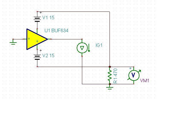

Here is the second stage of my phono RIAA where you can see the principle. Ignore the name of the Opamp and the inbuilt EQ in the feedback loop.
Joachim , I think the output buffer is the principal cause of the good results that your circuit achieve. Last week I have made a headphone amplifier with the same type of buffer , with opa134 , and I really, really love it . 🙂
Don't get too excited about this circuit. It's actually worse than a "normal" IV converter using opamps, either in terms of noise or distortion. I believe what you would want if you do this is the lowest possible output impedance for the opamp which is why I added the buffer.
Patrick, I must agree with dirk. Is not a good idea taking the output from the supply pins , I know some amplifiers that do that , like the Alexanders amplifier , but in that case the opamp is inside the feedback loop , and that is not the case with the circuit that you like. Tomorrow I will post a circuit that may serve you better.
