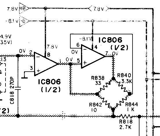

I've never seen that configuration before used with opamps. Its very like the Class AA ? Technics and Aubrey Sandmans Class S power amps.
I looked up the data sheet on the M5238 and its a high current output device which makes sense given the low values of "R" in the bridge.
The TLE2072 I mentioned has an 80 ma drive ability and operates on supplies down to -/+2.5 volts. Try it 🙂 No guarantees though.

After studying the mounting understand that this is a Howland current pump, modified where the first operational amplifier acts as voltage and input impedance adapter (infinite), and the second operational amplifier makes the voltage at constant stream, with a ratio 1/100, with a low impedance Zo...... It maintains the output current constant, varying only the voltage, irrespective of variations in the load, minimizing signal distortion
In this way the op amp that is used is not important. What is important is the relationship of voltage and current in the circuit. The key point to remember is that an Op Amp will use all his considerable open-loop gain to maintain both their investment and non-inverting inputs in line with each other, ie, in the line voltage. If the positive input of the OpAmp see 1V, then its negative input 1V to do well. If the input signal is 0 V, then the output voltage of the circuit should also be above 0 V as the voltage only SRAM maintains two inputs to the same voltage accurately. 🙄

I'm not convinced 🙂
I still think the current drive ability of the opamp is important although I can't see the rest of the circuit.
In your other diagram, (which I'm going to have to delete because its under copyright from Rod Elliots site, Elliott Sound Products - The Audio Pages (Main Index) you show the voltage output of the opamps "across" the low impedance bridge and so the opamps driving ability must come into the equation. If the second opamp output is at 10 volts then you can either say that 10 volts is across the low impedance of Rload and R3 or, if you say that the first opamp contributes to "raise" the voltage at the junction of Rload and R3 then that first opamp drives a low impedance load.
I think it matters given the impedance values in the circuit 🙂
Yes, you sure you're right
The operational capacity to supply current must be important in this circuit, especially because the designer chose originally an operational with capacity to deliver 50mA, which is beyond the capacity of 2604.

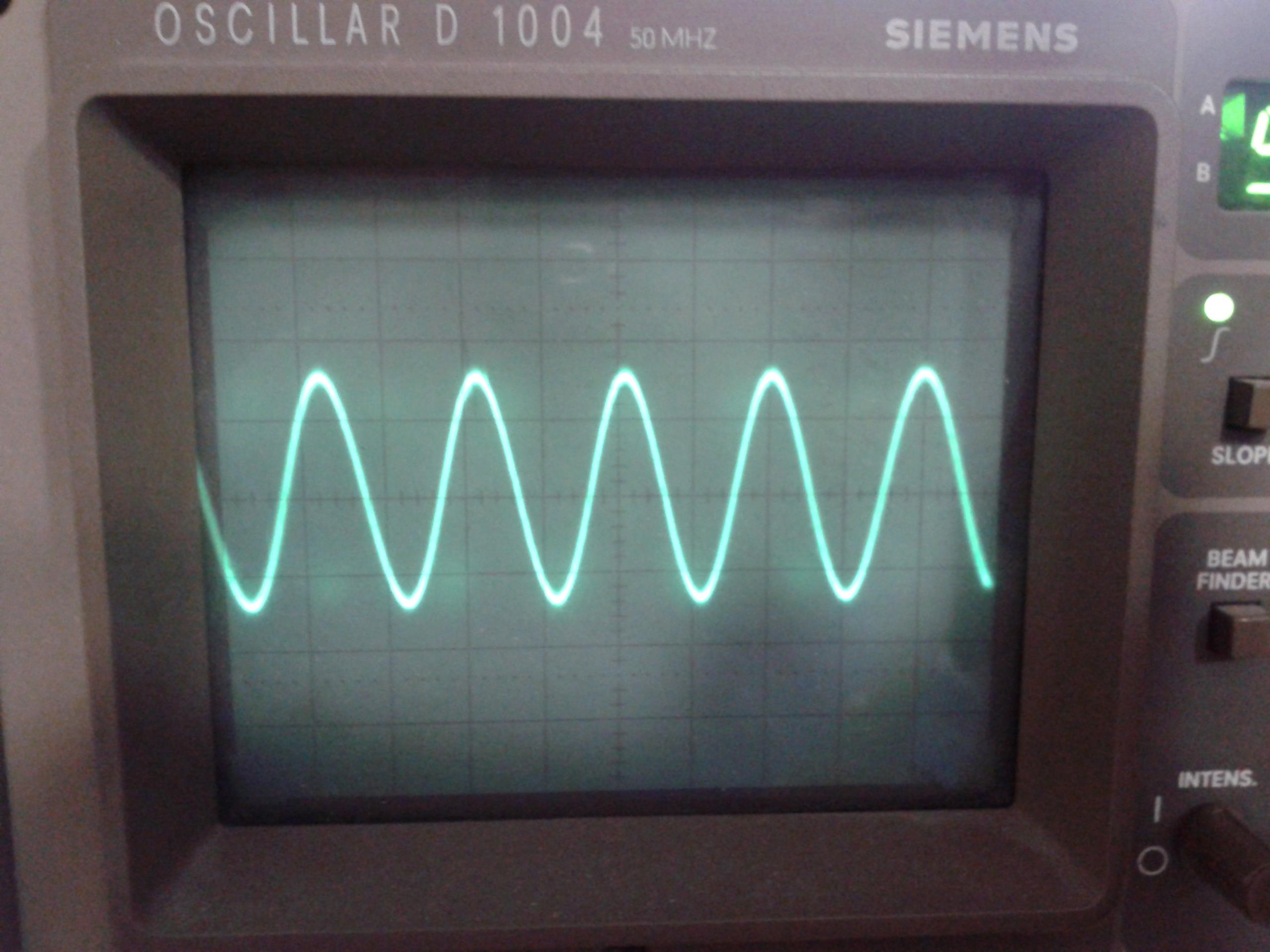

Hi Mooly
These two weeks, I've been testing, measuring ... and many drunkenness
These are my conclusions, and a final thought:
- The OPA 2604 has been for a long time, my first choice when it came to stage I / V in dual SMD circuits operational. But this project has been inappropriate ... Why?? ... I do not know.
- The TLE2072, did not fulfill my expectations, not bad, but not quite like it sonically, I can not say it was worse than the 2604 bid, just different... not for me.
- From there, I decided a radical change, I decided to ride in stage I / V the AD8620ARZ, and in the next step the AD8066, a total of 8 chips with 16 operational ... radically changed the sound better: great dynamic, balanced bass, and high frequencies present without fanfare .... a revelation.
