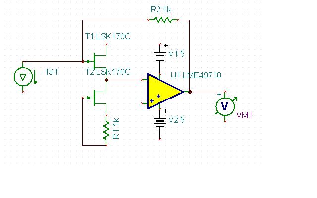

low noise bjt have large Inoise at the input, this causes V noise when multiplied by the I/V feedback R
with the low output I of the PCM1704 the I/V R is kOhm - most low noise bjt Inoise will cause more I/V output noise than the best fet input op amps Vnoise
Ah, very interesting! Thanks for sharing. I was actually able to follow what you said and I agree. For low output current DACs, an fet input opamp would produce lower noise than a bjt input opamp.
Well, there is the option of adding a discrete fet follower inside the feedback loop of the bjt opamp. It's something to play with anyway, and has been done before.

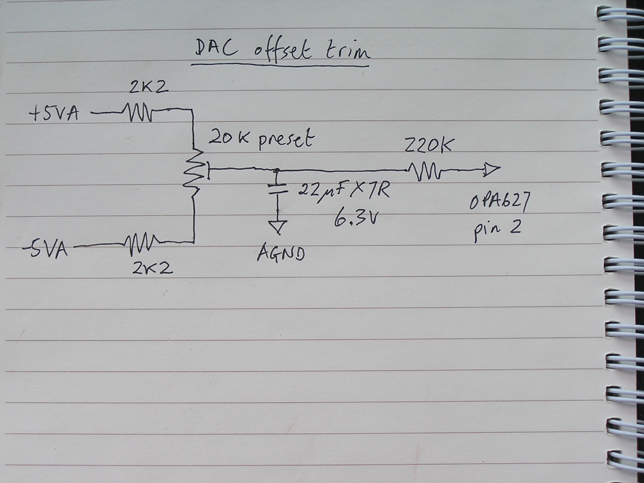

Hi JCX, I have done a mod which has me falling in love again with the OPA627 as the I/V.
My cdp has as you know a PCM1702K for each channel, I was always bothered that they gave dc offset to the OPA627 I/V. With the help of abraxalito, I got rid of it (circuit attached)
This is the post I sent to him and I would like your opinion as well.
"thank you very much for the dc offset nulling circuit it worked a treat, instead of 17mV left and 50mV right comming out of the OPA627 I/V's now I have +- .1mV I don't know why but the sound has improved very much overhaul esspecially in the bass. Is this possible, that the OPA627 as an I/V does not like to see any dc comming into it from the dac/s???"
Cheers George
