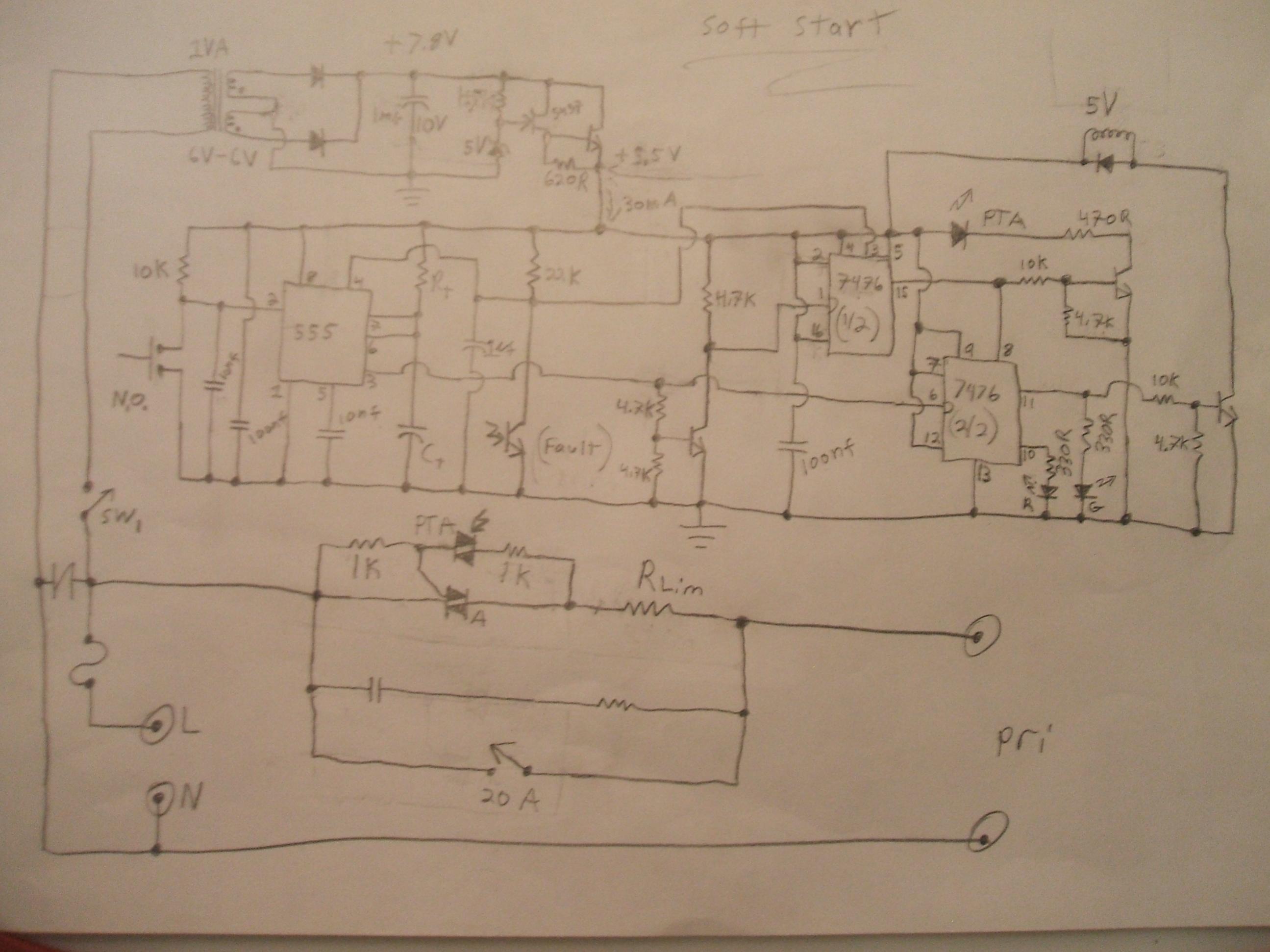

Hi,a logic signal driving the LED since the triac must be triggered every half cycle to be on as a switch.
It looks like the 555 +7476 are sending a continuous logic light level to the opto triac.
Does that mean the opto triac re-triggers itself every zero crossing and this re-triggering then re-triggers the main switch?
yes
A DC controled isolated AC switch.

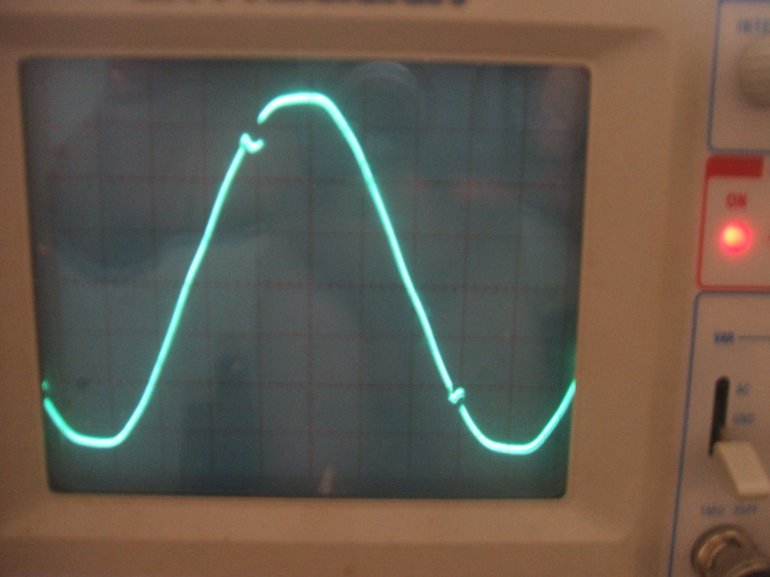

On the output waveform even with a snubber there is a small switching notch of a few volts on each half cycle but I have not noticed a difference in the amp as far as noise related to it, and you do loose a couple of volts to the triac but thats the price you pay for convenience.

Possibly more reliable as no moving parts. However, they generate switching noise every zero crossing as they don't conduct below +/- 0.6v. This may or may not get to your amplifier which in turn may or may not have an audible effect. I don't know.

... The reset of the 555 and CLE of FF A can be triggered by a logic 'fault' signal from the amplifier circuit via a photo coupler or just a regular transistor reseting the condition of standby, such as measuring if a fuse has blown or DC appears at the outputs.
Is triggering the fault signal the only way to get the system to turn off? I haven't played with logic circuits. It would be nice to have something that only needs a single momentary switch to control power.
No
One push of the momentary switch turns it on, press it again and both FF's reset, notice the CLE of the FF B is connected to Q of FF A. The fault is just an easy way to automatically reset the circuit with a logic signal in the event of an issue. So yes, the momentary switch turns it on and off.

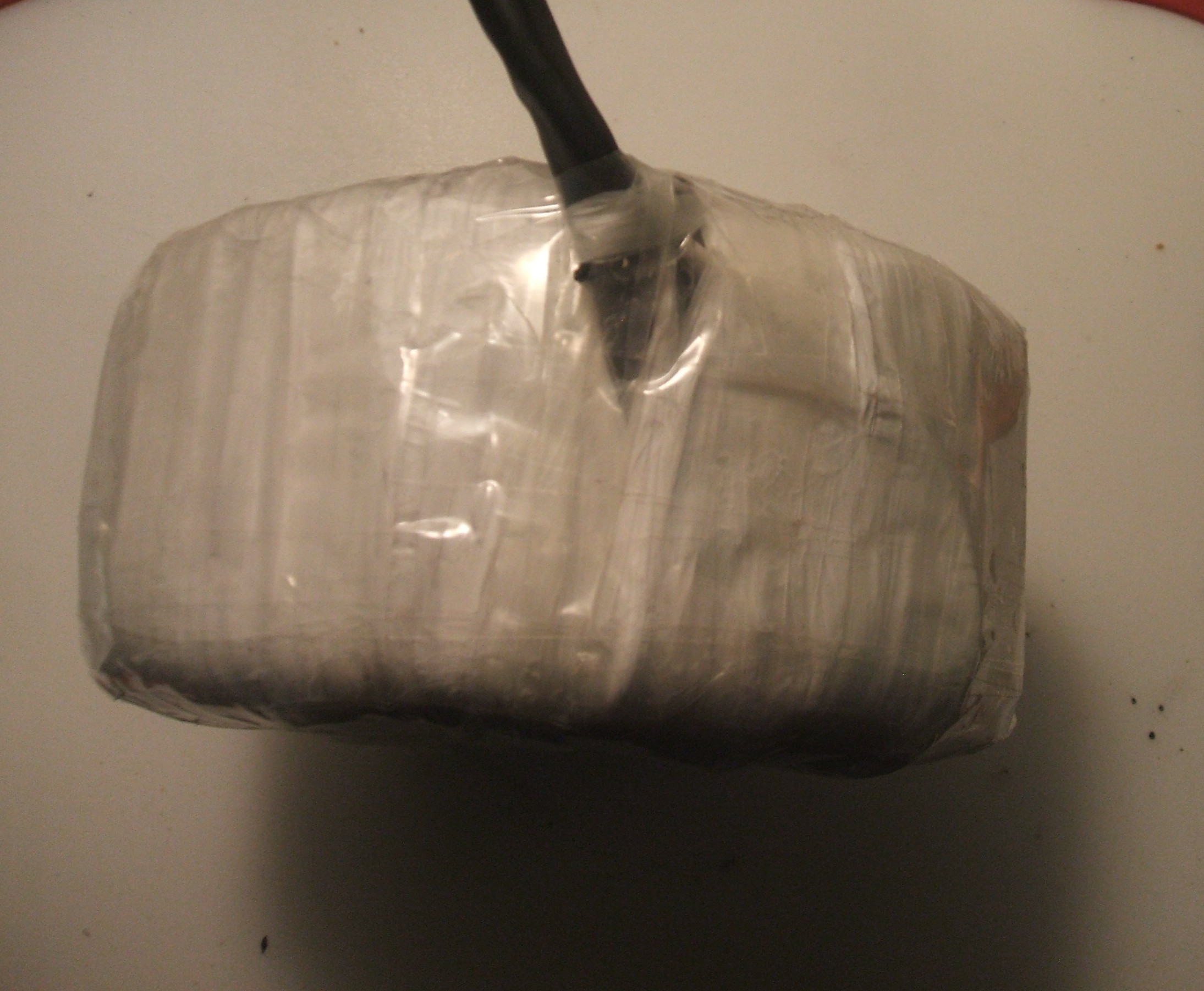

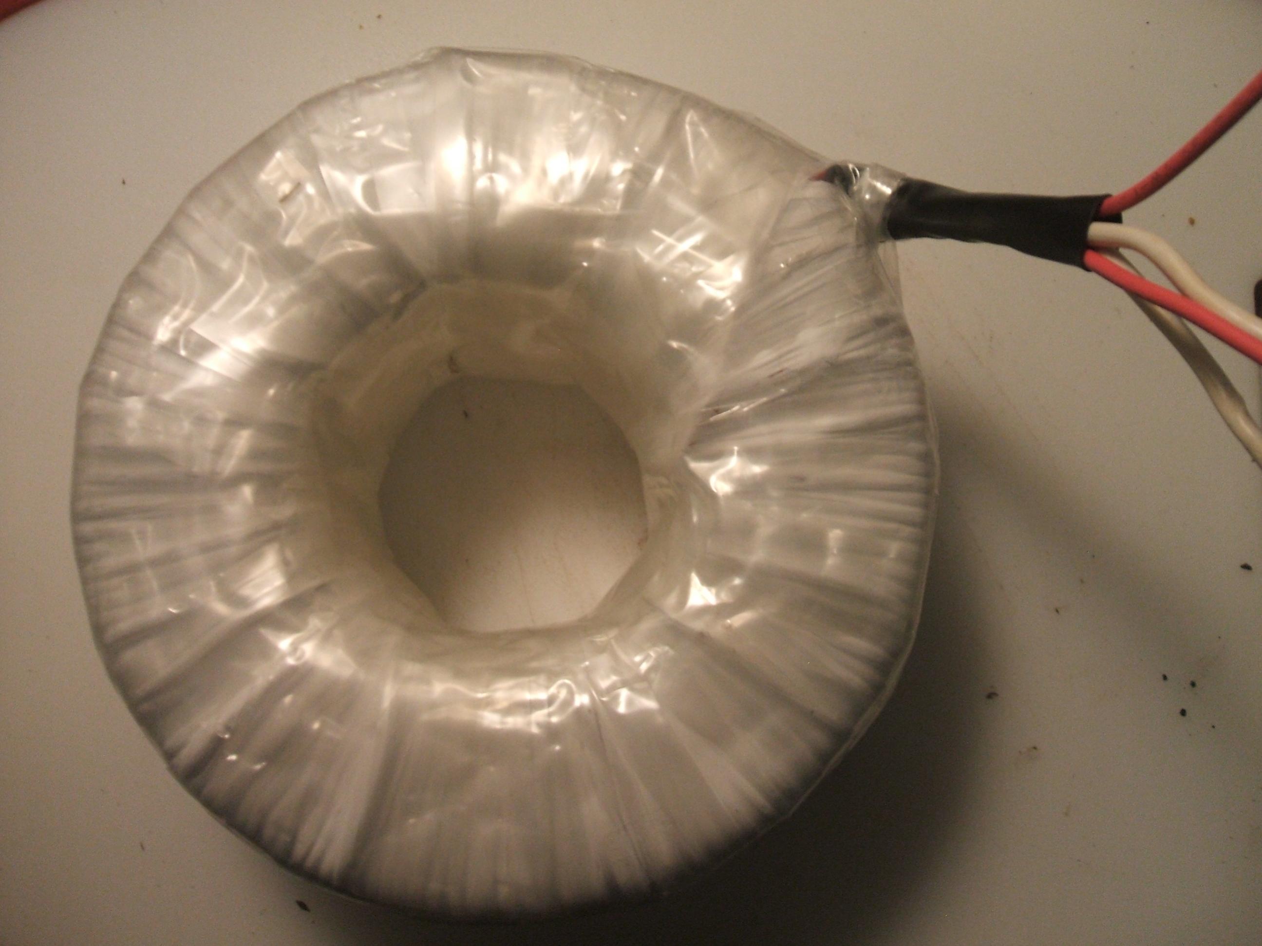

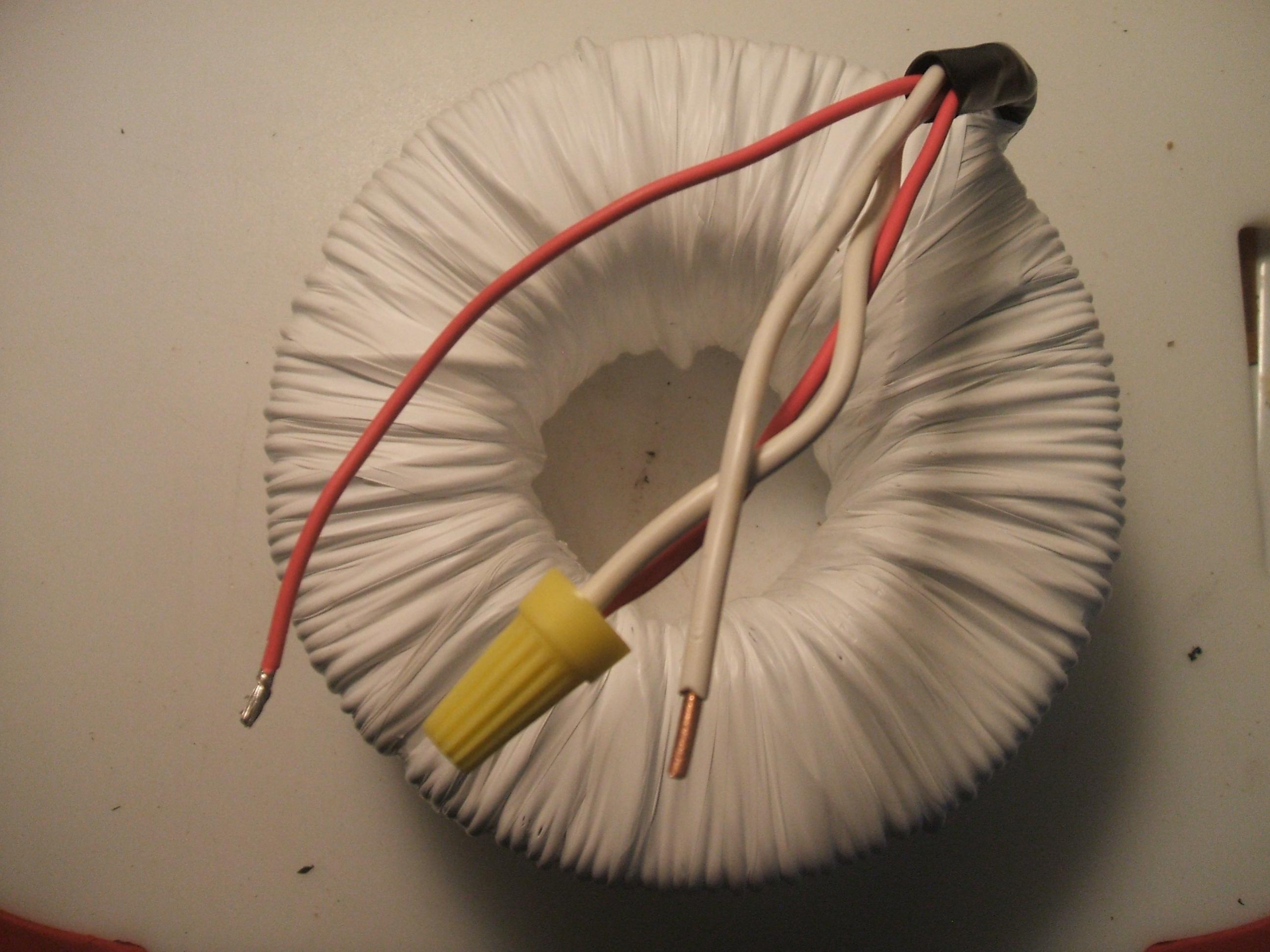

Now that I finally received the transformer, first thing I did was connect up the primary and see if the soft start circuit worked. It did, but the transformer buzzed loudly. So I connected it directly to the line. It still buzzed but not quite as bad, suggesting the switching of the triac does affect this type of transformer, which I kinda expected. So for simplicity I replaced triac B and phototriac B with a relay..... Problem solved there. It is still convenient to use a triac to switch the current limiting resistor.

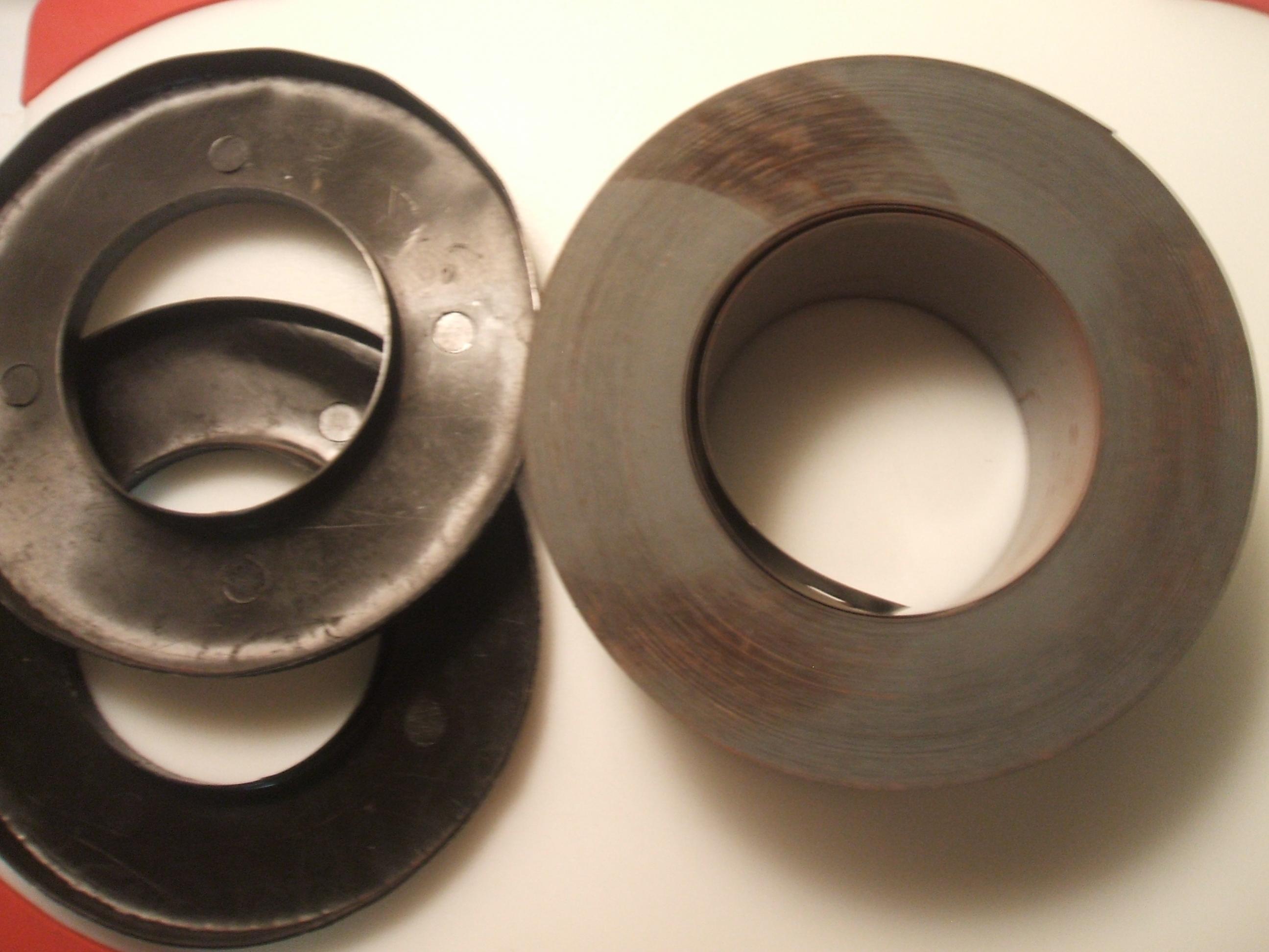

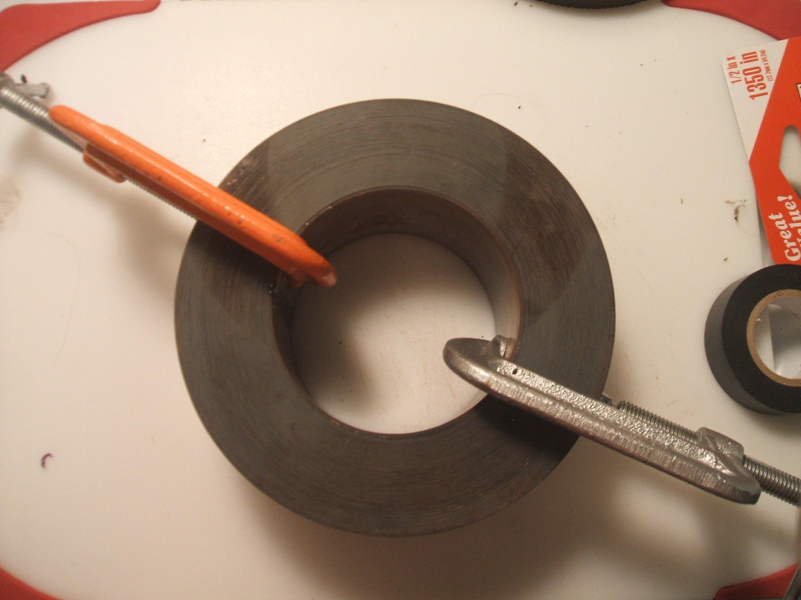

As for the transformer still buzzing while directly on the line, I investigated further. I could feel a couple of windings vibrating and there was a buzz that came from the center of the whole transformer. This will obviously not do, so after removing the primary insulation, I discovered several crossed windings on the outsides of the toroid in the primary and that they were not that evenly distributed. After removing and straightening all of the 11 Ga primary winding, I discovered the iron core coil windings was not fixed in at the center of the coil and were loose. I would expect better quality from a US company. Still no e-mail response from them about the missing parts. Not only was the transformer kit missing parts, the transformer was obvious cheaply and half-a$sed constructed. Soooooo I set out to rebuild this transformer in a proper way. After all, I did have to pay for it.... An entire day later, it finally works. The soft start circuit works with the relay, although I may play with the logic and see if I can make it work like a soft start/soft stop to prevent any inductance kick back across the relay.
The top of the coil was barely tack welded into place and looked like it could pop loose at any moment. So I broke out the JB weld, cold weld epoxy and used C-clamps to tack down the coil by alternating them around the coil to get it all pressed into place until the epoxy set. Then I cleaned and applied some oil to the sides of the coil as it appeared they had already began to rust. As for the end caps, I only used the part of them that's needed to wrap the wire around the core without cutting it. After hand winding 145 turns of 11 Ga magnet wire (have you ever used 11 Ga magnet wire? ...damn thumbs hurt now but this time I did not cross any on the outside of the toroid. ) I connected it to the line and it buzzed no more, silent as a sleeping baby. Now if I can do this by hand, why could not someone at a factory with a winding machine do this?
Anyway I added two layers of teflon tape and re-applied the mylar film covering for protection. Now I'm ready to add the secondaries.....finally.

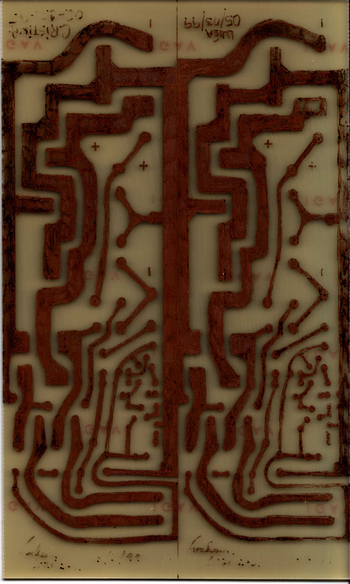

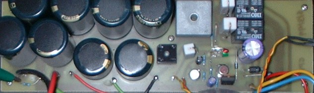

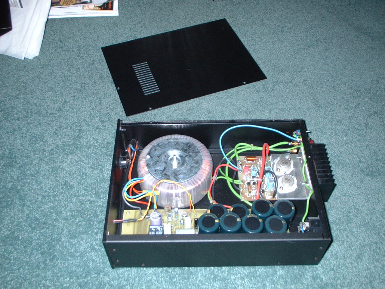

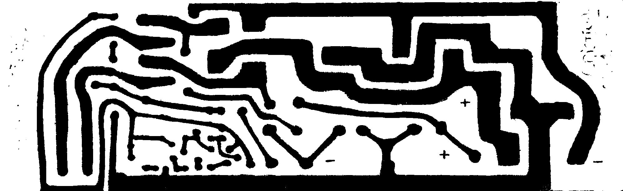

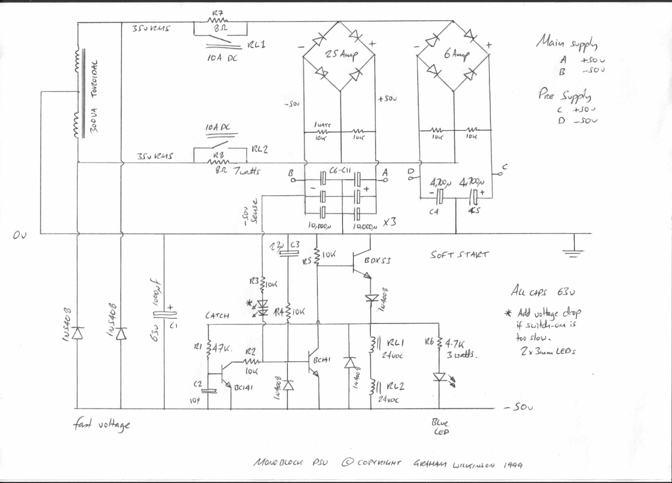

Just FYI:
I built a soft-start a while back that worked out pretty well, for a pair of mosfet monoblocks. I used 2 supplies, one for the driver circuit, one for the output devices.
The soft-start is only on the main output devices, and the way it works is the circuit detects when the output circuit has risen near enough to the driver circuit (with 3V or so) and then switches on the relays. It's foolproof and has proven safe under all switch on/off etc situations - plus you really shoulf be powering the drivers from a different supply
I.e this soft start has no timer, it just will not switch in the relays unless the voltage difference is low enough not to cause a 'bump'.
