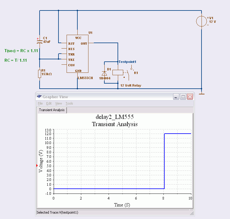

I tested one idea.
How to make the inverted operation, with one LM555.
Works! 🙂
The RC, resistor and cap.
When we have Resistor on top and Cap at ground
then the voltage across Cap will increase, until trigger 555.
Now, if we put Cap on top and Resistor at ground
then the voltage across Resistor/TR will decrease.
So, in first case voltage at TR will go from low to high.
In second case (see my diagram) voltage at TR will go from high to low.
The circuit will now power up relay from OUT Pin, after 8 seconds.

You're a genius. Perfect. Using a single 555 is a cheaper and easier option. Well done for thinking outside the square. I have not seen a schematic for a 555 used in this way. We've made some good progress here. Thanks for your help!

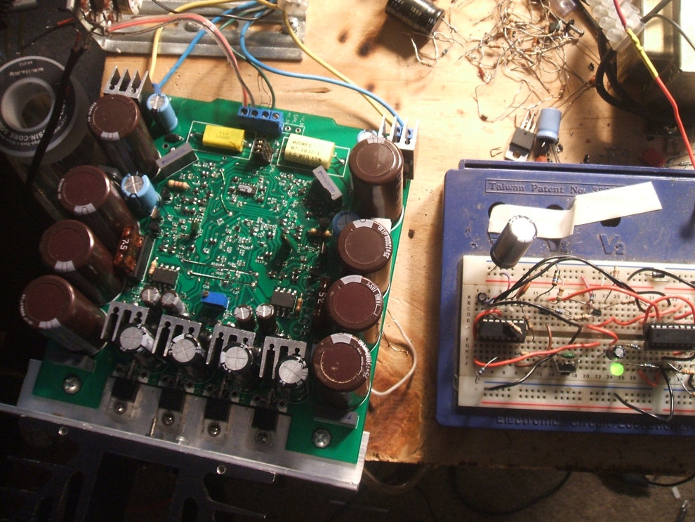

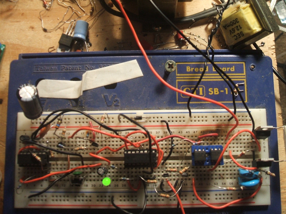

It works!
Having just lashed it together on a breadboard I can now confirm that the single 555 circuit posted by Lineup in post #24 of this thread works perfectly, and the 8s delay predicted by the simulation is pretty accurate. The circuit seems stable and repeatable and I will definitely be using it in my next project.

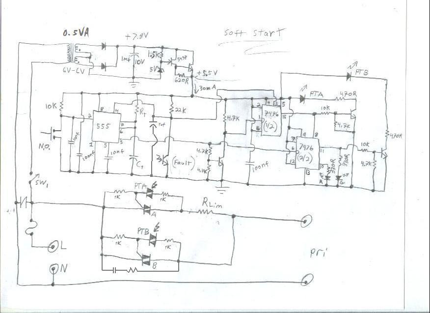

Funny seeing this thread pop up now, I was just working on a way to soft start the large toroid transformer I should be receiving in a few days and had an idea come up with a circuit that I think ought to work. MHO, relays suck....:yuck: I try to avoid using them whenever possible. SS good :up:😎
Line comes in through a fuse (of course😀) and through a small push on/push off switch to power a small 0.5VA transformer, such as this one, cost is about $4.
It's secondary is used to make an isolated +5.5V source that the main power switch controls. Since a 0.5VA transformer will not run up your power bill if left on continuously, like the big toroid and amp bias would, the Standby/On momentary switch can be used as power On/Off duty. I see a lot of equipment with this set up. Unlike most typicaly sized main power switches, the small push on/push off SW would probably have it's leads vaporized if trying to simply switch a large toroid directly onto the line.
The circuit starts up with the main transformer not connected to the line, and the LED is orange meaning the circuit is in standby mode. (I used a common cathode bi-color orange/green LED for parts simplicity.)
When the momentary switch is pressed, the monostable 555 circuit acts as a one shot with the time on set by Rt and Ct. This is the time in which
the main toroid primary is connected to the line in series with the current limiting power resistor. (SN7476 is a neg edge triggered JK FF.) Clock input level on the FF controlling photo-triac A is triggered from high to low so it changes state triggering triac A. After the time set by Rt and Ct is up, the 555 output goes from high to low triggering the FF for photo-triac B. Triac B bypasses triac A and the current limiting resistor placing the toroid primary onto the line. The reset of the 555 and CLE of FF A can be triggered by a logic 'fault' signal from the amplifier circuit via a photo coupler or just a regular transistor reseting the condition of standby, such as measuring if a fuse has blown or DC appears at the outputs.
You will loose a couple of mains volts to the triac, so triac B might need a small heat sink, and there will be a small switching 'notch' of a few volts on the mains line waveform from the firing of the triac but I did not notice any difference to the amp with the 3 EI transfos strung together that I'm using now.:xeye: Since the triac is triggered full wave open, it's harmonic noise doesn't seem to be so bad.
So it seems to work peachy, now all I have to do is hurry up and wait for my transformer to arrive to see how it works.🙄
The question now is what would be the proper value for the current limiting resistor and timing interval for a 1400VA toroid?😕

Hi
Photo-triacs have been around for a while now. The beauty of using a photo-triac to trigger a triac or SCR other than isolation is it triggers automatically in both directions with a logic signal driving the LED since the triac must be triggered every half cycle to be on as a switch. Makes it easy.🙂
