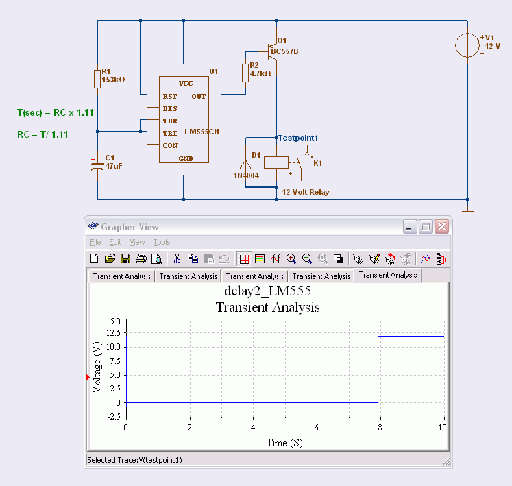

The formula for calculate TIME, as I have got from my SPICE Sim
seems to be:
Here you can see the result of my testrun,
with RC set to 8 seconds ( 47uF and 153k )
seems to be:
T(sec) = RC x 1.11
RC = T/ 1.11

This is how I would do it.
I always like to connect stuff like relays to GROUND.
And this is probably what we all like if possible.
One standard small signal transistor INVERTS LM555 out signal.
Resistor R2, 4k7, is important. When OUT gets low
there will be like 11.35V across R2.
And so the base current is limited to 2.4 mA and transistor is not destroyed.
Here is schematic.
Here is schematic.

I always like to connect stuff like relays to GROUND... one standard small signal transistor INVERTS LM555 out signal.
Your schematic looks good lineup.
This is exactly why my first schematic in my first post had 2 555s, to invert the signal.
Initially sounds more complicated than your version until you realise you can get two 555s in the one chip, ie the 556. I changed it to one on advice from others here.
I think both versions would work well (555 with inverting resistor or dual 555).
