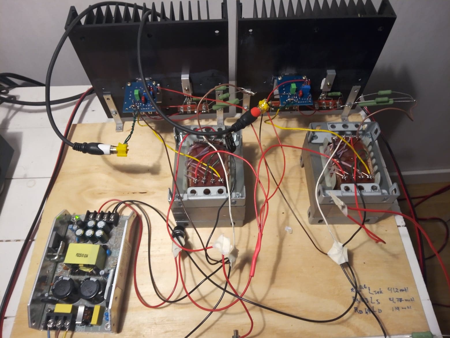

My cascoded LU1014 version is up and running, at least to some degree... The bias voltages are a bit off so I´m limited to ~5W and the darn thing oscillates when I turn the volume up too much.

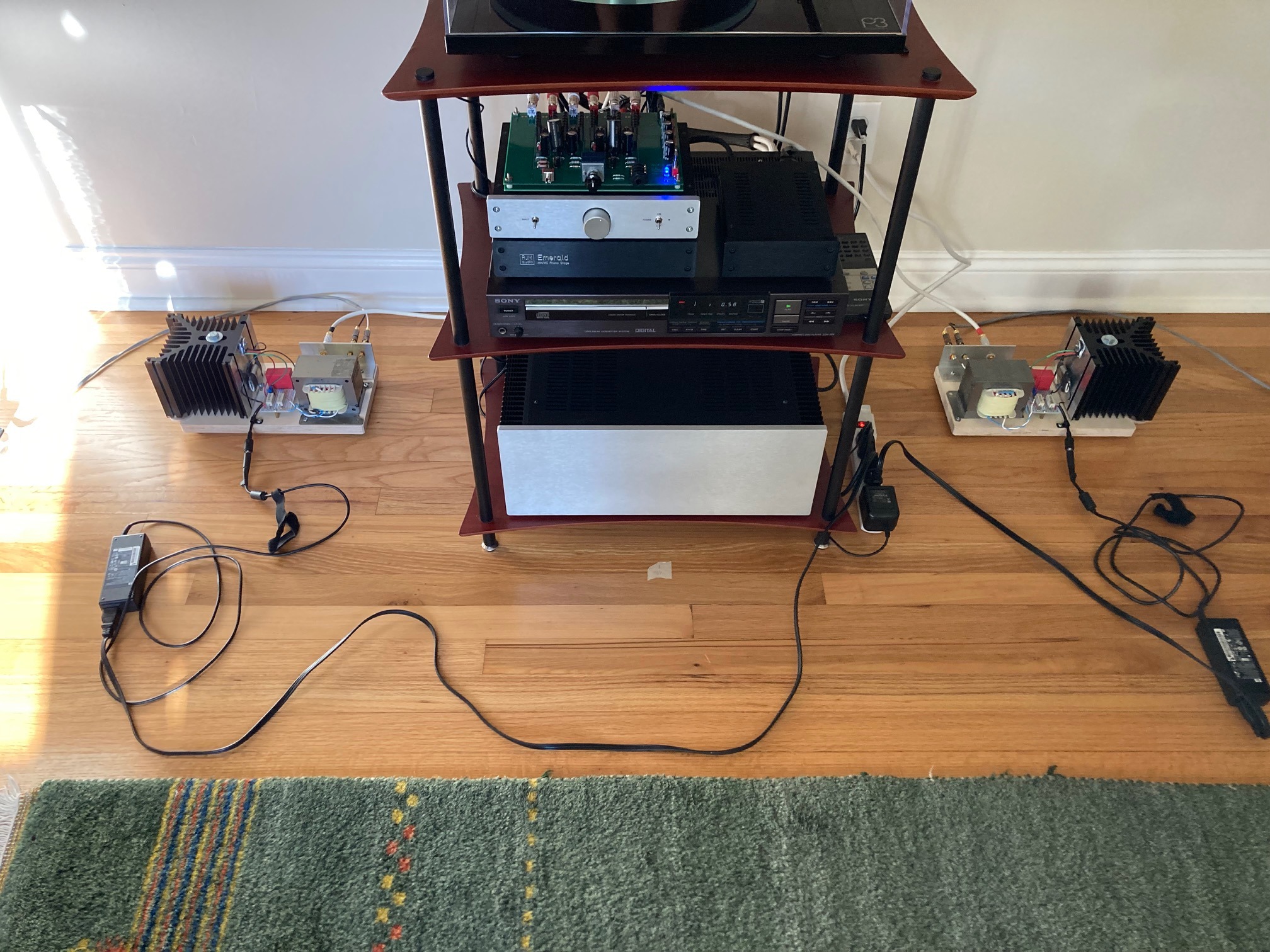

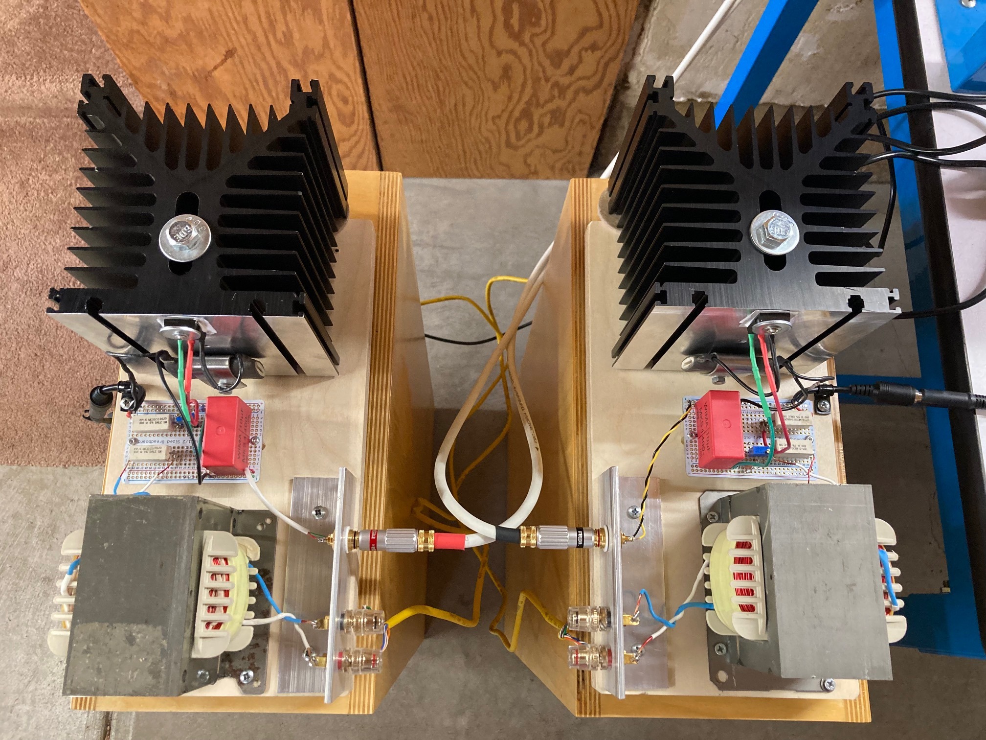

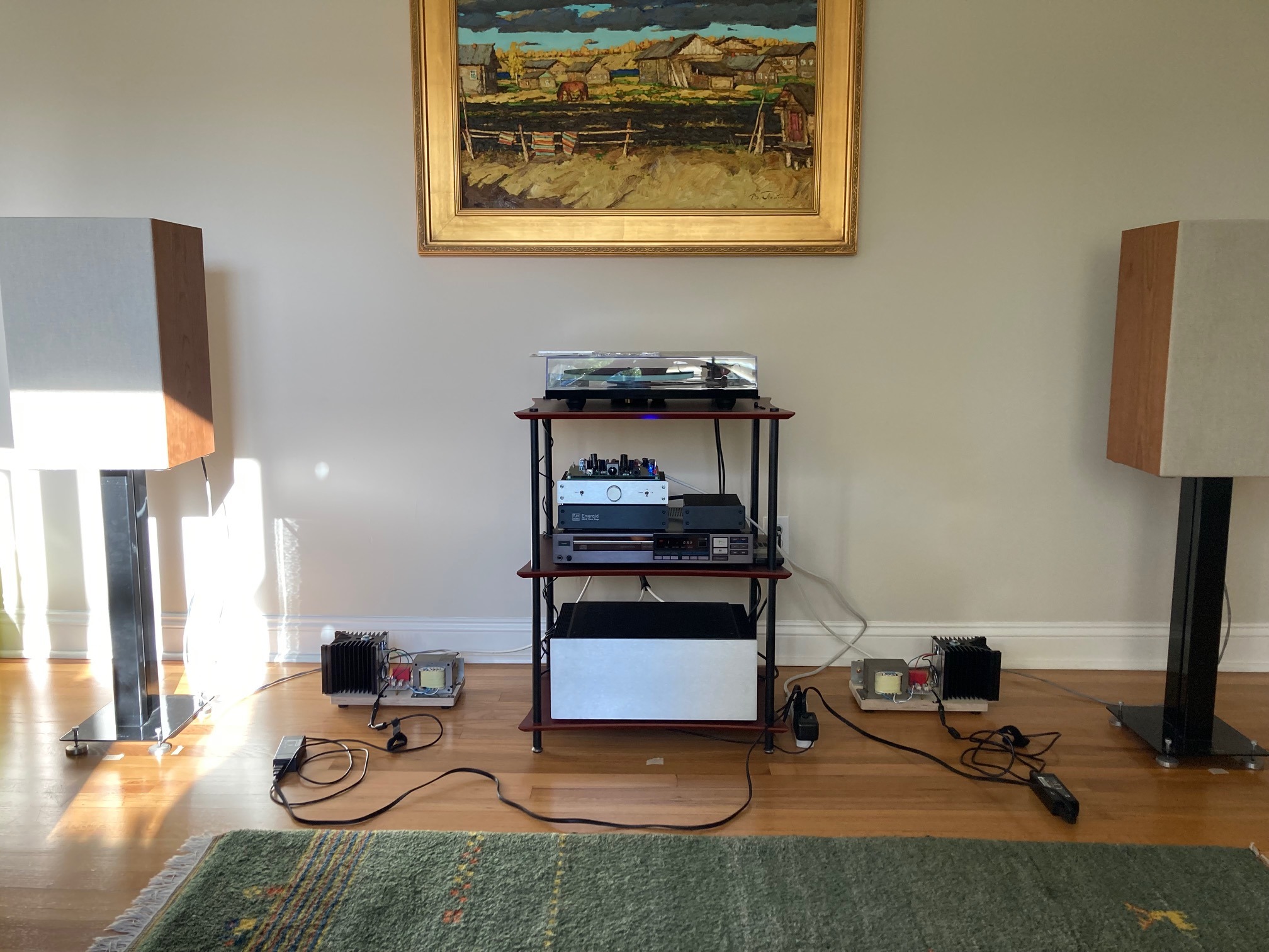

I recently acquired and built an ACP+, my one and only preamp with voltage gain, which totally changed my perception of what was possible with source follower topology like ZM's "Redneck DEFiSIT". I couldn't help myself, I had to hear the Arch Nemesis when driven with some voltage gain. So I made monoblocks in the style of M. Rothacher's MoFo, repurposing the heat sinks, the IRFP240's, and the salvaged ~19.5V IBM laptop power bricks I'd used in my MoFo build. The rest was filled out using leftover & salvage save for a pair of 1R 40W power resistors from a local electronics shop. I bent mounting brackets for the power resistors from scrap steel at a local maker space.

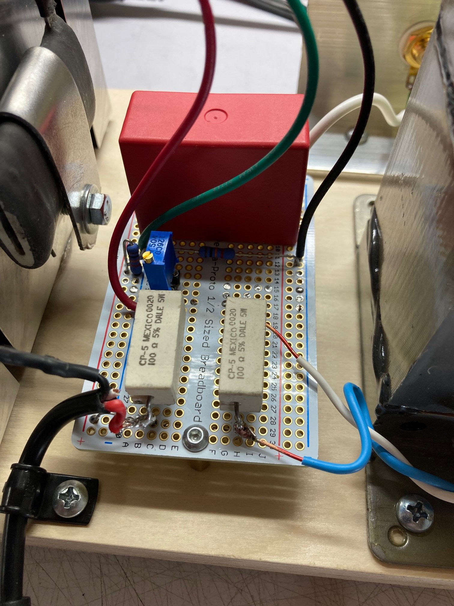

I needed a simple and dumb mechanismus for gate bias. It's a mere voltage divider between rail and ground, with the FET's gate taken off the midpoint of two 10K resistors, and a pot in parallel with the 10k resistor to ground, for tuning purposes. I fried the wiper on a 5k pot with a miswire so I turned to some 500k bourns pots in swappable pin sockets, in case it happened again. A gate bias of 6.12V and 6.22V respectively draws about 1.7A, but if those dumb pots fall out or go open circuit the gate will be slammed to half of rail, and those bricks will likely dump most of the 4A+ they're capable of. A fixed resistor may be in order.
These things sound really good, better honestly than they have a right to. They're full of bass and plenty smooth whether playing through full-range horn loaded drivers or 2-ways with series crossovers, whether electronica through bluetooth or jazz from an antique CD & player. I guess the lesson here is, if you've got a special project requiring a weird output transformer, don't be afraid to roll your own. You may be surprised with how good they sound.

ranschdow: There is no choke involved, just a transformer where the primary winding is split into two sections so that 30% goes between source and ground and the other 70% between drain and rail. Over at the Tubes forum we call it CFB or cathode feedback, it´s an old trick to make a mediocre tube behave like a very good tube, or in this case to make a lousy mosfet behave like a mediocre tube 😀
Re. the potting, I just put them in a jar of varnish and sucked the air out with a meat marinator 😀
The plan was to make a pair of nice layer wound transformers (with grocery bag insulation, of course) but I got lazy.
