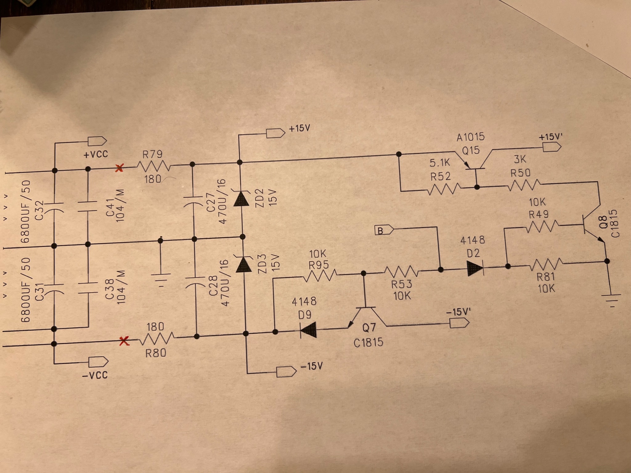

Sorry, what do you mean what are Vcc? They’re supposed to be a +/-15v, but are measuring +16.6v and -17.2v. The limit of the NE5532 is +/- 15v. So it looks like they are running it right on the limit. I’m wondering if the extra 3.8v between the two is enough to damage the ICs.

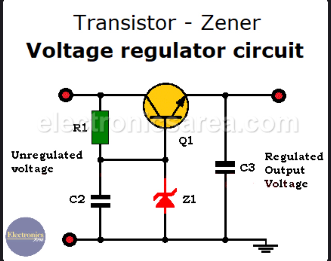

A transistor has to pass only the current drawn by the circuit; a series R plus Zener has to include current margin plus Zener current, so a pass transistor is advantageous re total dissipation.

3 terminal regulator or pass transistor, you need heat sinks of 15C/W or better on each. This should be practical. It’s better not to have the dissipation, but the only way to avoid it is another transformer. If using pass transistors, drop the zener current to 5-10 mA, and use any sustained-beta driver types. Those will have a gain on 100+, over a 1 mA to maybe 200mA range. You can’t expect all old BD or TIP types to be that well behaved.
NO. Transistors are just series regulators . Zeners no longer shunt. Cold circuit , even at 1A. 500mA can even run on a non-sinked TO-126,Hot transistors instead of hot Zener diodes.
just get barely warm. You actually trade both a hot resistor AND zener for a slightly warm transistor. The load is the shunt... very little gets
"wasted".
BTW , if you use an oversized zener cap - you have a cap multiplier/regulator hybrid. Most high beta trannies will work @1A with just 2-3mA
zener current. If you are only using the +/- 15 to run a few op-amps , I have used just a TO-126 or even a to-92 - just a little warm...

We already know current draw is less than ~ (30-15)V/180R = 83mA, corresponding to less than 1.25W.Oh, B+ and B-? They are + 30.4v and -30.6v.

The actual load current will likely be well under half an amp. If it is up at 500mA you still get a very hot transistor as JP states. The load current is probably in the 100-150 mA range, which necessitates a very hot shunt regulator or a moderately hot series one. The moderately hot 3-ish watt series one is tolerable with a 2 inch square heat sink that has a couple fins on it.
More likely around 50 mA. That is still 1.5W of heat so 0.75W per transistor. Way better than just with the Zener diodes. I would definitely use either TO220 transistors or 7815/7915 as these have adequate tabs to screw on heatsinks.

Here is the original schematic, I measured the current at both places marked with a red “X”. Right behind R79 and R80.
Here are the results, the 289 is measuring the +15v and. The 87V is measuring the -15v. At power up they were at about 75 mA each and settled to where they are after about 10 seconds or so. So 70 mA is roughly where it’s at. I hope this is accurate. Clearly im still having an issue and hope all of the ICs are drawing.

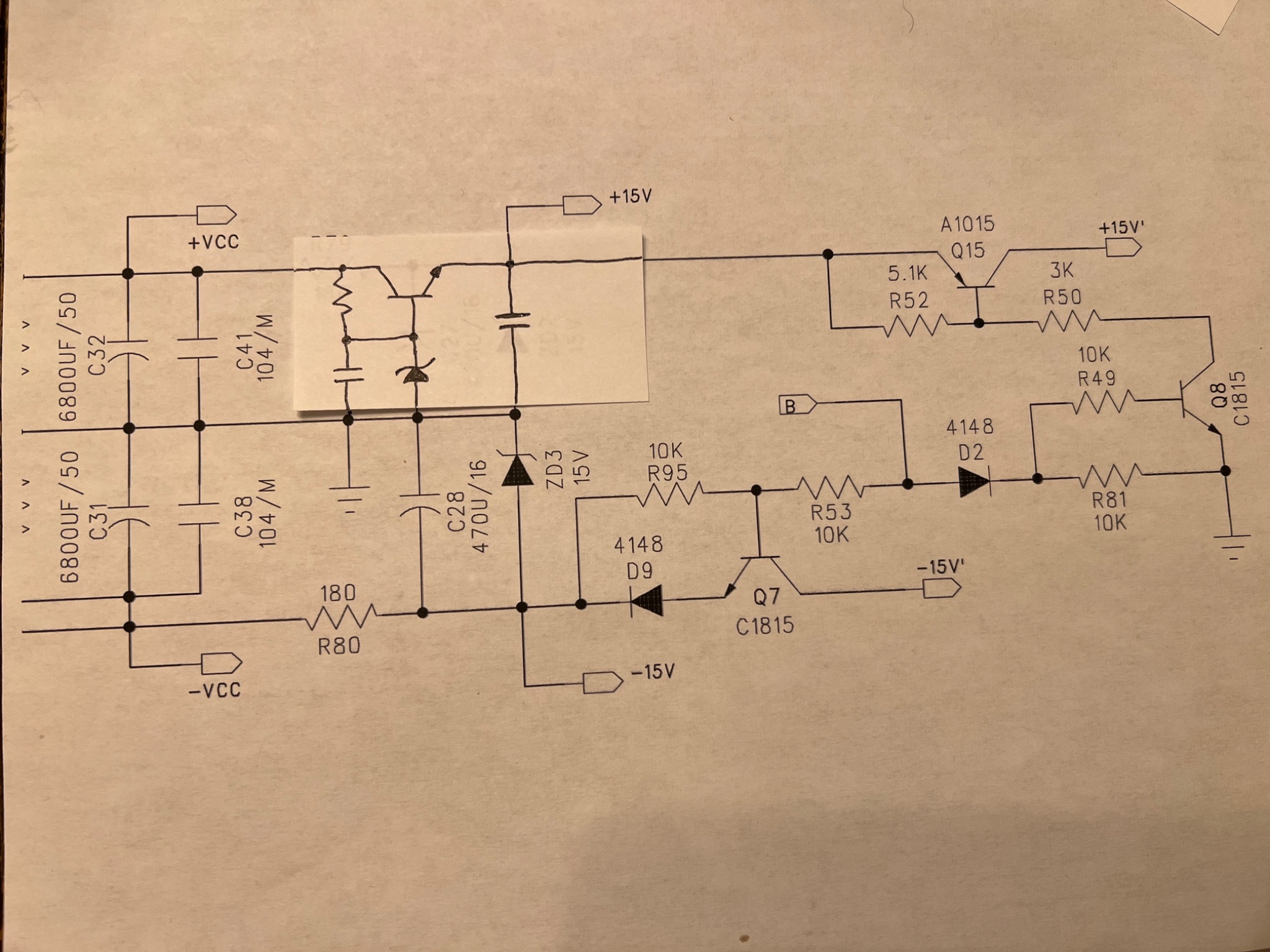

There seems to be some disagreement on how it should be converted, but if I were to use the methods that was pictured in post 56 is this how it would go? I only drew out the positive side. So the same for the negative side.
I eliminated R79 (80R) and wasn’t sure if I should take out the following 470 uF cap (C27). If that looks appropriate I guess I would just need to know what values? There are two capacitors and a resistor there with unknown values. Would I use a 15v zener, if so is 1/2w okay? Someone mentioned possibly lowering the voltage a little 14v, 13v, 12v thoughts? Just make it a little safer for all of the silicon. Lastly, appropriate transistor. Looks like TO220 is recommended. What I currently have on hand in multiples for TO220, as far as BJT.
