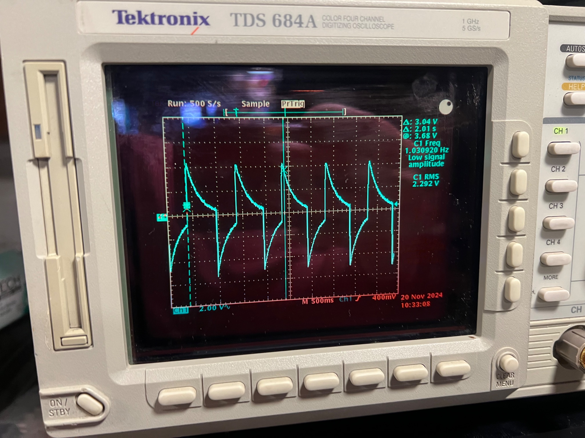

Would you confirm my estimates of Q2 voltages? Further, Q2 should be conducting and powering a multivibrator, Q3 and Q5. The output "A" should be generating a low frequency square wave, but I don't know its purpose.

Here is what I see on “A”. I don’t know if it was the signal or what, but my scope was lagging. It was taking a good amount of time for the signal on the screen to catch up with what I was doing as far as time base and such.

Is your scope AC coupled?
