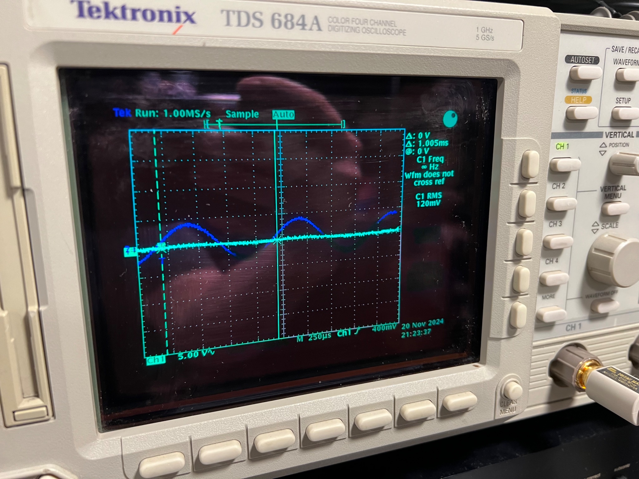

Is your scope AC coupled?
I guess I'd install the board that passes the B signal for quick insight.
Good luck!
I believe it’s actually DC coupled at the moment. I can AC couple it if you wish.

DC coupling is best here. The scope waveforms are what I'd expect at the bases of Q3 or Q5 rather than at the "A" terminal. Probably not worth a lot of attention at this point.

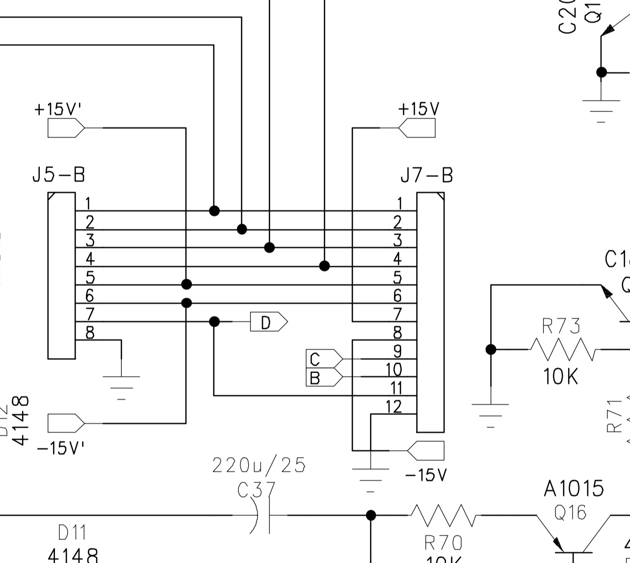

Thanks @mikeAtx! If I'm not lost in the maze, the A and B signals show up at an LM324, U5-D. In turn, this prompts the question what is nearby switch SW5 about? [This opamp output drives the Q8 enable.]

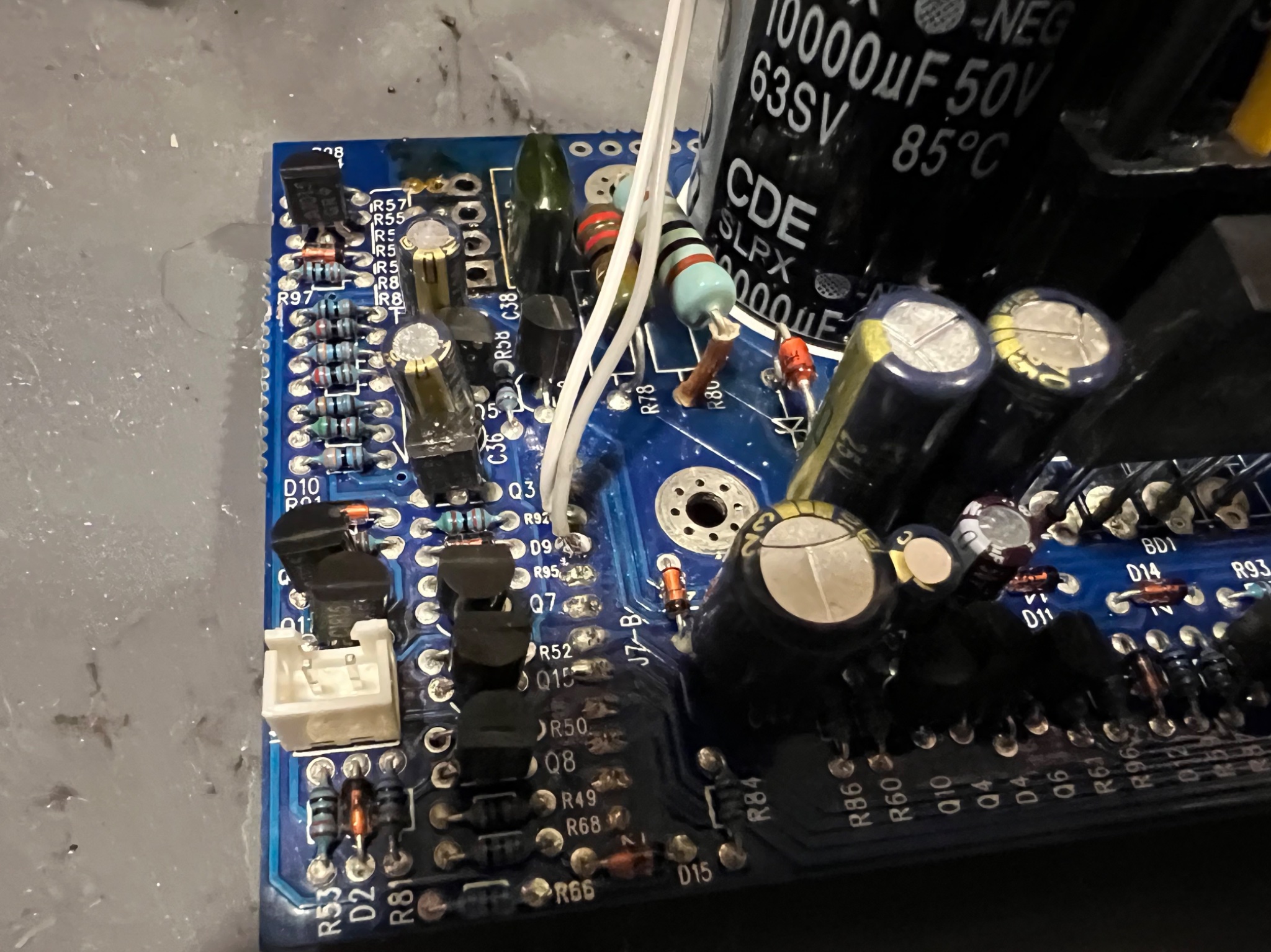

With this info, I think a low-risk experiment would jumper the A and B paths that flow through the PA board. Then power could be applied without installing the PA board. I still suspect a significant fault somewhere in +/- 15 powered circuits that drags down +15 rail. Please check my thinking.

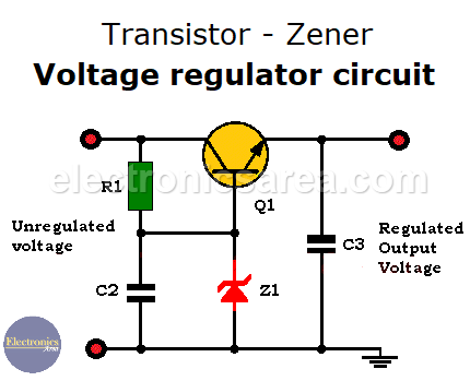

Post #19 shows Zener outputs at +18.2 and -18.4 volts,slightly jumping the absolute max rating of the LM324 and other opamps they power(hope they have survived).This is with the standalone psu board.
Why aren't the zeners regulating to their rated +-15V?

DC coupled it will stay. so I jumper the “B” and “C” connectors as well as plugged the input board pin header. I can’t physically see them, but all of these ICs must be on that input board.DC coupling is best here. The scope waveforms are what I'd expect at the bases of Q3 or Q5 rather than at the "A" terminal. Probably not worth a lot of attention at this point.

If you applied power, what voltages diid you observe at U5-pin 14 (i.e. B) and at Q8 collector? If U5-pin 14 isn't around +10V, what voltages on U5 power rails and voltages at U5-pins 12,13,14?

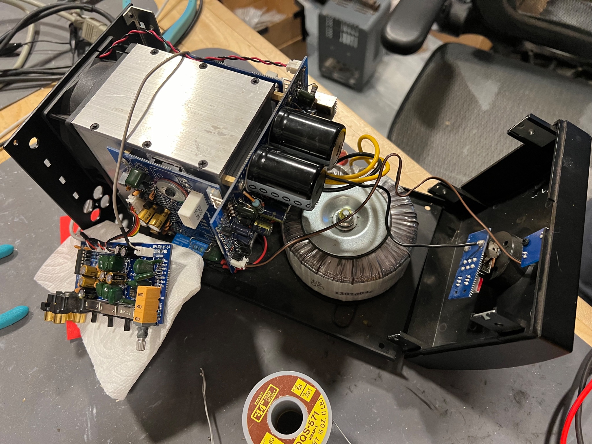

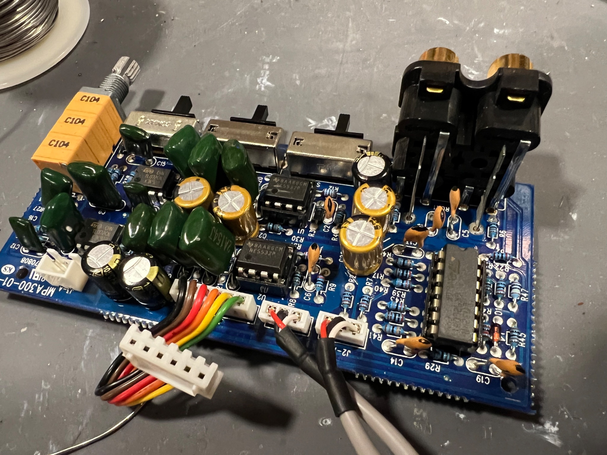

I pulled the input board to check it out.

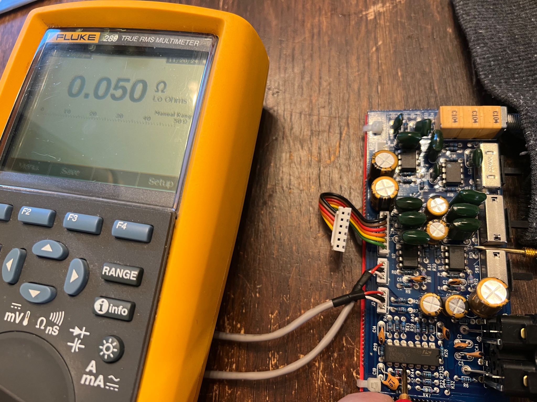

Here I am measuring the resistance from ground to +15 V rail on each of the chips.

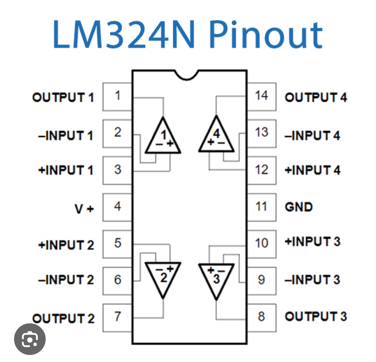

But I am getting an odd reading on one of the chips, and maybe this is the problem? It’s an LM324N. According to the pinout the +15v is pin four. And directly across from it should be ground, pin 11.
On this IC pin four does indeed look to be directly connected to the +15v. Pin 11 has no continuity to ground at all. It’s actually pin 10, the third pin up from the bottom where I get a short to the 15 V rail and a short to ground. You can see my probe is touching the switch body and my other probe is on pin 10 of the chip. Is it possible that the chip lost ground so then one of the inputs shorted to ground? I don’t really get what’s going on here.
Oh, and I plan on replacing some of the capacitors on this board. I get his intentions, but some of these are just for smoothing and would do well with something like a Panasonic FR. These are just too big physically.

B also goes to a tiny board with a transistor, resistor and diode and creates C & F. And good catch, 324 not 339. I guess I was thinking it must be a comparator switch for the P/S. I'm kind of lost on what they are trying to do.

I've not found specified where pin 11 of the LM324 is connected, but predict that it's tied to -15V Zener; that would allow pin 14 to swing to the negative rail and disable both Q7 and Q15.
LM324 and LM339 are different animals, different pinouts, and won't swap.

Yeah, I figured, I took a look at the data sheet and figured it wouldn’t work. I was rebuilding the board and found the short. It was coming from a capacitor he had placed in there, you couldn’t see it from the top side, but the legs must’ve been touching or something. as soon as I removed the capacitors, I was planning on swapping out the short went away. Before I had replace the capacitors, I removed three of the chips and found the short had not gone away. I installed sockets instead of soldering them back in.
The capacitors that I replaced were C22, C23, and C24. They were all called to be 220 µF and I installed 330 µF as these are Panasonic FM and fit better than the 220 I have. I figure the extra capacitance isn’t necessarily a bad thing.
To the chips I removed are U1 and U2. It looks like they’re the first stage of amplification for the input. They are using NE5532P. Since I have them in sockets, anyone think I should try different devices? I have a ton of NE5532AP which is supposed to be a lower noise version, I could put a couple of those in there. Or maybe a couple Burr Brown ICs? Thoughts? With the short eliminated, I’m going to try to put this back together somewhat powered up and see what voltages look like.

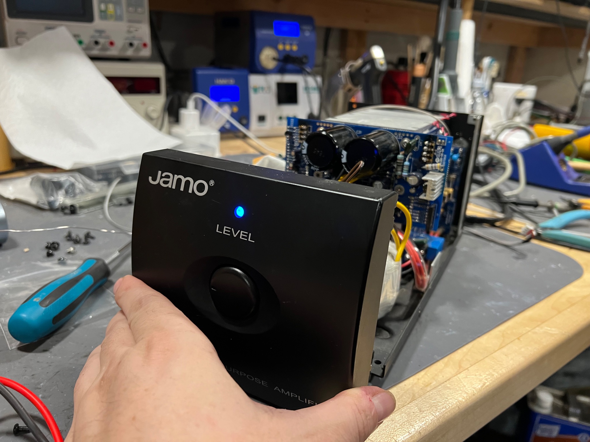

I have it all assembled as far as wiring, boards are still hanging out off the side. Electrically it should be good to go and time for a power up.
And we have first signs of life!!!

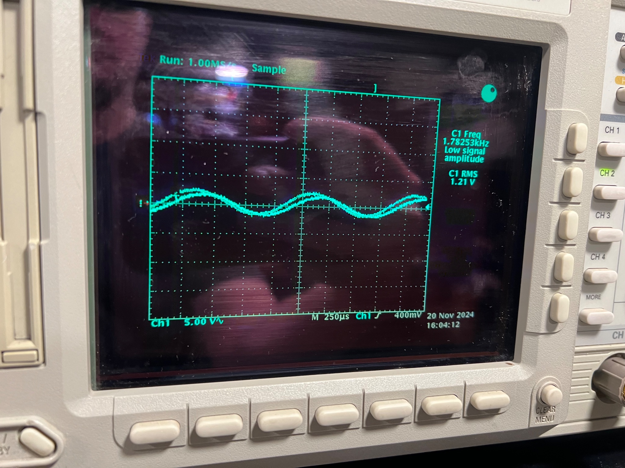

I wanted to see if it was ready to go and it definitely is not. Once you power it up, it’ll stay powered up, but you breathe on it and It goes into protection. I fed a signal into it and for a split second you get output, but then goes into protection.
The signal I am feeding is 500 mV and it’s something in the amplifier sing. So something is resonating with the signal. I will power it up in a bit and check all of those voltages again to see where they are at.

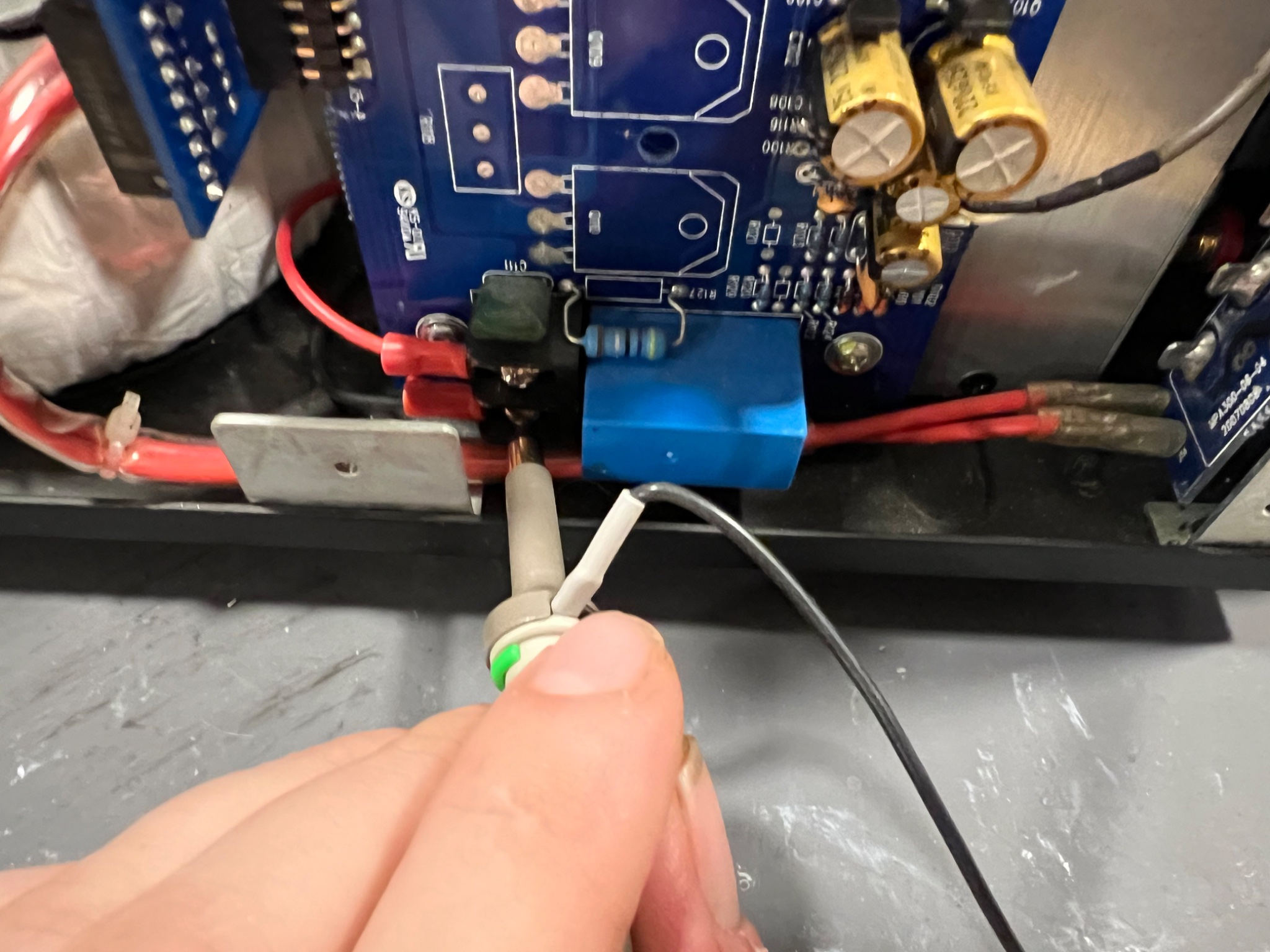

Here are the two pin headers and the voltages on the pins. I went ahead and measured every pin. All of the rails look to be in line.
Same here, all look good with what the manual says, though pin 8, the -15 looks kind of high at -17.29.
Dan
Dan
What a cheap lazy design , all they would need to do is use 2 more transistors (EF follower zener regs) to make for a real cool
aux supply. Zener can run cool with just a few mA's...
PS - and running the op-amps at 15+ V , they only need a +/- 12V supply to do what they do.

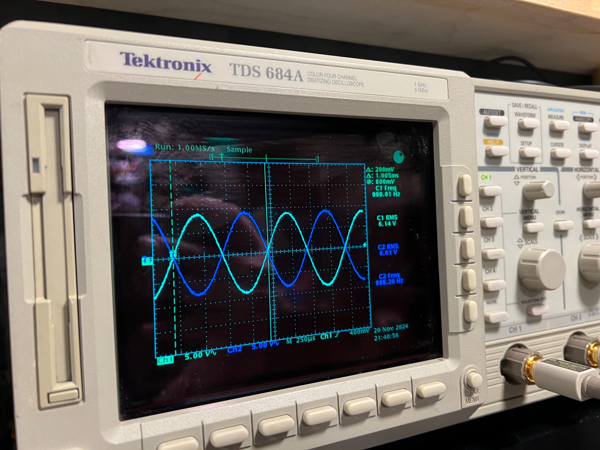

So I think the amplifier is working. The reason it kept going into protection is because I believe one of the channels is wired out of phase which meant the ground probe of my scope was on the positive of the output.
I am not sure why this is, maybe because of the ability to be bridged. I disconnected my probe from one channel in order to trace a signal through the amplifier, and as I turned up the volume, I noticed I was getting a wave form on my scope from the one channel that was still hooked up.
So I thought great I am one channel that is working. I picked up ground from the inside of the amplifier and found I had a single going into the other channel input. That’s when I noticed that the black wire that connects to the negative of the channel is actually connected to the speaker relay. if I stuck my probe onto the red positive wire, I saw nothing on the scope, but if I touch the black wire, I get a signal. It is out of phase of the other channel.

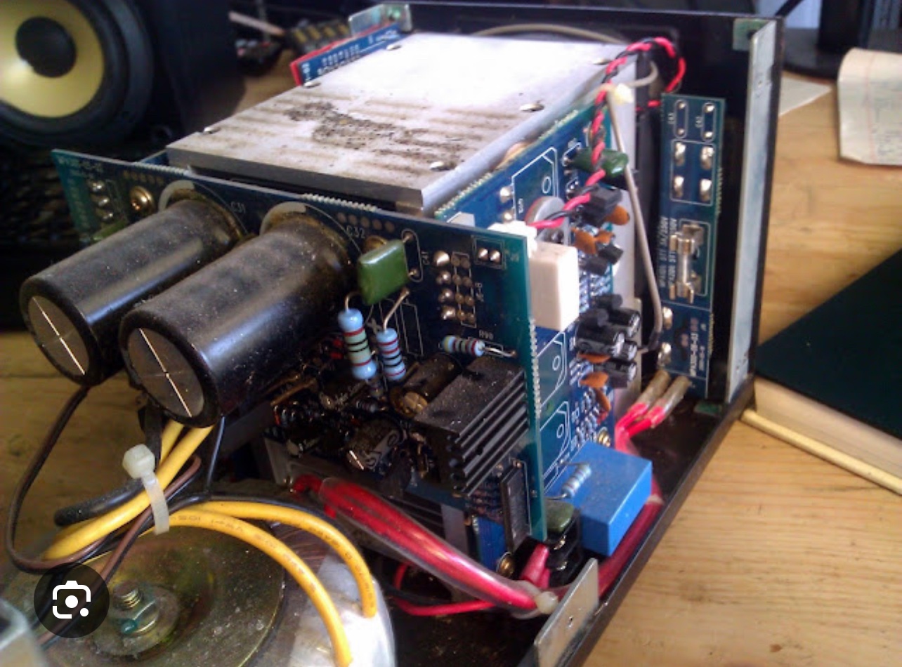

I looked for some photos online and saw the inside of somebody else’s amp and sure enough that that amp was wired exactly like this one with the red wire on top. It is kind of hard to see, but if you look closely, you can see the red wire is connected to the top screw terminal.
So is this right? As I thought about it, it made sense to me, since it’s out of phase when I touched my probe to the black wire that would mean it would be in phase when hooked up to the speaker terminal.
