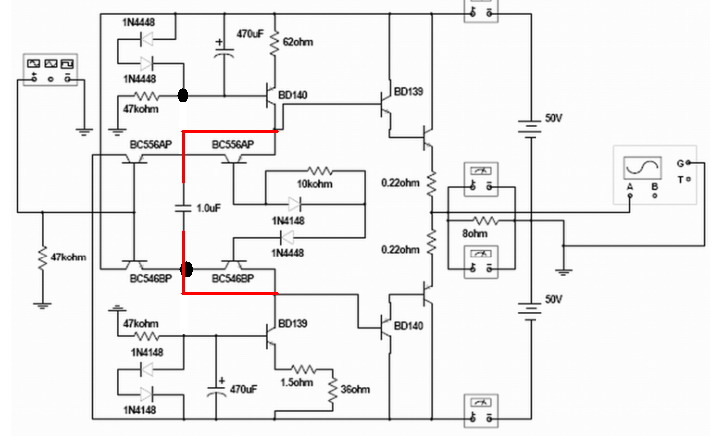

Lumba Ogir said:Steve Dunlap,
You're missing something.
What?
ASKA ask if he was missing something. Since he designs and sells his own amps I felt he would figure this out on his own. This was to encourage him to take another look. I did give him a clue.
This is a DIY site. The threads I have read so far do not go into great detail about operational details of a design. I do not want people to get hung up on how the circuit works. It does work. It works very well. It is capable of low distortion very wide bandwidth, very low noise and low output impedance all with no feedback. It has low parts count and will work with an assortment of voltage gain stages.
Steve
Thank you Steve,
I will work it out. I'm sure it does work, and have faith in your assessment.
Hugh
AKSA:
In case you missed it, the clue is the fluctuating current in the bias diode.
I don't want to give away everything without making you think about it first. I think you will figure it out.
Steve
Steve

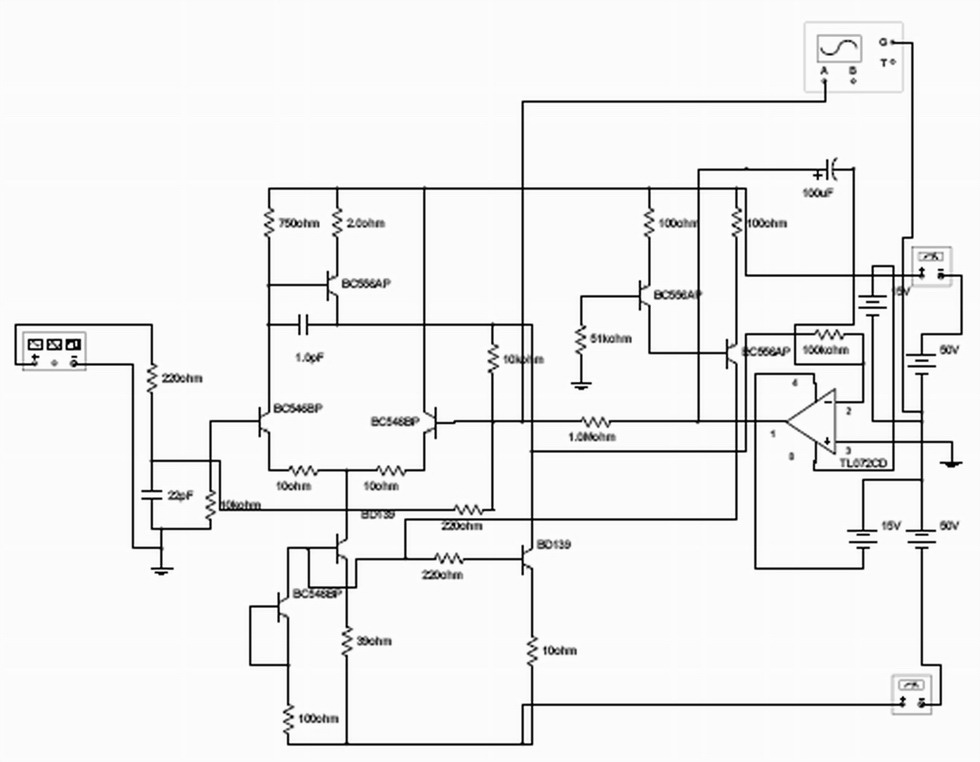

Carlos:
I checked your latest schematic and I see you figured out how to adjust the offset. Good work.
Steve
Steve
Yes, I'd actually worked it out Steve, at 80uA, as bias current drops further with the engagement of the active driver, the drop across the diodes increases at the same rate as the Vbe across the outputs, thus widening the bias voltage with increasing output current.
This keeps on the inactive driver, and hence, output device, making this a non-switching output stage.
My concern is that this phenomena will be very sensitive to temperature, and indeed diode and output selection.
BUT, notwithstanding, this is the simplest means I've ever seen of ensuring no output turns off - a worthy feature. I have long pondered this issue, and with Phase Accurate devised a much more complex scheme to achieve the same thing, but it's untried, and has high component count. It is single ended, with a sliding current sink, and uses a CFP output configuration. I have always favoured single ended for its benign distortion spectrum.

AKSA:
Temperature sensitivity has not been an issue for this design. The choice of semiconductors does affect performance, however once you set up the circuit with one type it is a good idea to stay with that type. Still, the changes are quite minor.
My condition is a result of a degenerative bone disease which has claimed 7 of my vertebra in my neck and upper back. This along with 4 surgeries to repair/remove them has done considerable damage to my spinal cord. Other bones are going away also but they mainly just cause great pain.
Steve

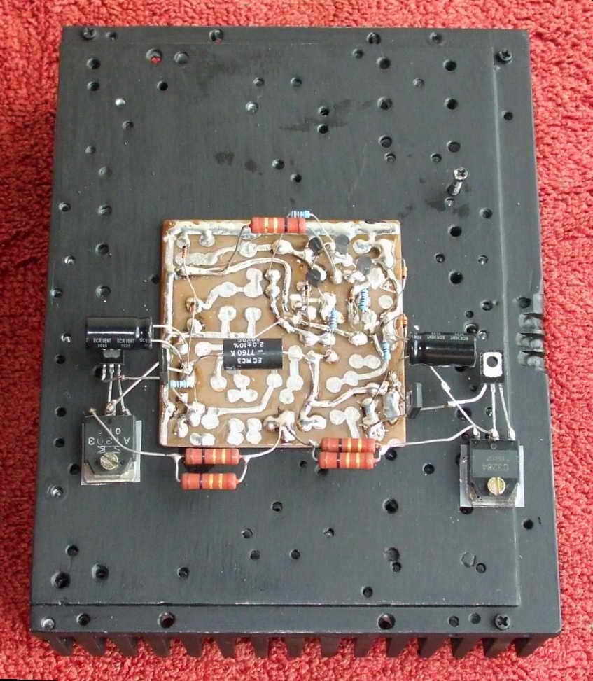

Re: The output will take a good nap...will take a rest till December
Hi Carlos
alitle offtopic but how do you make pcb's like that , i will love to learn that 🙂
destroyer X said:
Well.... it is assembled.. and for sure will operate.
I hope some forum friend assemble following Dunlap instructions.
I will be studying.... each day i turn more intimate with this circuit.... it is not misterious anymore as it was yesterday...maybe in couple of days i will understand it entirelly.
Well... i am watching and thinking for hours long... even not beeing clever, everyone of us, studying, will understand.
Carlos
Hi Carlos

I will try to explain you very fast Valo, as this will be off topic for this thread
Needing details, more details, come to my mail:
panzertoo@yahoo.com
First you take the schematic and watching it you produce a sketch using a piece of paper or trace lines with special pen directly into the board's copper side.
It is a very fast and simple method i use since the fifthies.
Put dots to remember you how many component leads will be soldered into your soldering spots.
this way.
Carlos
panzertoo@yahoo.com
this way.
