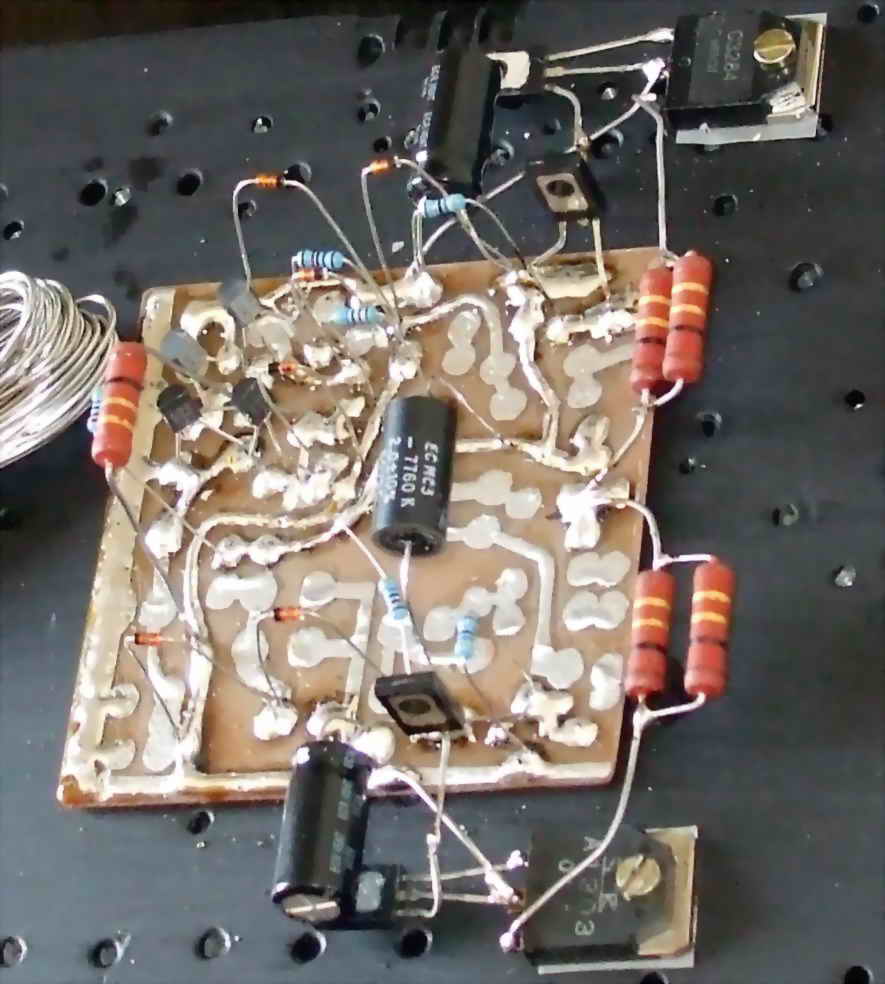

The circuit seems not complete for a while
I have not understood how it works, because of that i could not make the needed adjustments on it.
I had, almost this same schematic, in my hands years ago... was an idea from Bridges, Anatech our moderator... and i could not fix off set and bias, reason why i have not tested his circuit.
As Dunlap said, the schematic is not new.... it appeared first time almost 30 years ago.... so, others have made, have created same time, have developed and have used too.
Wrong resistance (bias) into my schematic is because i was trying to adjust bias... i could not..... my circuit seems wrong... no feedback?
I will be following the thread with attention, and will read Dunlap text once again to find clues, tracks to deduce my doubts.

Be sure.... after 10 minutes Dunlap published
.... the entire final schematic....the amplifier will be playing here.
Life is short... i do not waste my time...i am already old.
This wrong, and basic frame of the schematic will be assembled
NOW!

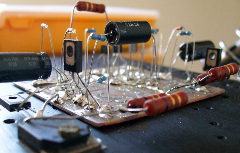

Carlos,
Is that what you were looking for? Is the music as you remembered it?
It is mind numbing to think you started this whole thing with a request originating in Brazil and through the help of a few good folks was able to find Steve and this circuit. The wonders of the internet and friends. These things never cease to amaze. And in only a few DAYS!!!

Well first I have to say OOPS. The 1uF cap Is in the wrong position. It should connect between the bases of the Darlington output pair. R4 should be a 10K variable resistor. Start with it set to lowest value and increase to set bias.
Carlos:
Of course it needs gain. I said it was the output only. Offset is mostly controlled by transistor matching. There is an easier way and I will get into that as the circuit progresses.
Ask by Lumanauw:
1. Anode of D1 (//withR4) and cathode of D2, are they only going to bases of transistors, and not going anywhere else? This mean the current passing thru D1 and D2 only come from leaking current from transistor bases?
That is correct. With the transistors I am using this is about 80uA.
2. The emitor of first darlington, they connect just to base of second darlington. There is no resistor to the output node.
Is this on purpose to prevent turn-off (no discharge path for base charge of final transistor due to no resistor from base of final darlington to output node) or is this because the above drawing is only a basic schematic?
Yes this is on purpose. This may be a basic schematic but it will work.

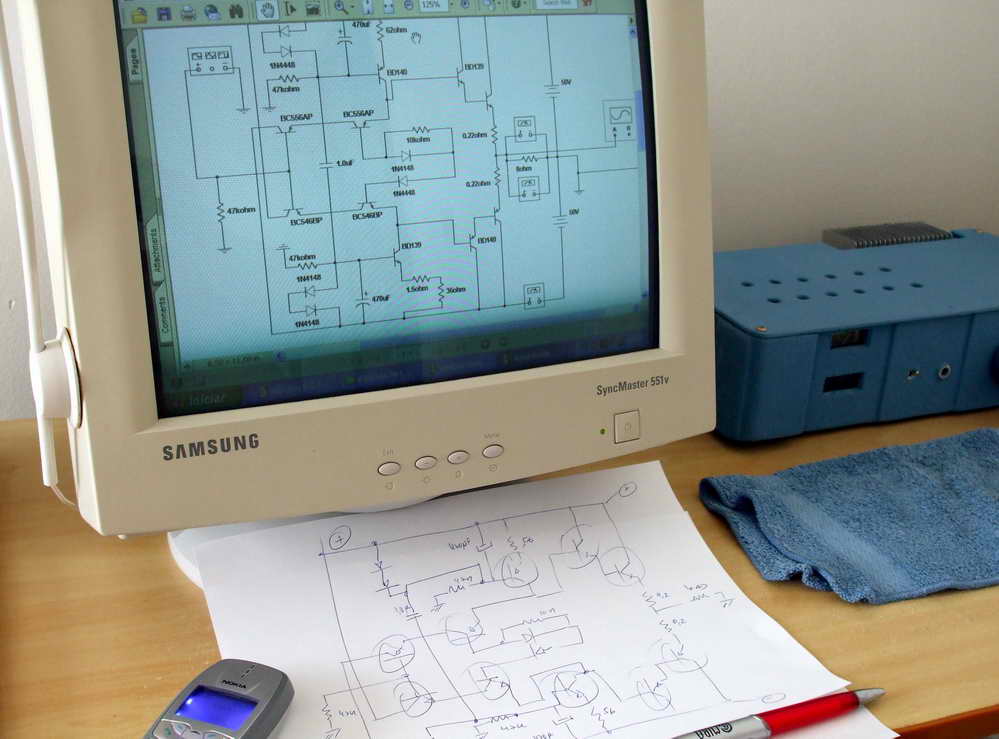

Ask by AKSA:
As I see it, the two current sources do around 12mA each, but as one output side turns on hard, increasing Vbe, the bias voltage between the two Darlington bases remains essentially constant, and so the inactive side turns off, the more so since the current through the bias diodes actually decrease owing to the drive current into the active darlington base (usually not more than 2mA max).
I don't how you get 12mA. With the values shown the current (real world) is 10.4mA. Yes the current through the bias diodes varies with output drive.
This means that the crossover disjunction is slightly better than most Class AB amps, but the switch off of the inactive side is still an issue, surely? Or am I missing something?

Posted by destroyer x:
The circuit being called Diamond Buffer has been around over 30 years. I added the Darlington output and the bias circuit over 20 years ago. It has been refined very much since then.
Steve

Is this the final schematic Steve?
It needs gain, are there more parts to attach or i have to produce a voltage gain stage?
Is this one the final one?
regards,
Carlos
regards,
Carlos
This was the starting point, not the final. Yes it needs a gain stage. I explained why I didn't post mine. Use one you are familiar with so you are evaluating the output stage only.
