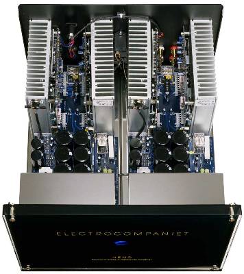

homemodder said:One crazy day I ll take the lid off the Nemo and see what exactly is inside.
Take a guess.

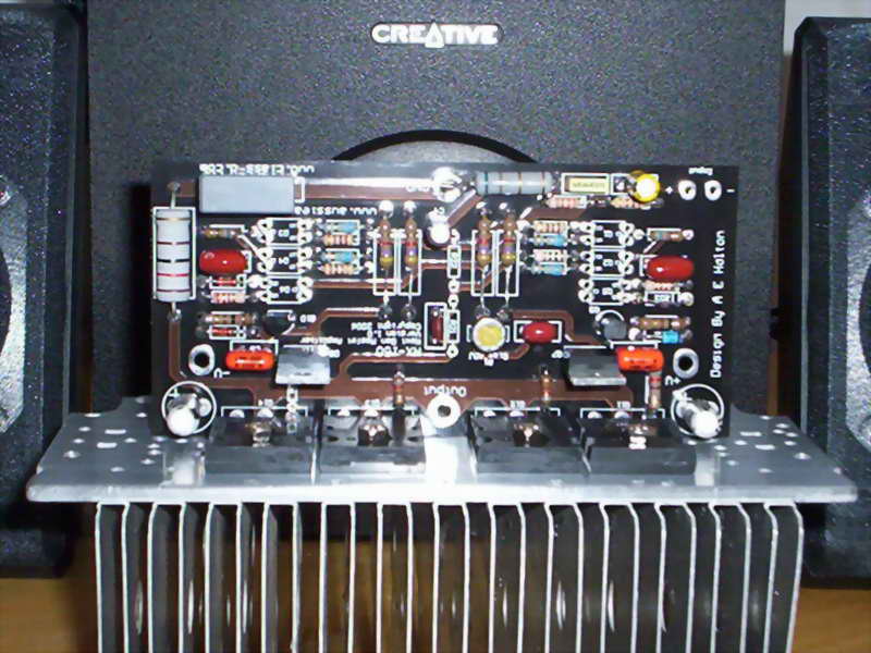

About Fets... i have tried some.... but i am not experienced with them.
I see that in Italy and France people loves FET amplifiers, i was into the internet searching for French and Italian designs and i could see that...and this happens since many years ago.
Anthony Holton 150 amplifier, using Lateral fets sounded nice, despite i had to adjust it with more current than i was intending to use as iddle.
