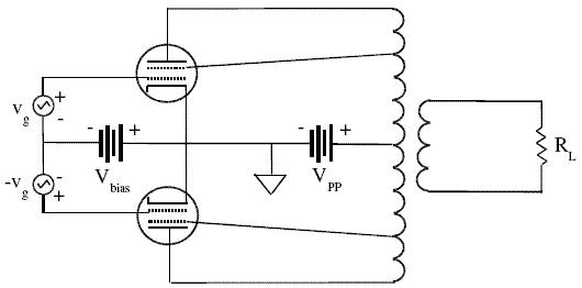

Ultra Linear Operation Explained

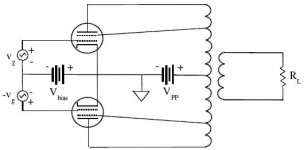

Danny Hall - Please disregard my last post asking about UL. I have just reviewed a few sites and I now have a 200% clearer idea of what this is.
The centretap on most transformers serves as Ground, as is the case in the 196x Rickenbacker M-30 and the 195x Standel 25L15.
BUT this does not necesarily mean that the transformer has UL taps (leads coming out of the tranny) at the 43% mark - the very thing you need to create UL, as each of these two(2) leads (at 43% in the tranny) each go to the screens of each tube.
Here's a good site for others seeking clarification:
Ultralinear Guitar Amplifiers
Thank you,
Frank

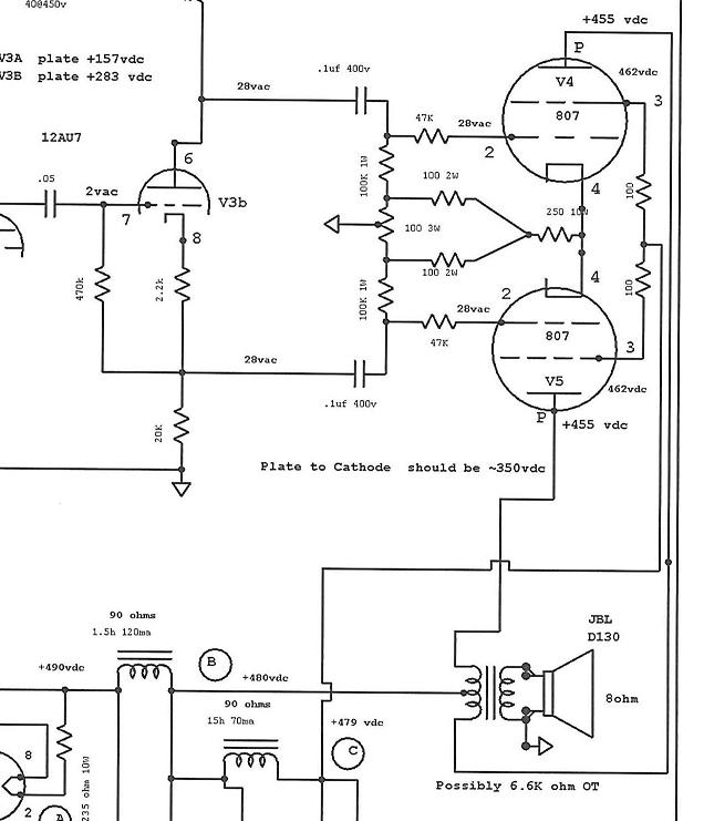

Frank, 460VDC signicantly exceeds the screen voltage limits on the 807. Has that caused you any concern or early tube failures? I'm thinking of adding a regulated screen supply to keep the voltage closer to its 300vdc limit.
Scott is right my build will not really be a clone, but I'm trying to build it as near as possible as I can with the snippets of schematics that have been floating around.
Jonathan
Frank may have meant 260v, not 460 (typo/fat-finger?)... 460 wouldn't have even been electrically possible using the 700vct transformer and the power supply circuitry of the original. (The screen voltage is taken off the B+ through a 20k ww resistor to one of the 20uF 4-section filter cap sections.)
With a Hammond 273BX and 5U4 rectifier, I'm measuring 425v at the 807 plates and 240v on the screens with only one alteration of the original schematic - the addition of a 36k 2w bleeder to ground on the screen line, just upstream from the 100-ohm screen resistors. That's a change I had to make earlier when I used a 750v transformer from an old Williamson amp and found the screen V too high, and had to modify the circuit to drop it. I liked the result, as it provides some extra regulation for the screens, but it works fine without the bleeder, too.

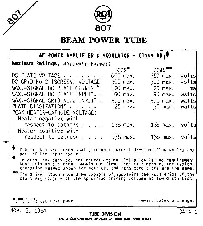

Last winter I found the sweetest power transformer: New In Box never used 1950's Hammond 273BX. Came with the original manual, 30$ from the guy!!! It's got the old matt black Crinkle finish on it, and the metal badge logo on the front. It's B+ tap is 350V per side (push-pull) and centertapped, and I can get around 175ma maximum current draw. The new ones that Hammond makes get around 201ma. max.
For the Output transformer, I like the Hammond 1650PP. It is a special 10lbs Potted Transformer, Primary Impedance 6,600 c.t., 60 Watts power rating, 200ma MAX DC per side, 4-8-16 Ohms speakers, and is listed as useful for 807/6L6/5881/KT88/EL34/6146B/6550B tubes. Since the output transformer's inputs are fed from the 807's plates, I looked up the 807 tube specs from RCA. Their spec sheet for the 807 tube (http://sarris.info/main/files/807rca.pdf) indicates that the MAX DC Current for the plate is around 125ma., so I think that if this OT handles up to 200ma, we're okay.

Screen (Grid #2 - PIN #3) Voltage
Jonathan
Hi again Jonathan!
Yes, 460V is way too much. But if you look at the schematics, the B+ coming in to the screens (Grid #2 - PIN #3), has a resistor going to each screen. There are always a set of identical valued 1 Watt resistors here. I have a few schematics, some indicate a pair of 100 Ohms, others show 470 Ohms (any ideas on what was used originally?). Either way, doesnt the voltage divide itself? that is to say, 230V X 2 = 460V. As you say, the RCA Data Sheet indicates that the Grid #2 (screens) can handle up to 300V, and the plates can handle up to 750V!! See the photo on this posting for the Data Sheet.
Apologies for any confusion this may have caused, and I always more than welcome any corrections to anything that I may post in error.
Thank you,
Frank

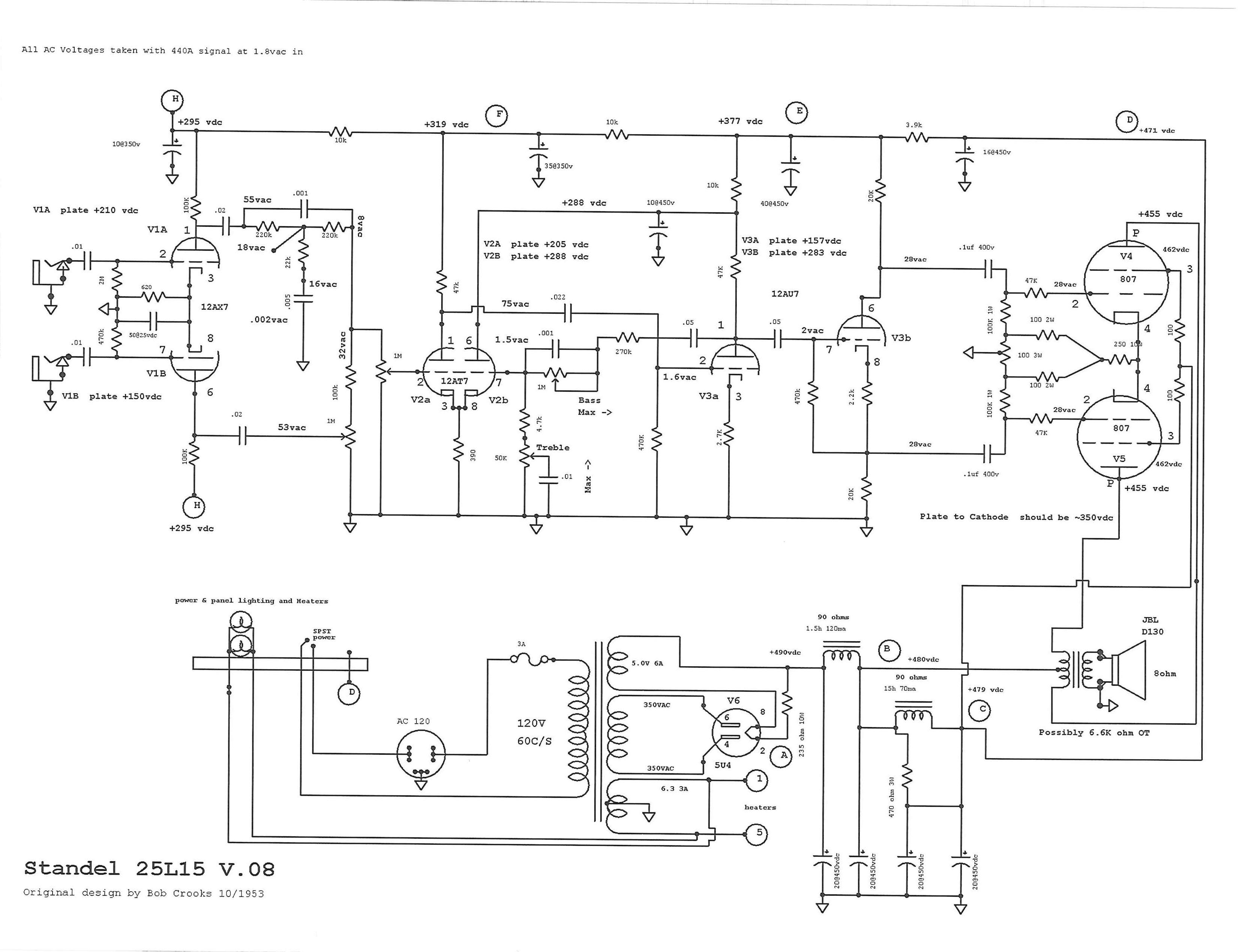

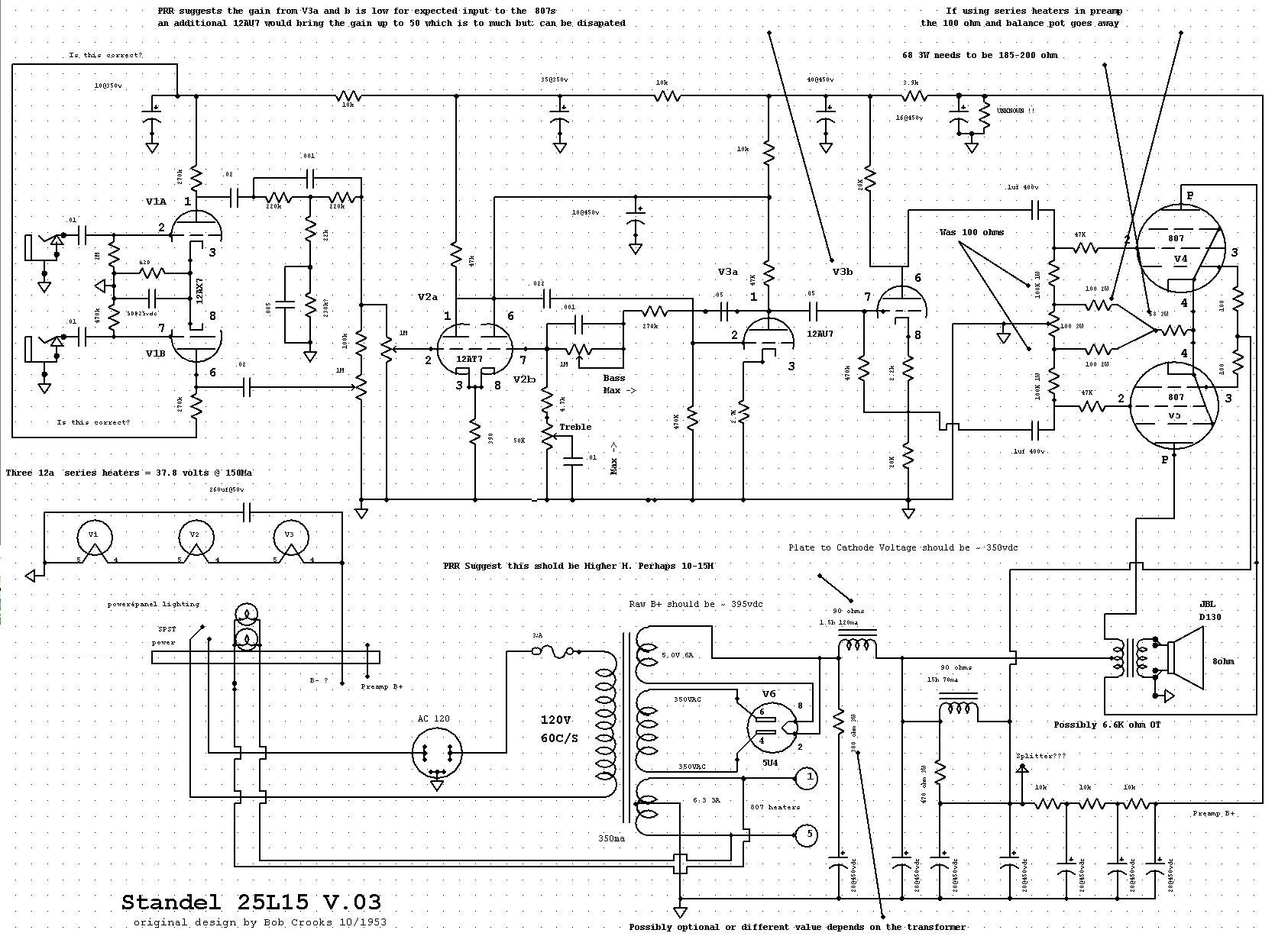

Bobo crooks standel 25l15 schematic
Hi Ben,
Not a problem! I thought that most people already had the full schematic from one of my many other postings.
Posted here now is the rare 1953 version of the schematic.
Also, find 2 versions (0.3 & 0.8) of the same schematic cleaned up by a friend.
Cheers!
Frank
Hi Frank,
That is a beautifully clear image of the Bob Crooks schematic you just gave us a cutout of. Be a sport and post the whole image would you please,
Thanks Ben.
Ben, be cautious with these schematics - the "original" has a few errors, and the "cleaned-up" versions have many. Case in point: the balance pot in the 807 input circuit has nothing to do with the preamp filaments; it is there to balance the idle current on imperfectly-matched 807's. Many of the parts values are way out of line - the 100k's on either end of the 100-ohm balance pot were (and should be) 100 ohms; I doubt if it'd even work with 100k's... The cathode bias resistor (nominally 68 ohm 3w) may need to be slightly higher or lower, but probably not as high as the 180-200 ohms suggested in the "new" drawing. On the original drawing, the 6-pin Jones plug is wired incorrectly (the way it's shown, both ends of the preamp filaments would be at ground - they're really connected to pins 5-6. Pins 3 & 4 are for B+ and ground. The pinout of the 807s is wrong. I could go on...
But if you know what you're doing, you'll recognize a lot of these "mistakes". The problem is that when you find an obvious error on a schematic, you can't always be sure of the correct wiring. I've never been able to determine if those alleged "original Bob Crooks" schematics (I found copies about 6 years ago and realized I couldn't build an amp from them as drawn) are simply fakes or whether Bob inserted the errors purposely to prevent others from stealing his design. Based on what I've read, and how he started encapsulating portions of his later solid-state amps in color-coded "modules" to further disguise his schematics, I suspect it's the latter.
The only schematic of a 25L15 that I trust is one "reverse-engineered" from one of the original amps, and from which an amp that cannot be distinguished from the original has been built.
Bud

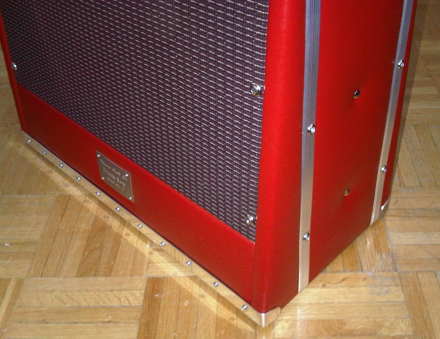

My Cabinet Is Complete

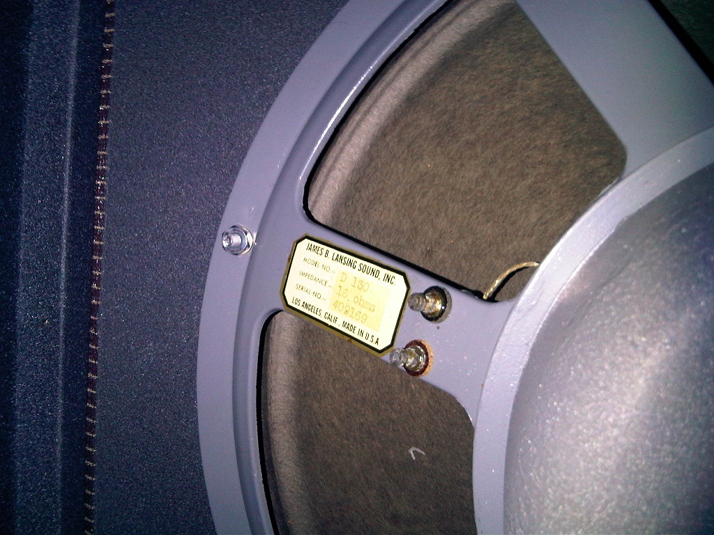

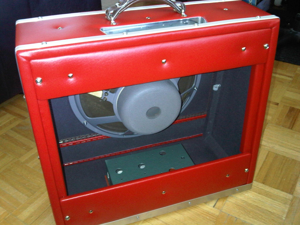

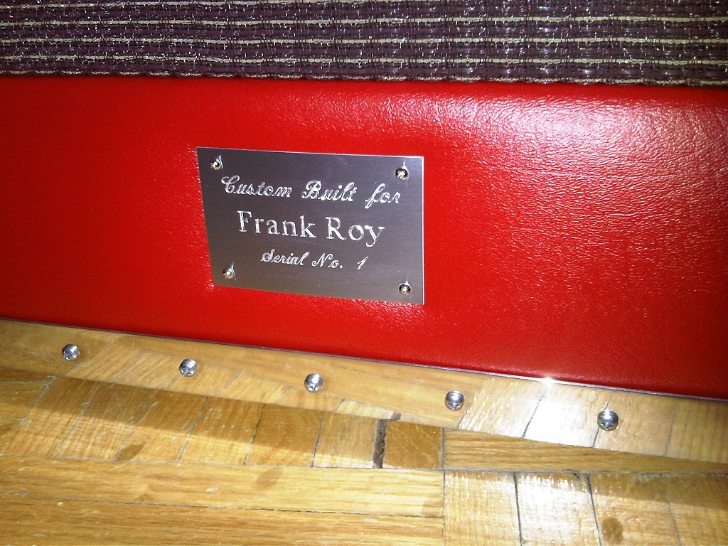

Make sure you're sitting down.... this is one of the nicest amps I've ever seen in my life. I commissioned a good friend of mine (t h a n k y o u m y f r i e n d !!) for the cab & metalwork, and the results are spectacular. I installed my 1954 JBL D-130 speaker the night the cab arrived. Now for the electronics!
