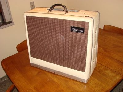

Hi there again,
Nice cabinet you put your amp in! Where did you get it made, or did you do it yourself? Are you going to make a plexi logo badge for it?

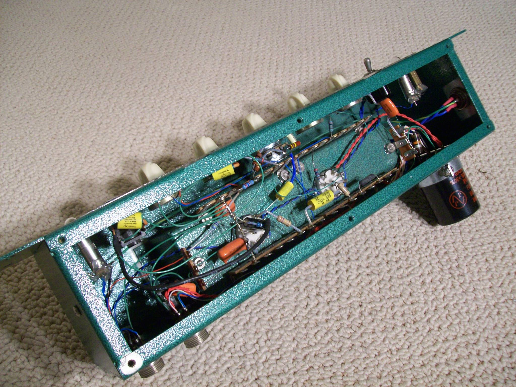

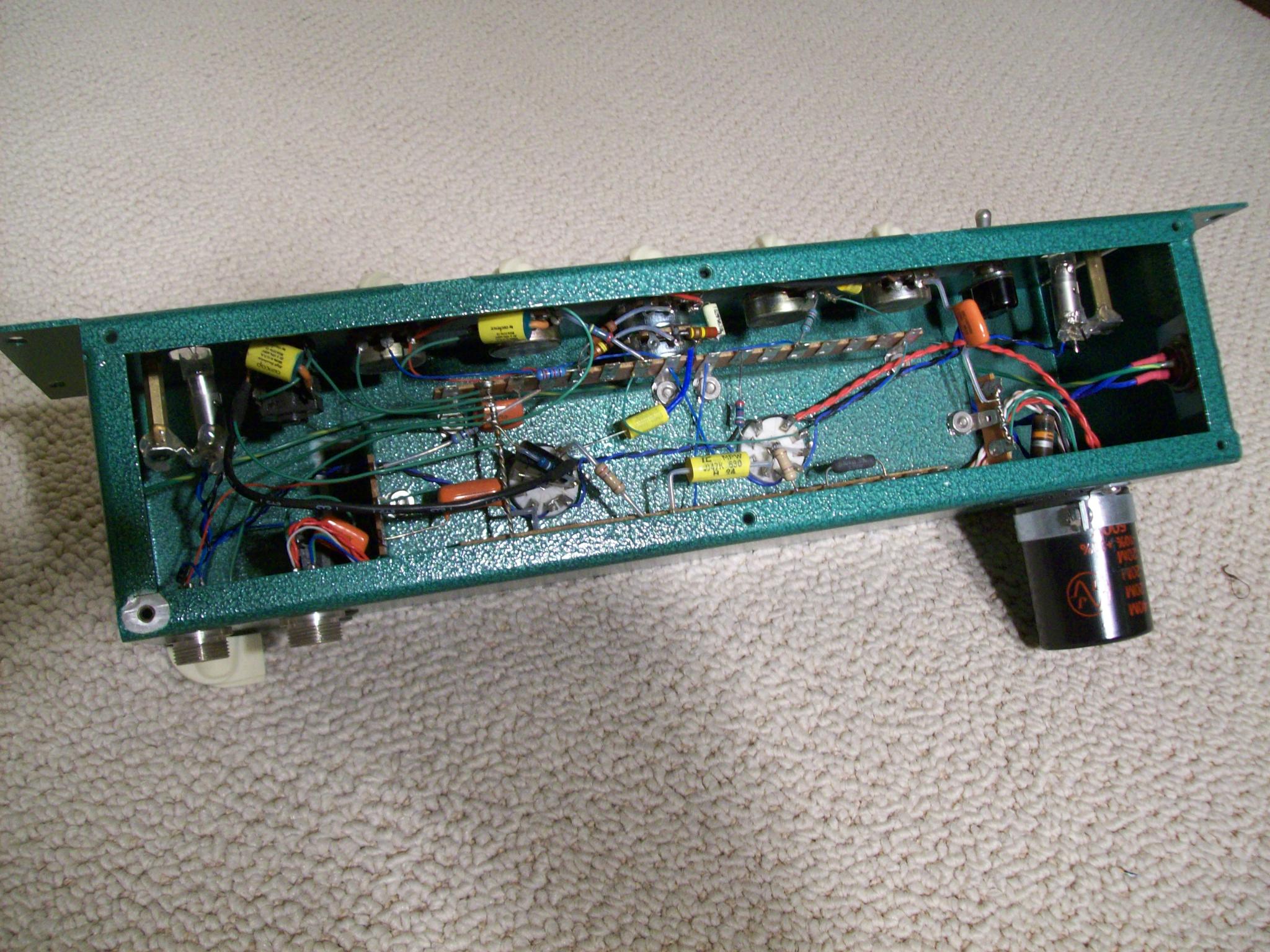

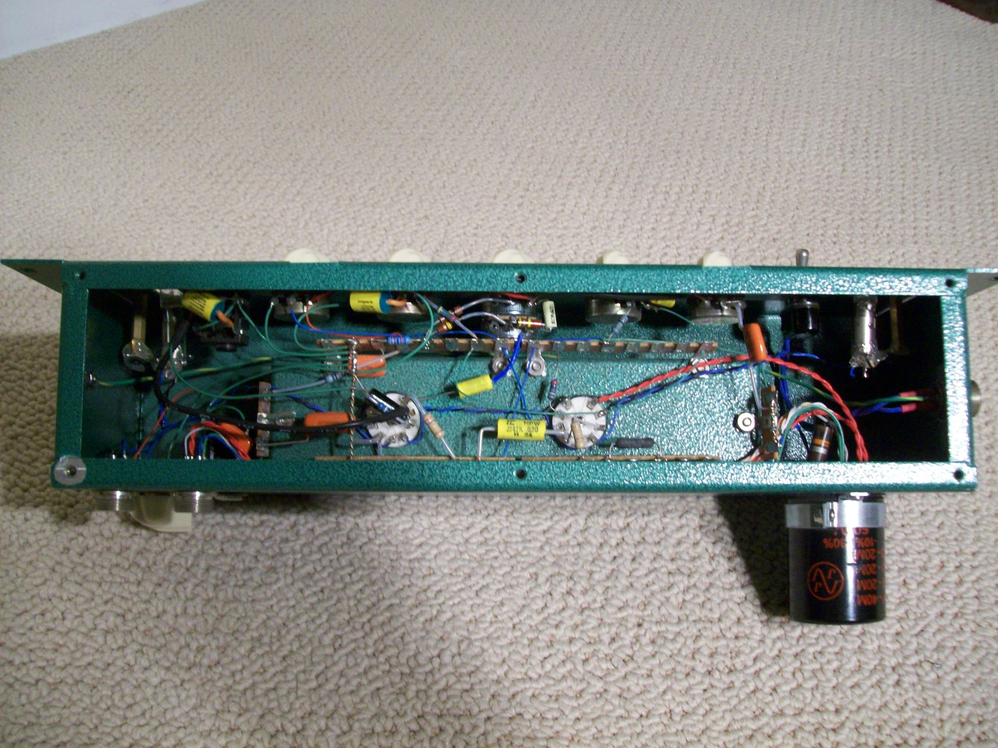

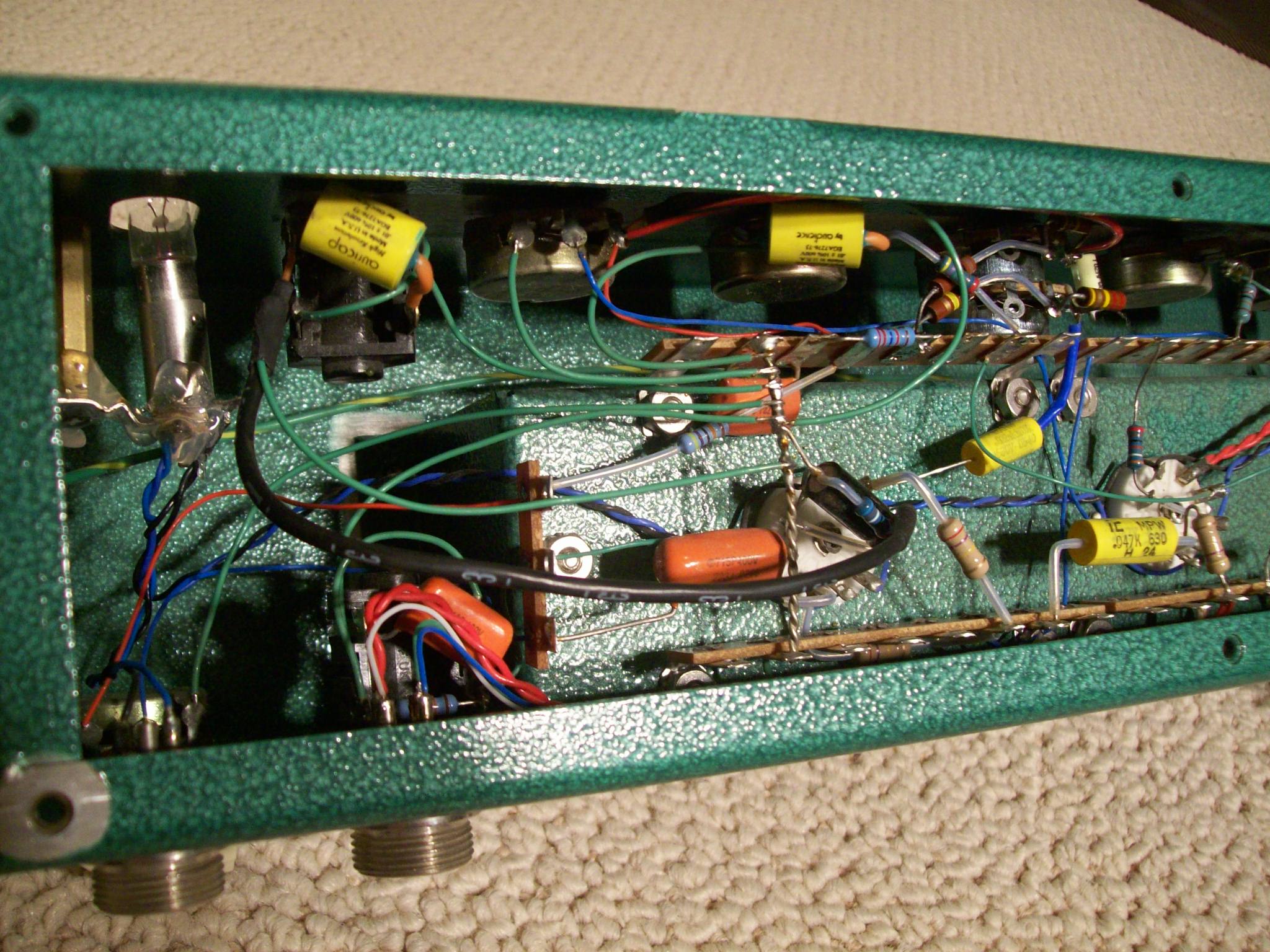

How's the sound? Looks great - can you send me pics of the amp internals? I'm always interested in how others do their wire management.
How old's that D130 you put in there? Looks crisp and clean!

Hey there, thanks alot, i made the cabinet myself all fingerjointed pine. I got a sign shop to make me my instrument panel and front logo. sound is great, for guitar i mostly use it with my hallmark deke dickerson model, gets a good joe maphis and merle travis sound. Found for steel it really gets a early steel guitar tone, like old western swing records. im not too sure how to find the age of the d130, bought it used, had to have it the condition is great. ill send ya some pics mabye tommorow. but for wiring i just usually give me some room for future changes, keep everything away from ac lines, tightly twisted heaters ran high away from everything, and my attempt at star grounding. plus lots of cotton covered wire, just because i like how it looks.
