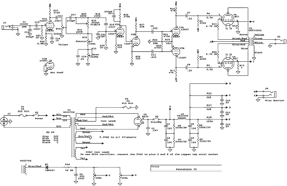

kaw-liga,
When I built my 25L15 clone I used a pair of 5W 350 Ohm resistors in parallel to get 175 Ohms at 10 Watts.
Since the amp only puts out about 25 watts the Hammond 1650H rated at 40 watts would do fine. I just happened to have an old Scott hi-fi output transformer from a 35 watt amp that had the proper input impedance of 6600 Ohms.
I built my amp using 1/2 Watt carbon film resistors as I do in all the amps I build and have not had any problems. All of the capacitors are Mallory "Orange Drop" style.
As I stated earlier in one of the postings the JBL D130 speaker is the heart of the Standel 25L15. Without that speaker you can not really ever achieve the 25L15 sound, in my opinion.

Standel 25L15 schematic
Hello everyone!
Lotsa talk all over the 'Net about Standels and Echosonics!!! NICE!
I guess if someone else can post a schematic of this amp, so can I, right?
Here's one that I'm sure people will recognize. It's freely available online. Just find a link to a schematic called "807_schem.jpg" and change the link to "jp25_schem.jpg" and you can download it. This link is found on many threads I've seen on Standel schematic serches.
PS I REALLY REALLY want a Ray Butts EA-1 Echosonic, AKA 1958-196x Rickenbacker M-30 Ek-O-Sound. PUHLEEZE someone contact me if you have a manual, instructions for any parts of these amps, anything at all. I need one of these, guys..........Please.
Thank you kindly!
Frank

The JP25 is Ted Weber's rendition of the Standel 25L15, and doesn't seem to be available yet, even though he publishes the schematic freely. Caution, however - although tube complement is the same, the schematic differ significantly from the original, and I don't know if the layout is similar since it's not published. Not having heard a JP25, I don't know how the sound compares to an original - which I played through briefly when I worked on one - but I understand that you can get similar output from different circuits, so perhaps it would serve as a suitable substitute if you aren't concerned about circuit accuracy. The photo of his cabinet seems to replicate the original, what you can see of it, and the price is very reasonable - I plan to order and build one as soon as they're available!

Standel 25L15 Shematic
Hi K9!
And thanks for your post - I completely agree with you on all counts (except for the price of Weber's Standel cabinet - I don't know what the cost is yet, so I can't say yay or nay, but it SURE LOOKS GOOD.)
It is very likely that his JP25 circuit differs from the original Standel 25L15 circuit, but as you say, there is no real way to tell since we don't have a schematic published online anywhere.
HOWEVER, I was able to find a few copies of 😛art: of the schematic, some with the power section ripped off for some reason. They are dated 1953, and Bob Crooks's name is on it, and they look very old.
When I get home tonite, I will compare the Weber JP25 to the schematics I already have, despite partially incomplete. I will note the differences, if any, and see what kind of effects they may have on the amp itself.
One thing's for sure: Weber's JP25 looks like a reliable, fully functional 807-based circuit, not unlike the Williamson circuit, and both look very very much like a Standel 25L15.
Let's see what our grey matter can come up with. if ANYONE OUT THERE has any resistor values, capacitor values, even output transformer information, bias setting, or any specs of original early-50's Standel 25L15's, please post them so that we may compare to what we have here.
thank you in advance for any and all contributors and followers, and again, hats off to Guitar88, MBL and Lorenz S.
Frank
Hi K9!
Frank

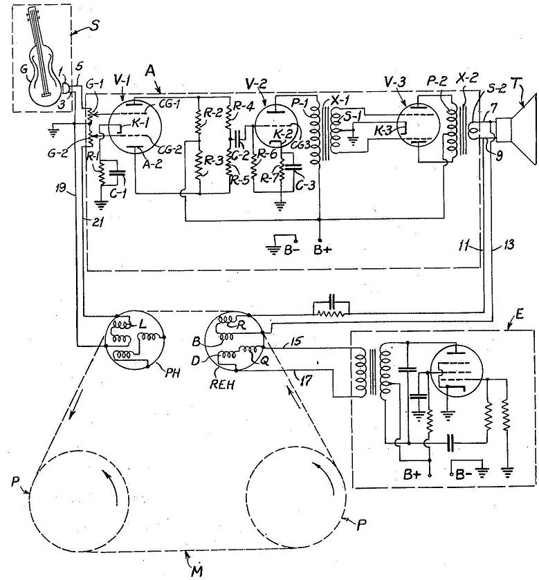

Re: Standels and EchoSonics
You might be interested on US patent #2,804,499.
TelecasterTech said:Ray Butts Echosonic

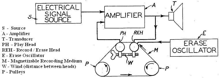

ECHOSONIC SCHEMATIC AND INSTRUCTIONS
Hey all!!
I'm back - and this time I have some goodies for everyone from my latest online treks in the Quest For Tone.
MANY THANKS TO MY NEW FRIEND FROM FINLAND Teemuk FOR HELPING US OUT ON THIS ONE!!
The famous April 1953 Ray Butts Echosonic model EA-1 amplifier. I have a small diagram of it, a basic schematic with (unfortunately) no values (CAN ANYONE FILL THEM IN AND POST THEM PUHLEEZZ!).
I also have 3 pages of details instructions on how the tape echo functions as part of the amplifier - a very good read. I hae never seen these posted anywhere in online forums before until now!!
Let's all get some information together and maybe we can have a working schematic for all of us to enjoy.
Thank you,
Frank

ECHOSONIC INSTRUCTIONS 1
I had to convert the Patent PDF to JPG or MS Word document to post but everything is just too big to fit in the measily 102Kb limit of this forum.
Please find the document in its entirety here:
http://www.freepatentsonline.com/2804499.html
NB: You WILL have to quickly create a free login account with a valid email address to download this PDF (sorry for the hassle, guys...).
Thank you,
Frank
Thank you,
Frank

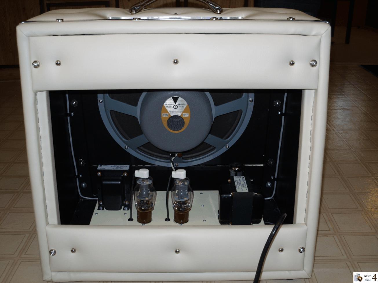

Done my amp..well almost
Here is a few pics of my amp, i got the front logo i still want to make, but it is done otherwise. i used the schematic that guitar88 provided. I like the standel appearance and decided to go with it. it sounds great with guitar and steel.
