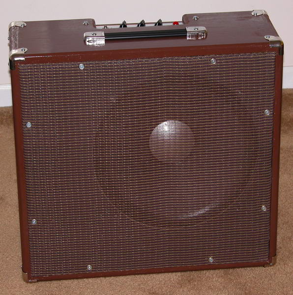

Make sure you're sitting down.... this is one of the nicest amps I've ever seen in my life. I commissioned a good friend of mine (t h a n k y o u m y f r i e n d !!) for the cab & metalwork, and the results are spectacular. I installed my 1954 JBL D-130 speaker the night the cab arrived. Now for the electronics!
Wow! Very nice work!
I recently checked all hardware stores around for that aluminium strip (for carpets?) the same as on your amp, but could not find anymore... New DIY fashion? 😉

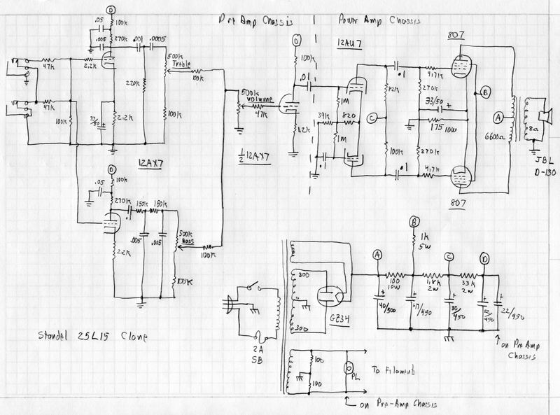

I don't have this fetish, but I can say this schematic is quite possibly the most well designed guitar amp. Two chokes in the PSU? Everybody else is using one, even if that. And other niceties as well. Seems the guy was a perfectionist.
By the way telecastertech, the voltage does not divide itself that way. It is fed parallel to the screens, So they each get the full voltage. 100 or 470 Ohms will not have a great effect on the voltage but it will have effect on the tone, when driven hard.
That cab is superb! Well done telecastertech, you sure have the tenacity needed to take this through to completion. I take my hat off to you, sir!
I'm thinking maybe I'd better add my name to the list of guys who want one of yours.

You guys out there building the 25L15 clone's, do any of you have a detailed schematic of the unit? I would love to build one. Best to All, Gary
Wavebourn: The flat aluminum trim is 3/4" seam binder and is available from Lowe's and several hardward stores, but may not be stocked (it's not, around here). I've had it "special ordered" from a couple different places, and there are two brands available (that I've found so far) - M&D, and Frost King. The M&D part number is Seam Binder #78121, I don't have the FK's handy. The M&D is better, IMO, as it's holes are drilled with better centering (the FK's had some holes noticeably off-center, so I only used it once - before learning I could special-order the M&D.)
Both are reasonably close copies of the original trim - which I finally located the source, btw, to be an old defunct company that went out of business several years ago. Major difference is that the grooves are not as deep as the original, whose semi-circular grooves were deep enough to form sharp ridges between them. The modern equivalents have shallower grooves with small flats between them.
Gary: the majority of folks who have detailed 25L15 schematics are bound by non-disclosure agreements that prevent further distribution. But even with a schematic, unless you have an original to copy from (in which case I guess you wouldn't need a schematic, would you?) it'd be nearly impossible to construct an actual clone from it. A schematic describes how to wire up the parts, but doesn't tell you where to put them, or include things like cabinet dimensions, chassis layouts, parts lists, or other construction details. I can tell you the current cost to build one is just under $2k, parts & labor, to build one... but if you're serious, PM me...

I have just finished building this circuit using 6L6 . Amazing Standel tone, additions to the T filter maks the amp very versatile and will take care of the many minor variances of the amp. All the controls behaves exactly as per modern version of this amp

Hello all, i know im many years behind on this post, but a man has to have a hobby! Only thing im really stuck on is power supply and chokes, eg 1h seems a bit small? also the bias resistors, mainly is it 4.7k or 47k on grid1? Regards Richard
