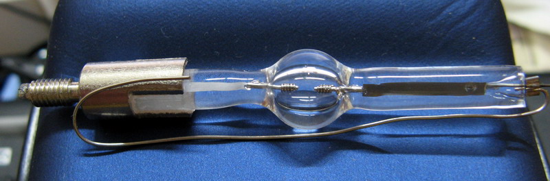

Ywh, I need a power supply that will run a 250w lamp , 120 primary and a bipin 250w lamp. I have modified my reflector to accept a larger diameter lamp with outer jacket. Like this, but using the reflector from the Toshiba TDP T-1

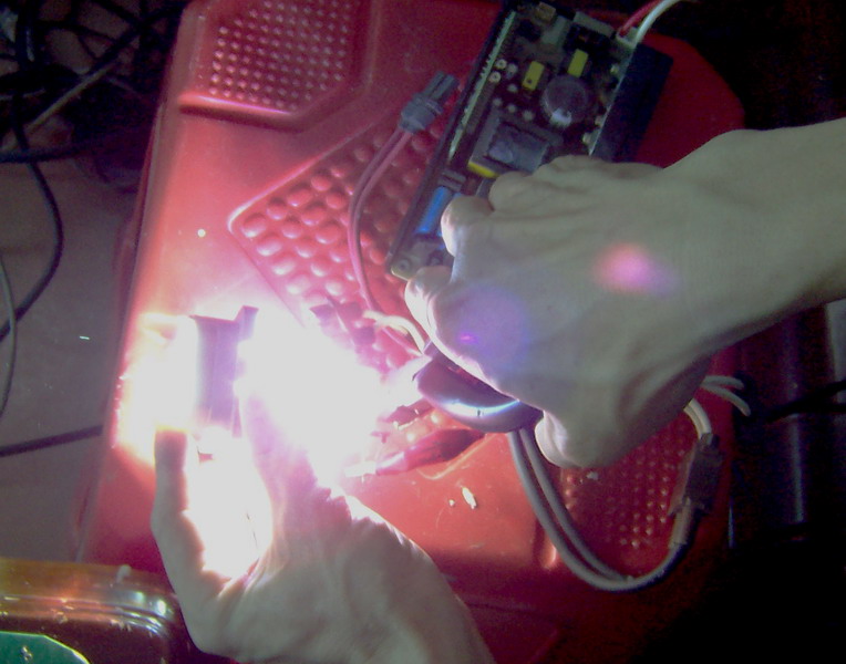

Finally I managed to focus my lamp maybe at 99% and the picture is GREAT! I had to do a little trick though because everything else failed for me. I removed a small piece of metal with a hole that was attached to the projector right in front of the lamp housing.
I placed that metal piece in front of the lamp and put the whole thing close to a bathroom tile facing the back (brown side) so that the reflection is not damaging my eyes (I also wore 2 pairs of dark sunglasses 😛).
Then I focused the lamp to the brightest setting (all the focused light escaped the hole and hit the tile) while I had the cement in place.
The cement set in moments and voila!

ywh said:I do it in my hand only 😀
Unbelievable!!!! 😀 😀 If I do it like this even one small move takes the light out of focus...
wait, I'm confused. You're focusing the light while it's on? Doesn't the bulb get extremely hot?
